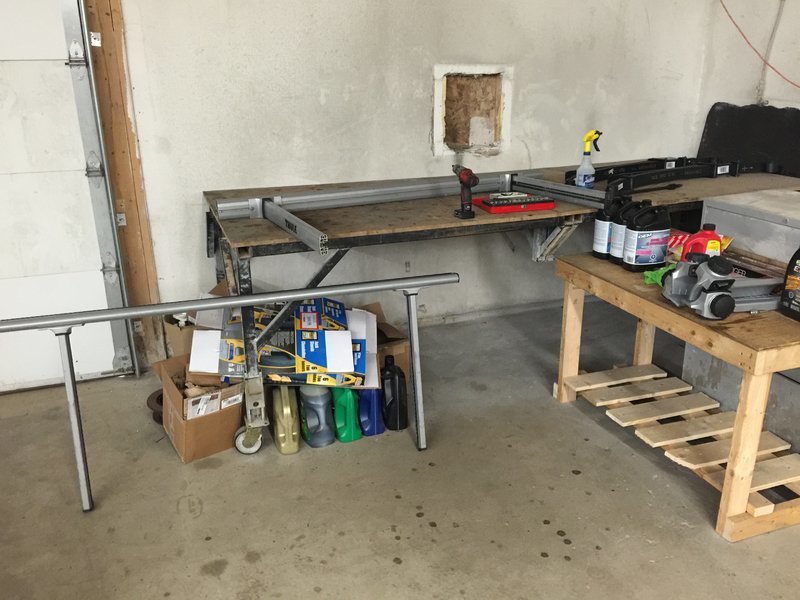

    The Taco has it's spot in the shop and is up on stands and ready to be improved.

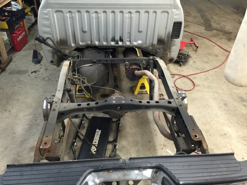

  8. Aug 12, 2016 at 2:06 PM
    #628
    EB Group
    EB Group [OP] Carbon Jedi
    Jul 14, 2015
    #159469
    1,406
    Rudy
    Halifax
    2017 TRD Sport DCSB 6M

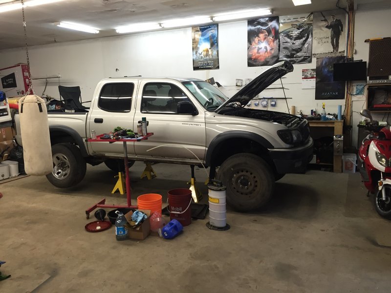

    Bed is off.
  9. Aug 12, 2016 at 2:10 PM
    #629
    EB Group
    Jul 14, 2015
    #159469
    1,406
    Rudy
    Halifax

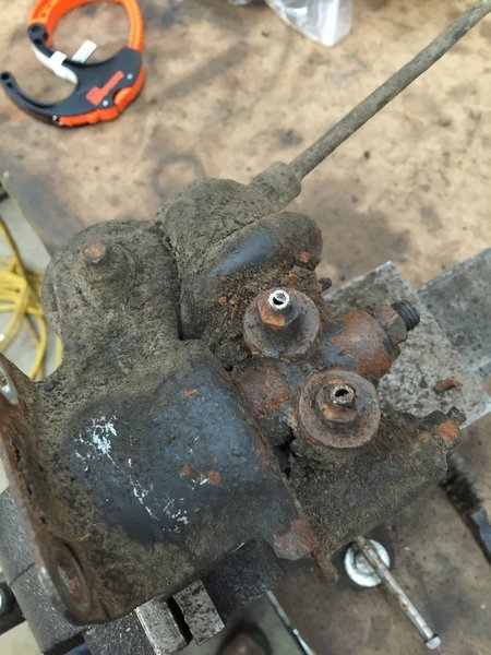

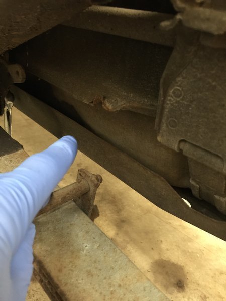

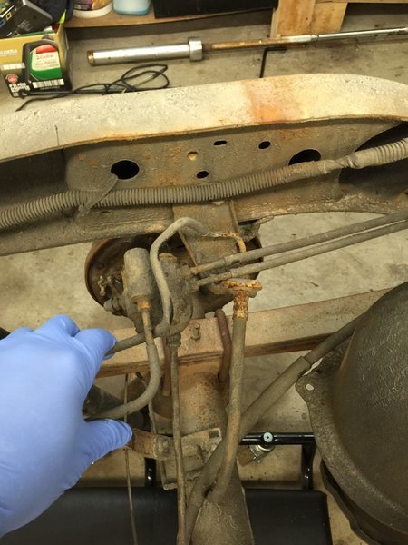

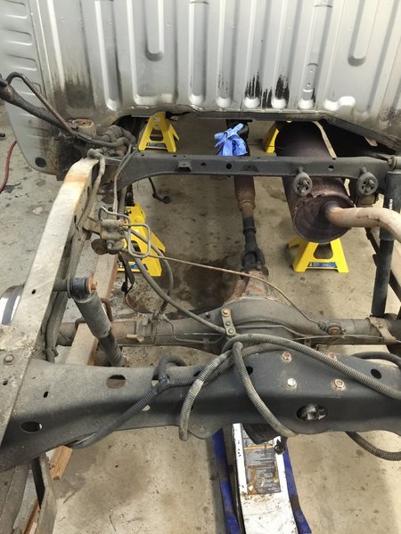

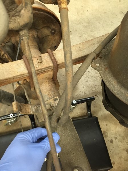

    - The rear brake biasing thingy has no bracket to base it changes on. I have the one off of the parts truck to put on.
    - Not sure why the ebrake cable is making contact with that flexible brake line.
    - I think I recall reading a comment from BoxRocket stating the leaf spring bolt contacting the gas tank. That is the case with my truck.

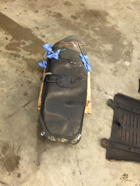

  10. Aug 12, 2016 at 2:13 PM
    #630
    EB Group
    Jul 14, 2015
    #159469
    1,406
    Rudy
    Halifax

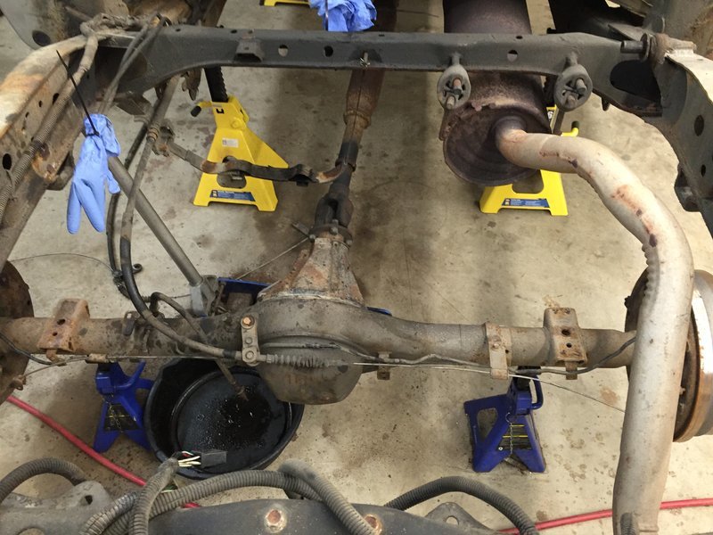

    Fuel Tank Removed.
    The source of the leak is not aparent to me.
    Fuel does collect on the ground.
    It's all over the inside of the tank skid plate.
    It's all over the bottom of the fuel tank.
    The wet begins were the seam is for the top and bottom of the tank.
    TheSaint likes this.

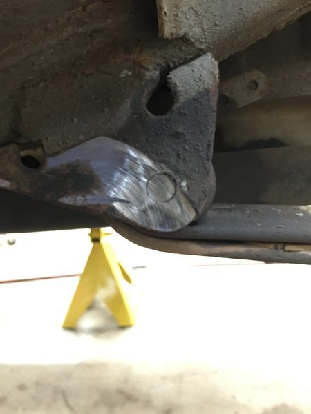

  11. Aug 12, 2016 at 2:15 PM
    #631
    EB Group
    Jul 14, 2015
    #159469
    1,406
    Rudy
    Halifax
    Passenger side front leaf bolt is loose and does not seem to be seized. I had it out last fall.
    The drivers side however is seized and had to be cut. Did the outside, working on the inside now. Nice to have the fuel tank out of the way.

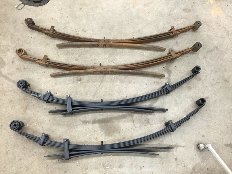

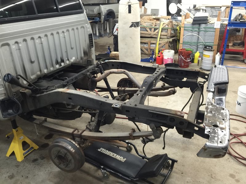

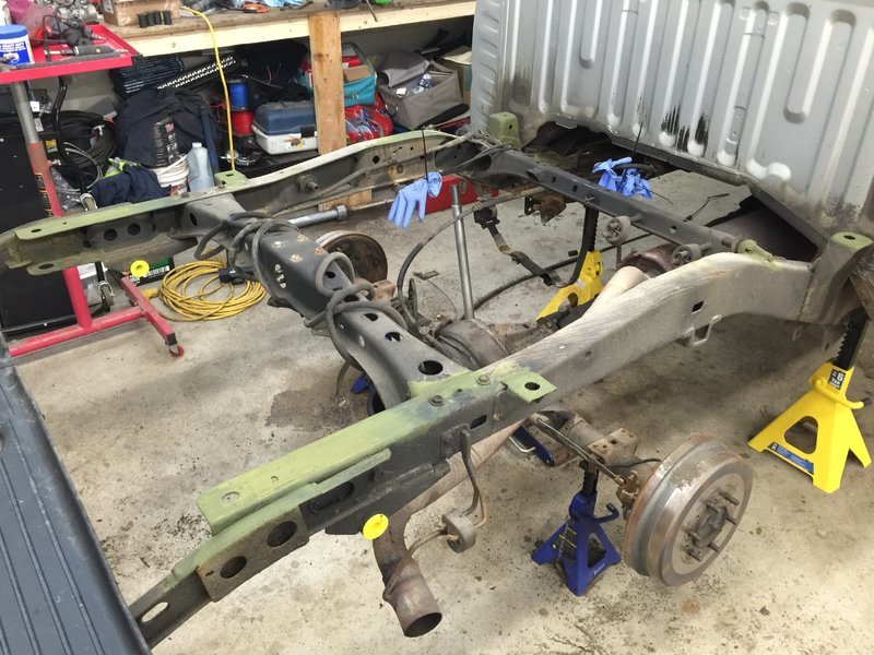

  12. Aug 12, 2016 at 3:37 PM
    #632
    EB Group
    Jul 14, 2015
    #159469
    1,406
    Rudy
    Halifax

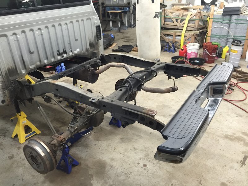

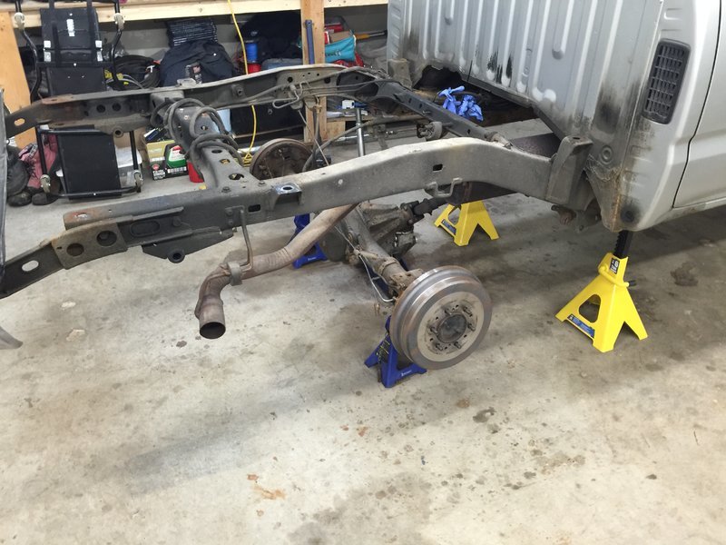

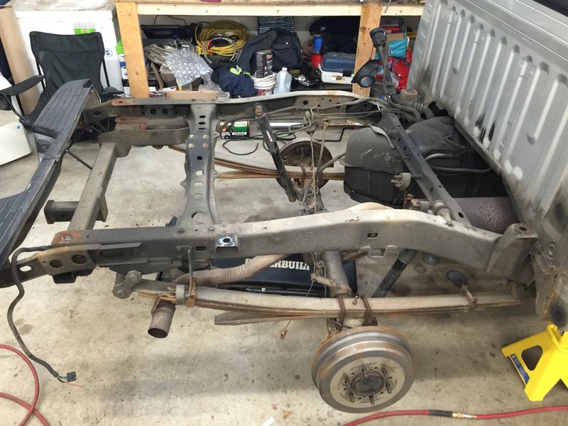

    Old leaf springs and shocks out!
    Thats it for today folks.
    :headbang:
    Nice note to anyone doing this.
    Put you front jack stands under the engine if possible. Mine are not and the front of my truck started tipping forward when I removed the leafs as there was very little weight in the rear of the truck.
    :eek:
    quetzal likes this.

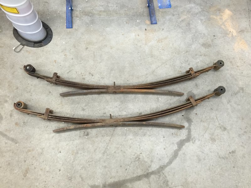

  13. Aug 13, 2016 at 7:00 AM
    #633
    EB Group
    Jul 14, 2015
    #159469
    1,406
    Rudy
    Halifax
    Old and new leaf springs
    CaptAmerica likes this.

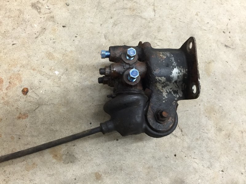

  14. Aug 13, 2016 at 7:01 AM
    #634
    EB Group
    Jul 14, 2015
    #159469
    1,406
    Rudy
    Halifax
    Cleaning up the replacement rear brake bias thingy. I'm going to keep calling that until some corrects me.

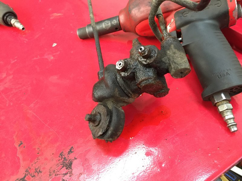

  16. Aug 13, 2016 at 7:54 AM
    #636
    EB Group
    Jul 14, 2015
    #159469
    1,406
    Rudy
    Halifax
    Cleaned up a bit and new fittings in place with silicone in the holes to keep crap out.
    And next is a pic of the old one removed. Pretty poopy, mounting bracket completely missing. No wonder my rear brakes are doing nothing. Unless my understanding of this component is incorrect.

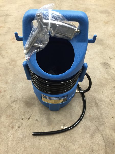

    I picked up this portable little abrasive blaster to clean up the rust spots on the body of the truck. I think I'll use it to clean up some spots on the frame and other parts that I can't get in the blasting cabinet.

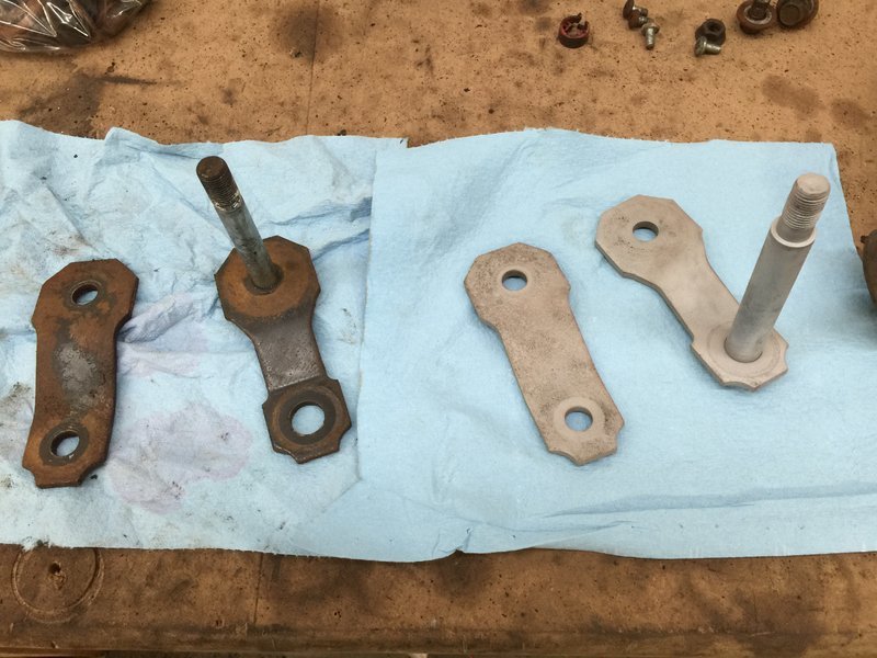

  20. Aug 13, 2016 at 9:49 AM
    #640
    EB Group
    Jul 14, 2015
    #159469
    1,406
    Rudy
    Halifax
    Gave that primer a try. Put a couple of coats on spots I cleaned up.
    You can also see the OME yellow frame bushings I put in.
    I'm blasting the shackles to clean them up.
    A picture of one after a cleaning with a wire brush and one after blasting.
