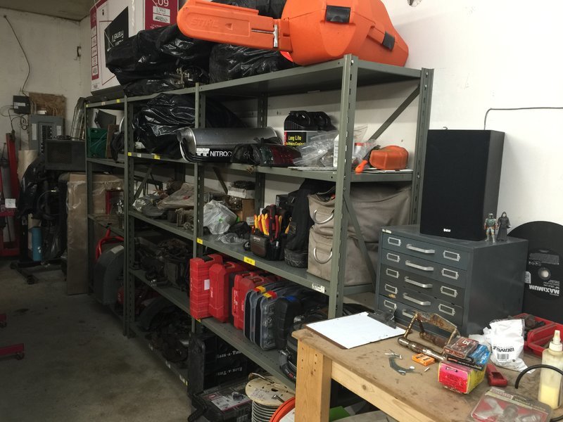

    Here is some of the organizing I got done.
    The middle shelf is pretty well populated with what remains of the parts truck.

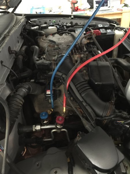

    I also got the AC belt on the truck and verified that the fuse doesn't blow every time I press the ac button. The previous compressor was seized.

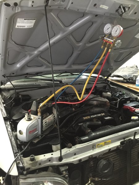

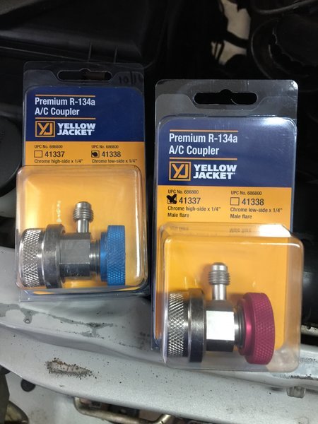

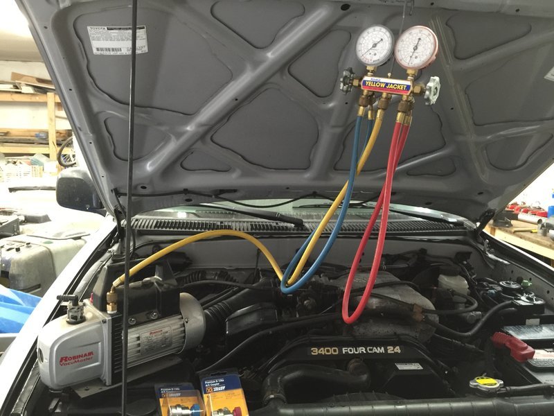

    Got the high side ac fitting today.
    I'm currently putting a vacuum on the system to pull out any mousture that may have collected in there.
    After I will close the valves and let it sit for 30. The gauges should remain where they were. If not, there is a leak of some sort in the system.

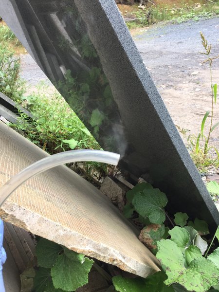

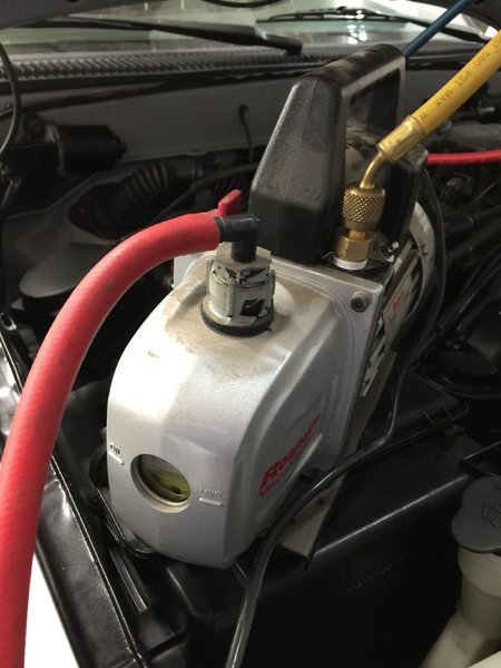

    A few pictures of the setup.
    The vacuum is being vented outside because of the vapour fumes. Vapour fumes were present last time I used it to make carbon fiber parts. My research tells me this can be normal so I won't worry.

    At rest the guages both sit at zero.
    With vacuum they are reading what they should, low side at -30 inches of vacuum and the high side needle should be pegged.

    The vacuum test proved sucessful, so no leaks in the system.
    I'm trying to find some NB8 or PEG 46 ac compressor oil to add to the system while charging. I checked at the refrigeration distributor where I purchased the adaptors and they had none. Crappy tire did not have any either.
    I'll make a list of places to call tomorrow and see if I can source some without having to order some online.
