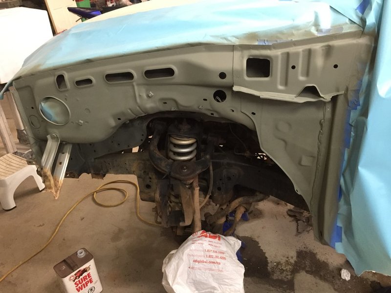

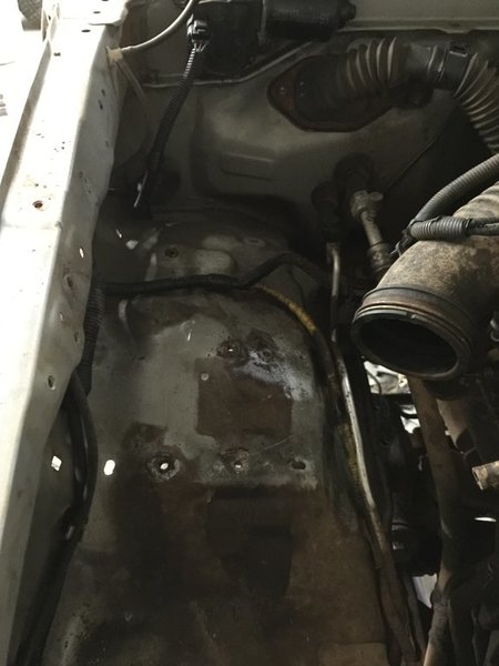

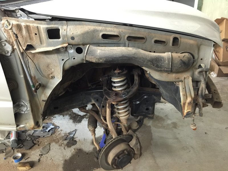

    Started to clean the drivers side under fender and forgot to take a before picture.
    The first pic is a during picture and the second is after cleaning it with spray9

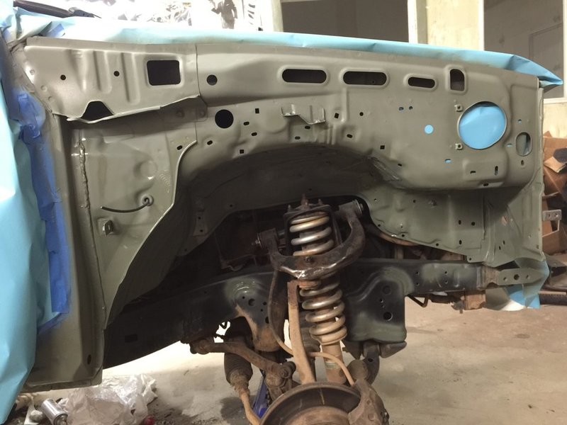

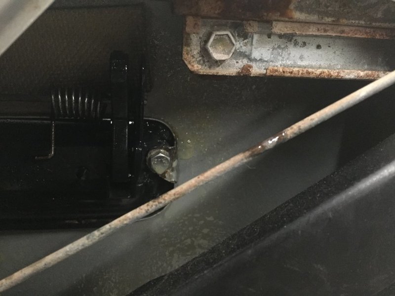

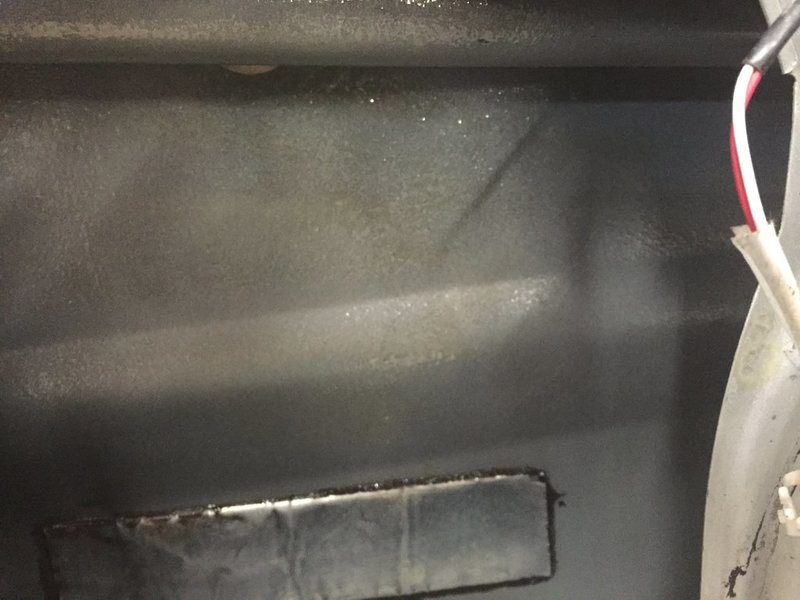

    After rust is removed, wiped down with Sure Wipe pre-paint prep and primered with the same self etching primer I used on the floor of the cab.
    Then after two coats of bed liner in the wheel well and behind the fender.

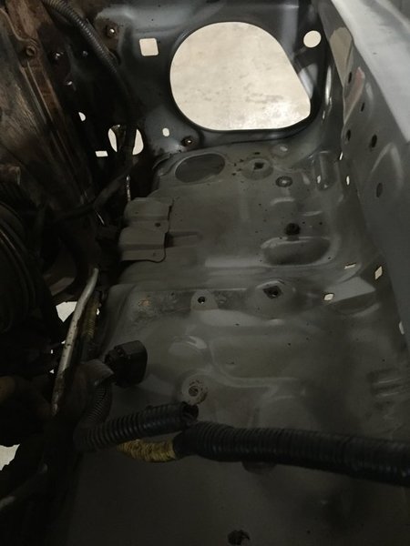

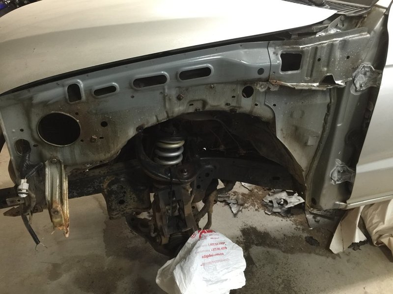

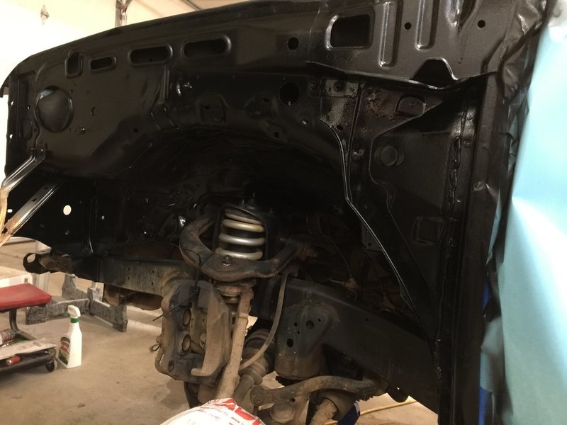

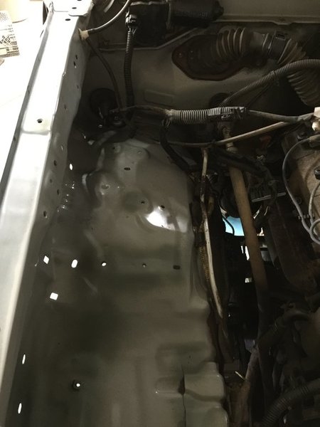

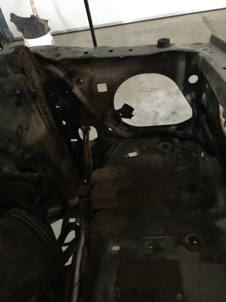

    Passengers side Engine Bay stripped of components and ready for cleaning and touchup
    Then cleaned and ready for rust removal and primer
    And finally finished and ready for reassembly

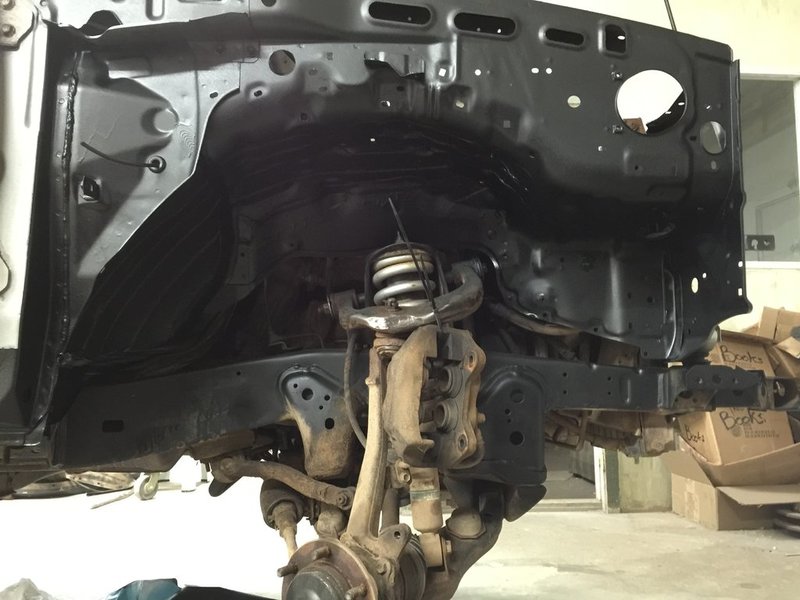

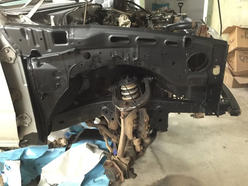

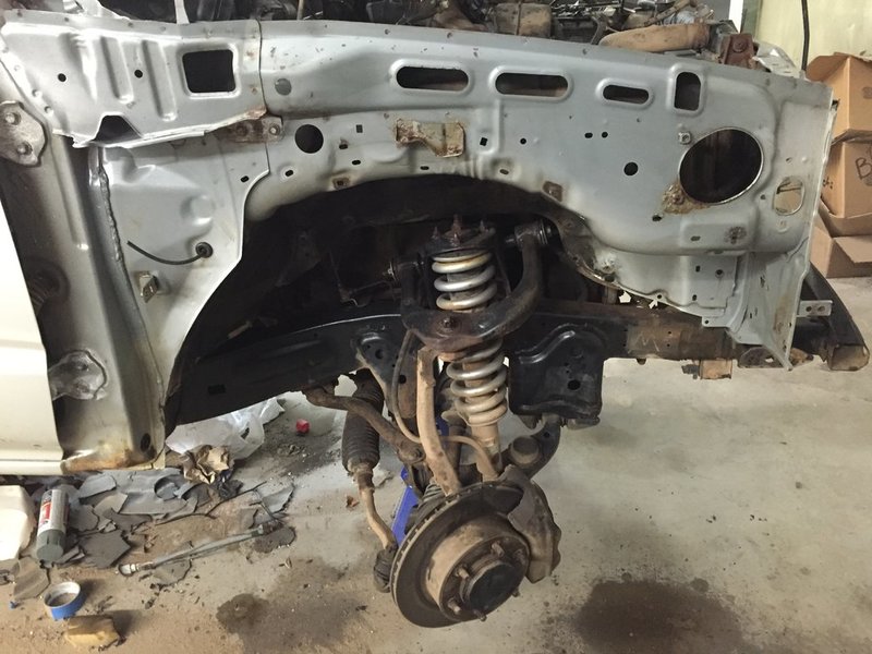

    Passengers side under fender before, well, everything
    Then Cleaned
    Then rust removed and primed
    And finally after 2 coats of spray bedliner

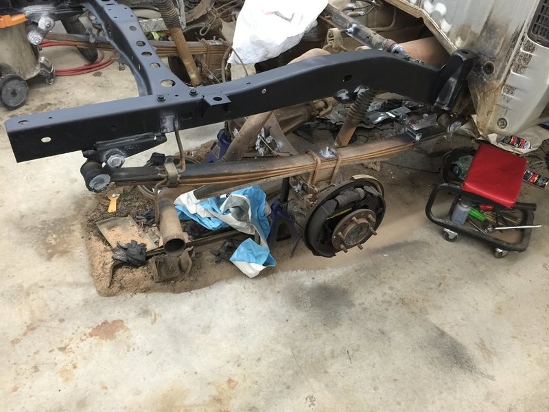

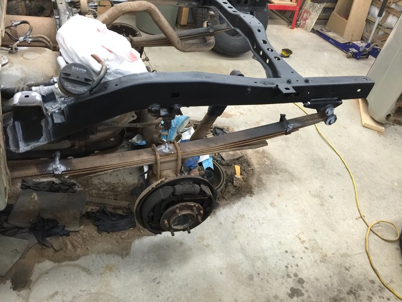

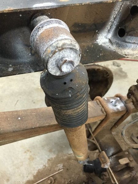

    Front sub bumper and rear frame removed of rust, primed and 2 coats of the usual

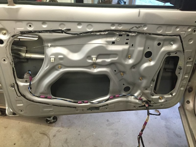

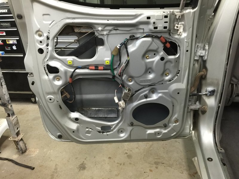

    Drivers side rear door cleaned inside and inside. lol
    After spraying rust check inside the door that door will be ready for reassembly!

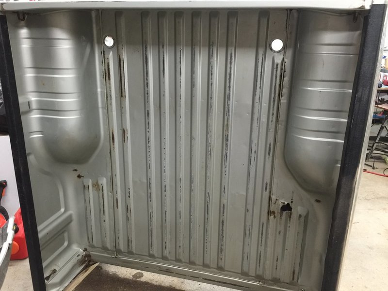

    Did a rough clean of the inside of the bed

    For today my goal is to get the inside of the other 3 doors cleaned, spread the inside of the doors with Rust Check, lube all mechanisms inside the door with appropriate lube and put the rear doors back together.
    Front doors have to wait for the door lock cylinders to arrive. Perhaps tomorrow they will be in.

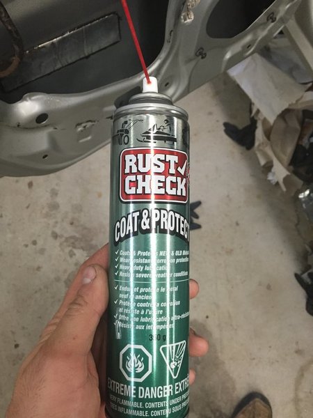

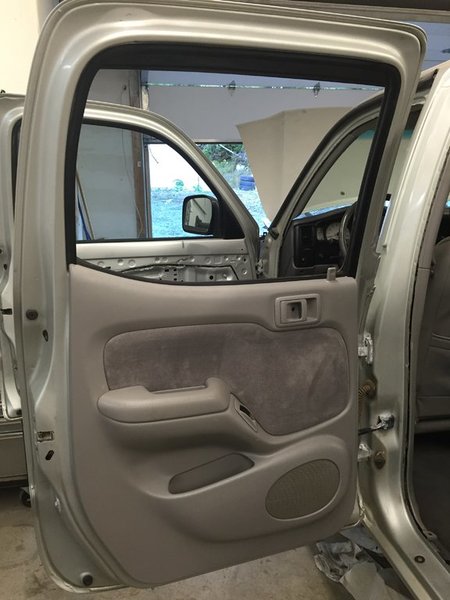

    These pictures are of the inside Drivers Side Rear Door being sprayed with Rust Check to prevent any future corosion.
    Last picture is of the door back together and all good!

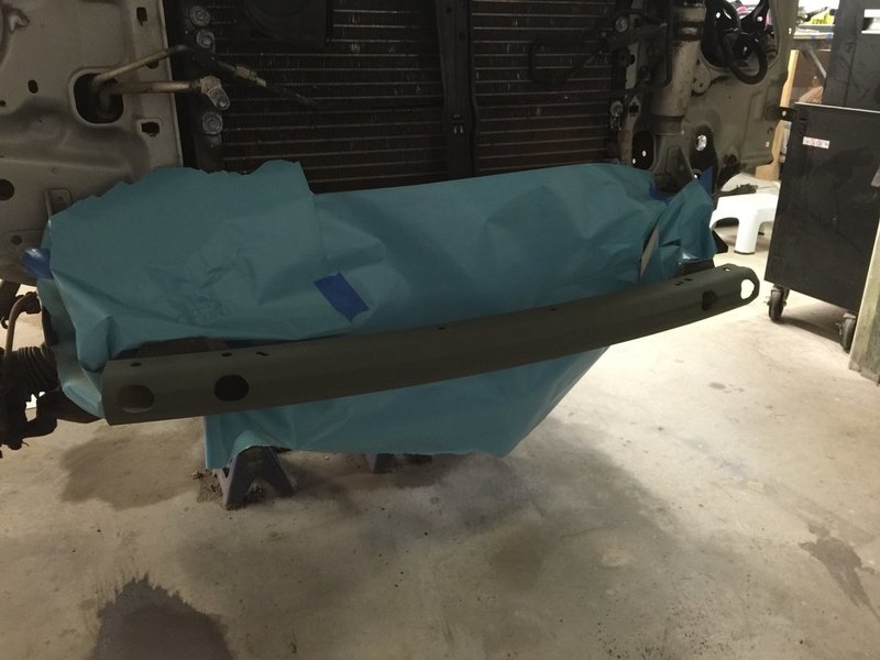

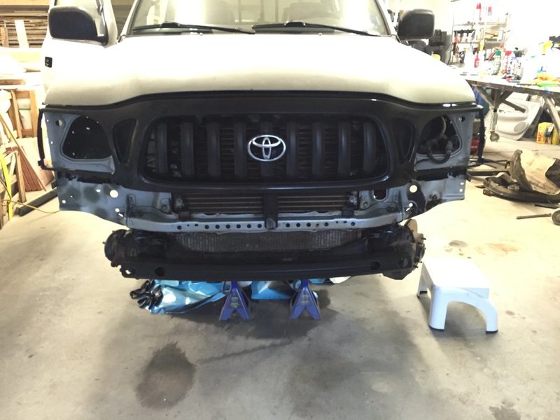

    I put the new grill on temporarily.
    I also put the front bumper back on.

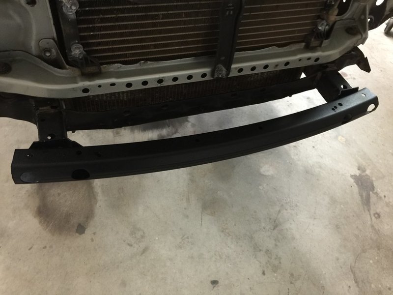

    I didn't do anything to make the bumper better but I can remove it later and clean it up. I am pressed to get the truck up and running asap
