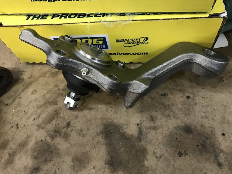

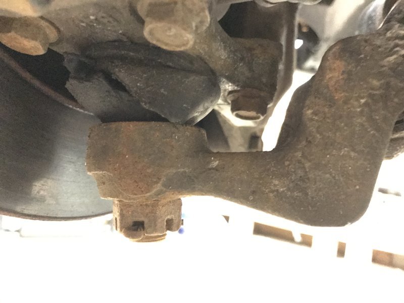

    Doing some Maintenance and Repair today.
    Picked up some MAF Sensor cleaner and cleaned the MAF Sensor.

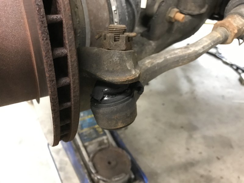

    When I replaced the steering rack with the one off the do or tacoma I noticed that all of the tie rod ends were a bit floppy.

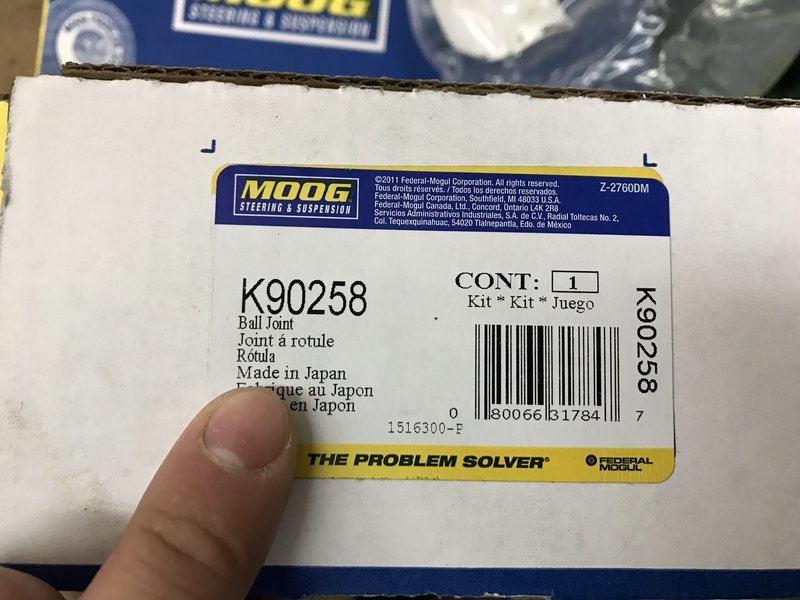

    Since I've been having some random front end vibrations that are coming through the steering wheel while at speed on the highway and at times under braking I figured I would replace the inner and outter tiebrod ends with Moog Problem Solver ones. I also figured I would pick up some new lower ball joints as well for three reasons. 1- I've had to disassemble the front end a few times and I've just pounded them out with a prong instead of using a puller. 2- The ones I had originally installed in there were crappy ChassyPro ones. 3- I'm going to need an alignment after doing the tie rods and I didn't want to replace the lower ball joints after and throw off the alignment for some reason.
    So I ordered some Moog Problem Solver lower ball joints.
    All the parts came in a week or so ago and they look spectacular.
    Made in Japan....Sweet!
    Now, I know all new parts look nice next to old ones but these parts go a bit beyond the regular niceness.

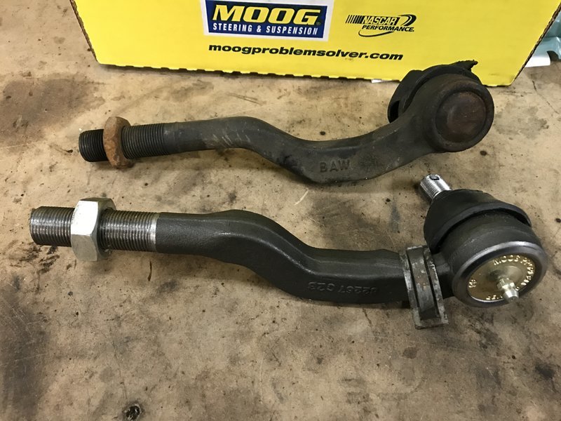

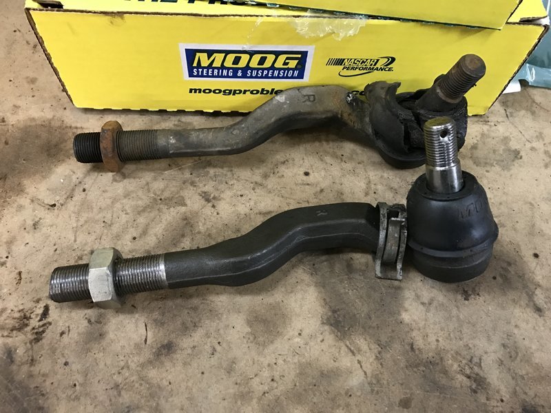

    Moog are ok but they use an inferior design.
    The one on the left is what Moog uses, on the right, OEM. If you get premium Napa (not sure if you have Napa in Canada), it uses the same design as OEM.

    Kool!
    We have NAPA yes.
    Inferior design or not they are better than what I had and it's what I have now. Not really going to change them at this point, they're on the truck. lol

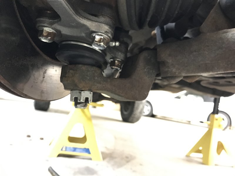

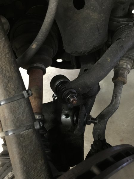

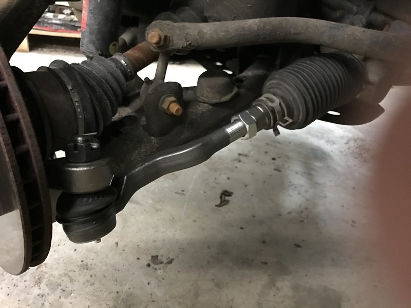

    Some more pics of the work on the taco!

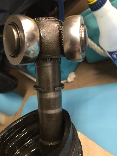

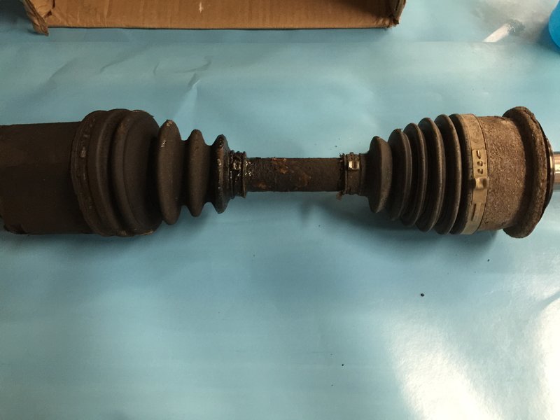

    FYI to everyone, don't bother rebuilding axles, buy new ones.

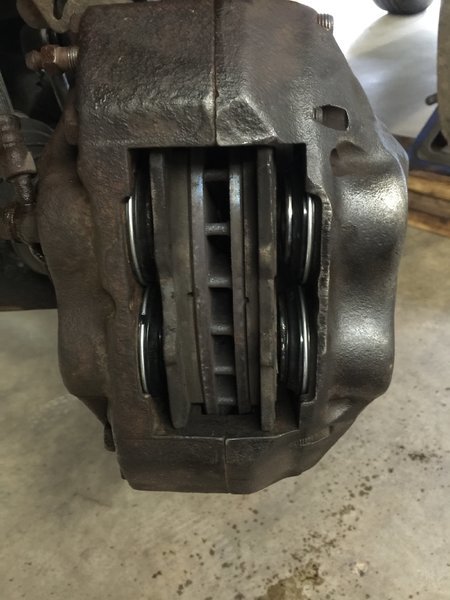

    FYI, I wouldn't rebuild the calliper again. Just buy a rebuild or one from toyota.
    I got an alignment done to the truck today and they told be the drivers calliper (the one I rebuilt) is sticking.
    So, I replaced it, the rotor and the pads today.
