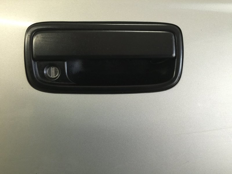

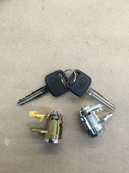

    2017 TRD Sport DCSB 6M

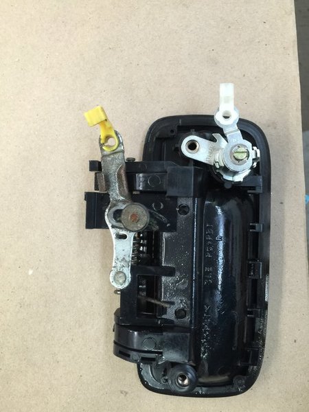

    New passenger key cylinder installed in the handle.
    All done.

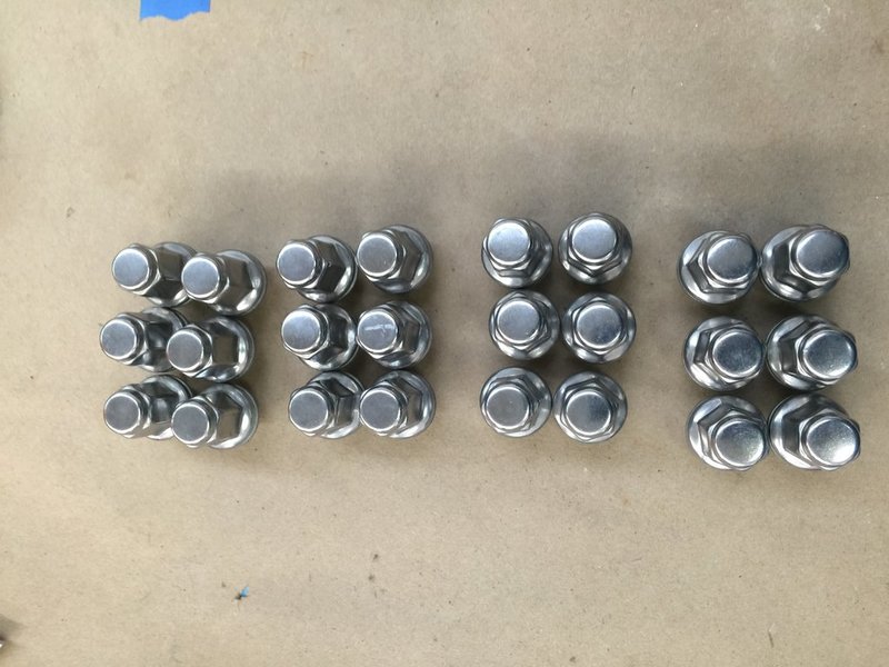

  3. Oct 5, 2015 at 5:05 PM
    #83
    EB Group
    EB Group [OP] Carbon Jedi
    Jul 14, 2015
    #159469
    1,406
    Rudy
    Halifax

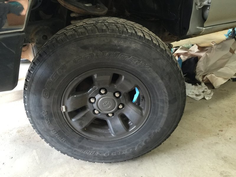

    I had to mount a rim on the truck just to try the new hardware. Worked perfectly

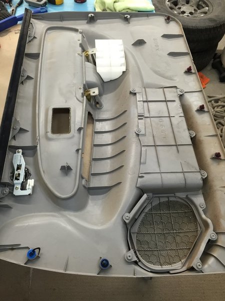

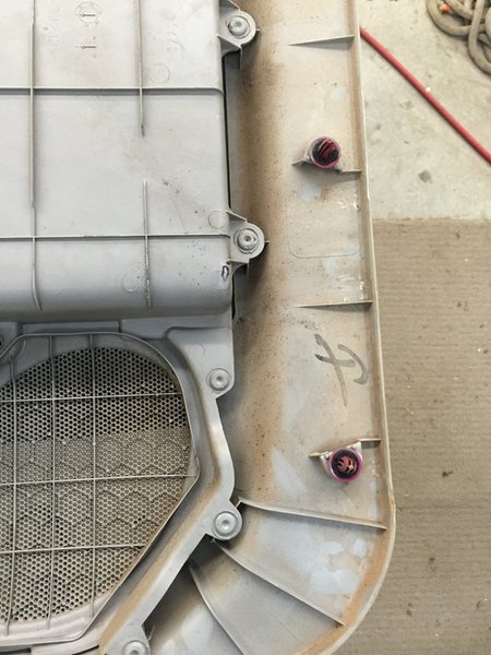

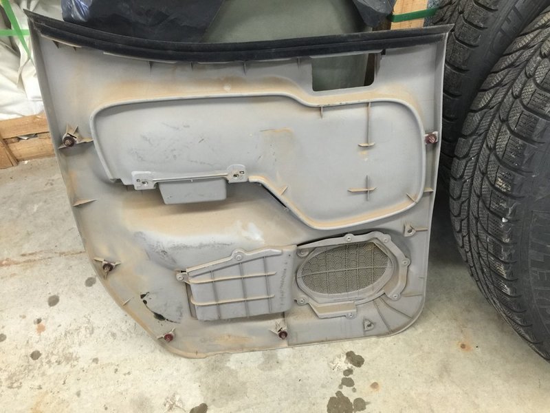

    All the door panels needed to be thoroughly cleaned inside before reinstalling them.
    They were all pretty gross.

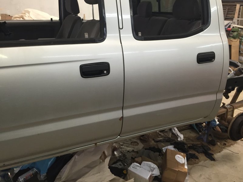

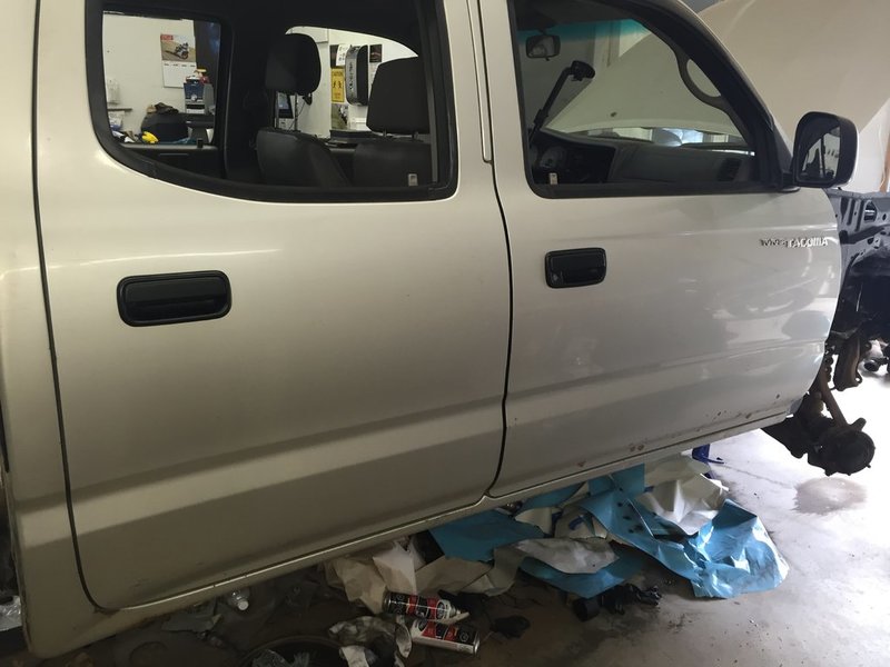

    All door handles installed and doors all back together!

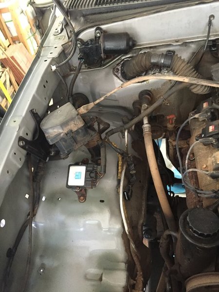

    Got the Cruise Control module and the Igniter installed back in the engine bay.
    Of course, all bolts were reconditioned and antiseized before using them.

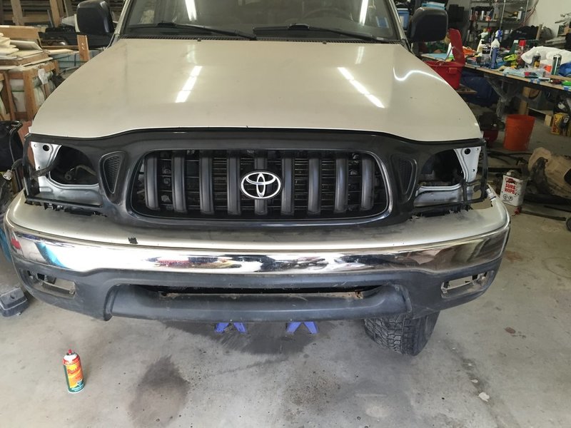

    Reinstalled the front bumper temporarily to see what the front end looks like.
    I have not done anything to the front bumper.
    I will address the bumpers at a later date.

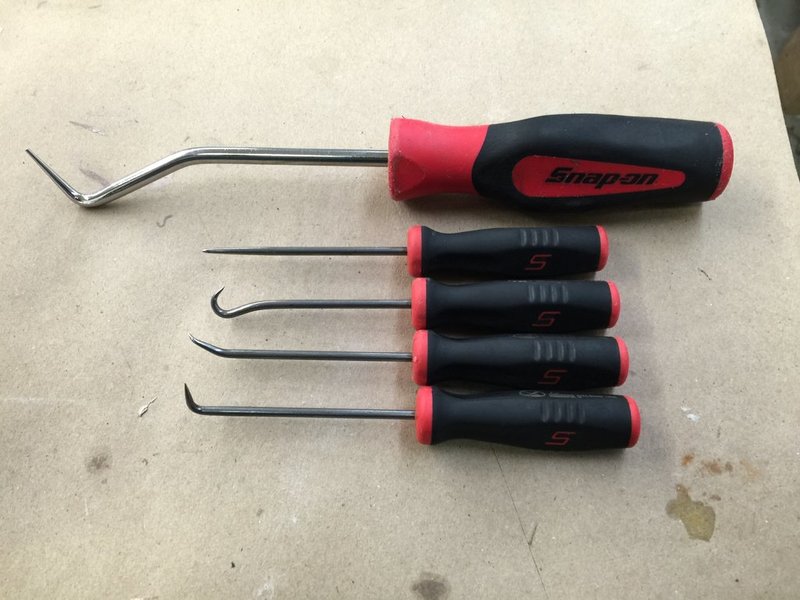

    Met up with my local Snap-On dealer today to get new ends for my pick set.
    It was a good day!
    lol

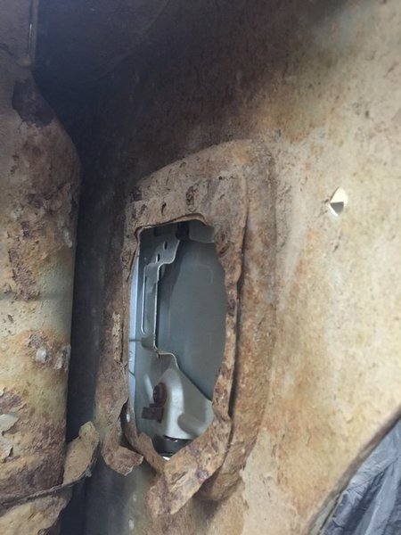

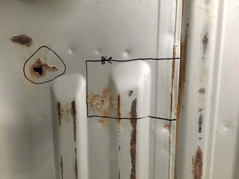

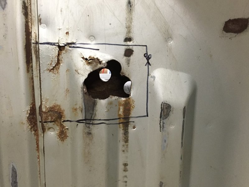

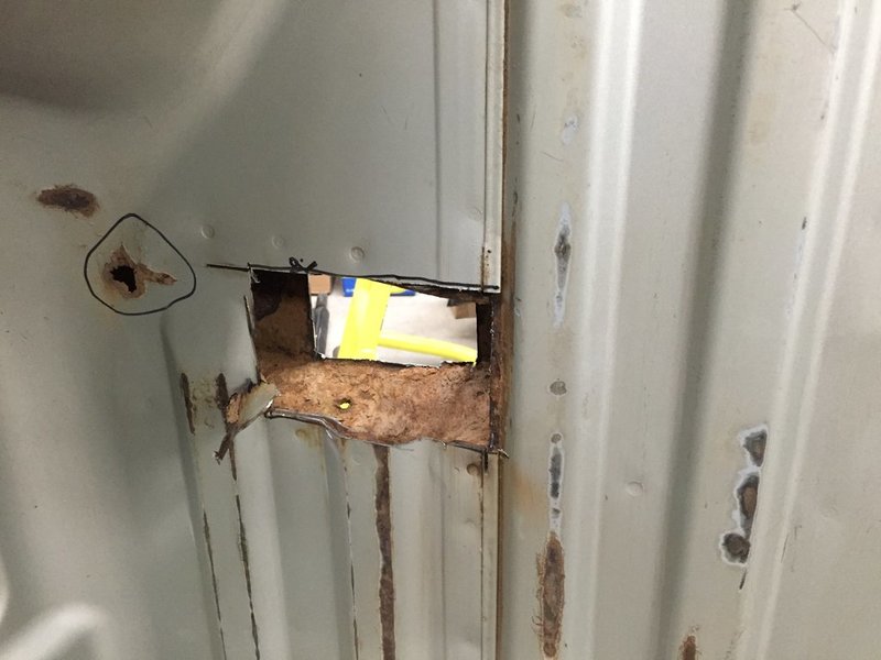

    Time to focus on cutting, fitting, welding and finishing seriously rusted areas.
  10. Oct 5, 2015 at 5:54 PM
    #90
    EB Group
    Jul 14, 2015
    #159469
    1,406
    Rudy
    Halifax
    Pieces cut out

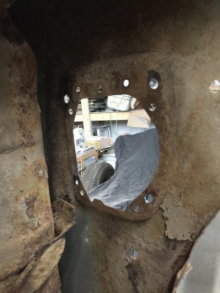

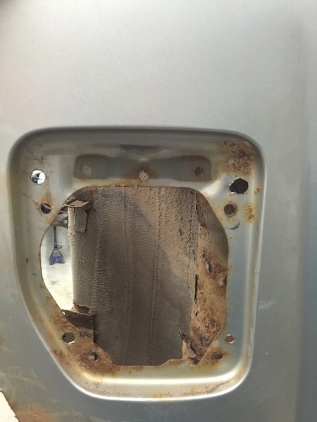

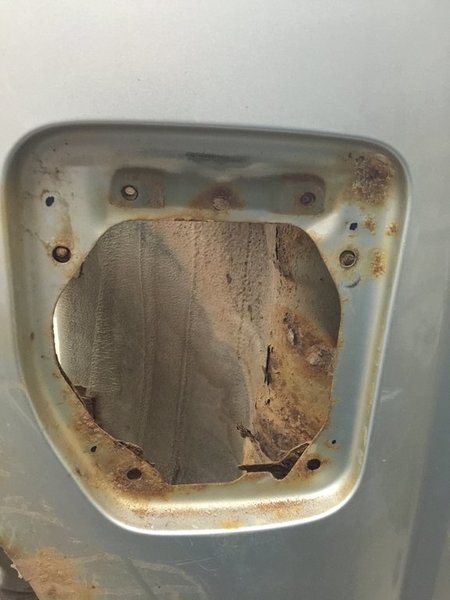

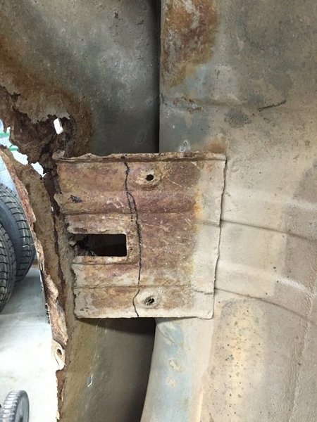

    The factory peice behind the fuel filler door is responsible for providing a mounting place for the door and for the plastic filler peice that goes around the fuel filler neck.
    In my case it was in pretty crappy condition.
    All 4 bolts were broken off in the mounting points for the plastic filler peice.
    I marked spot welds and then drilled them out.
    I will be cleaning up the rust and installing some aluminum riv-nuts to provide new places to fasten the fuel door and filler peice to.

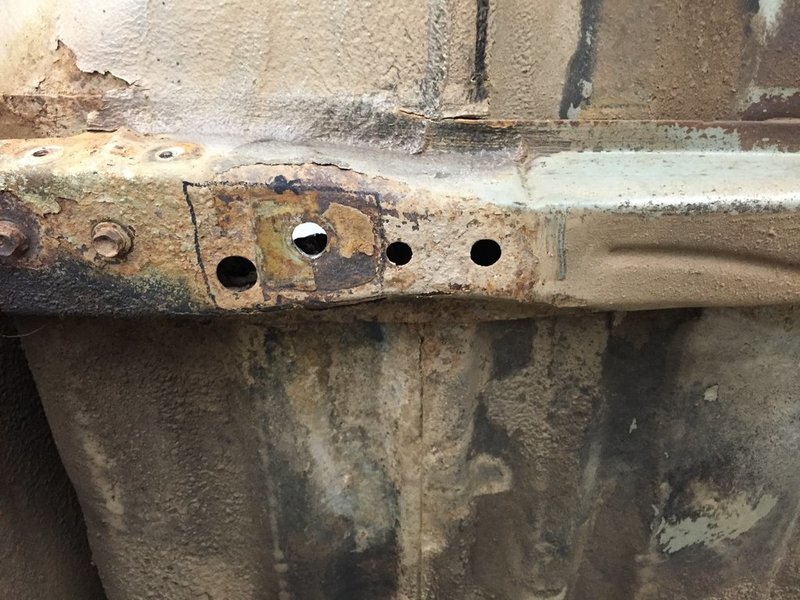

  12. Oct 5, 2015 at 6:31 PM
    #92
    EB Group
    Jul 14, 2015
    #159469
    1,406
    Rudy
    Halifax

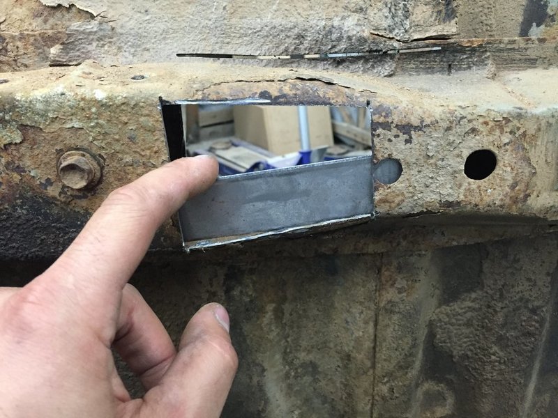

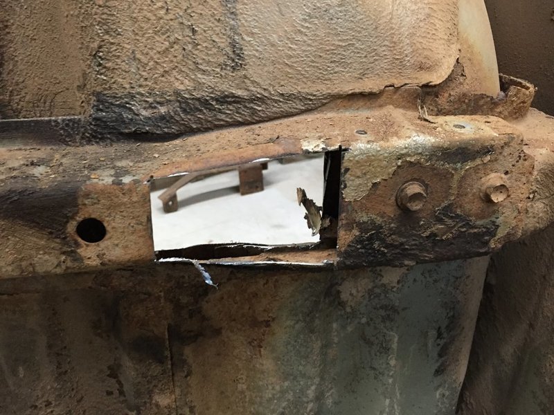

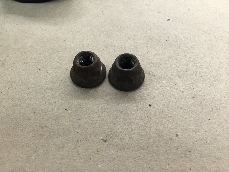

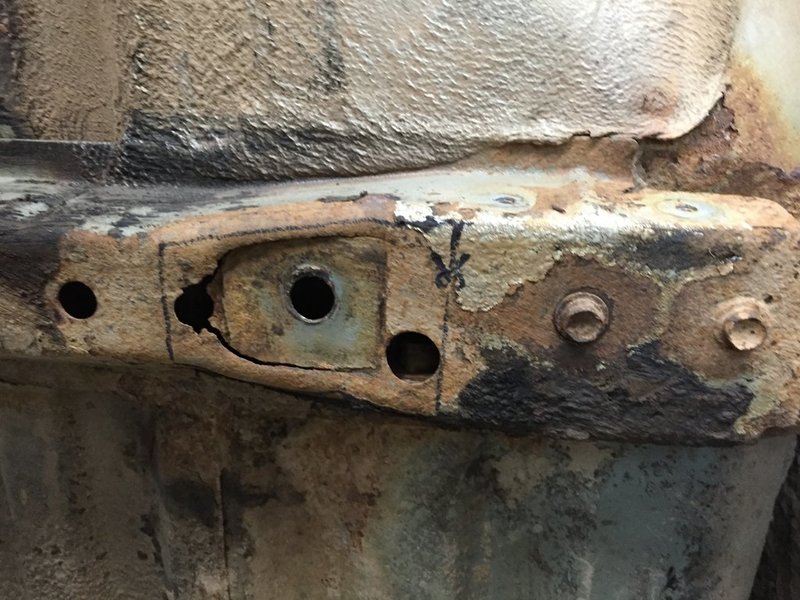

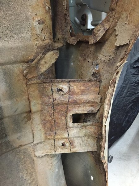

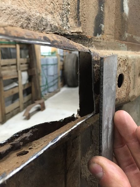

    Two of the four mounting points on the bed need to be repaired which is why I have cut out the bed in a couple areas to be able to weld new plates and nuts.
    The nuts you see pictured are what will be used.
    The plate is what the nuts will be welded to and then the plate will be welded inside the channel.
    The last picture is showing the difference in thickness of the channel and the plate.

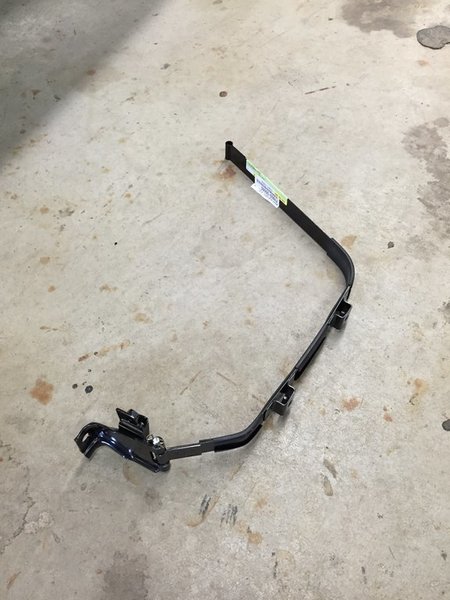

    Picked up the gas tank strap yesterday.
    I plan on putting it on this evening!

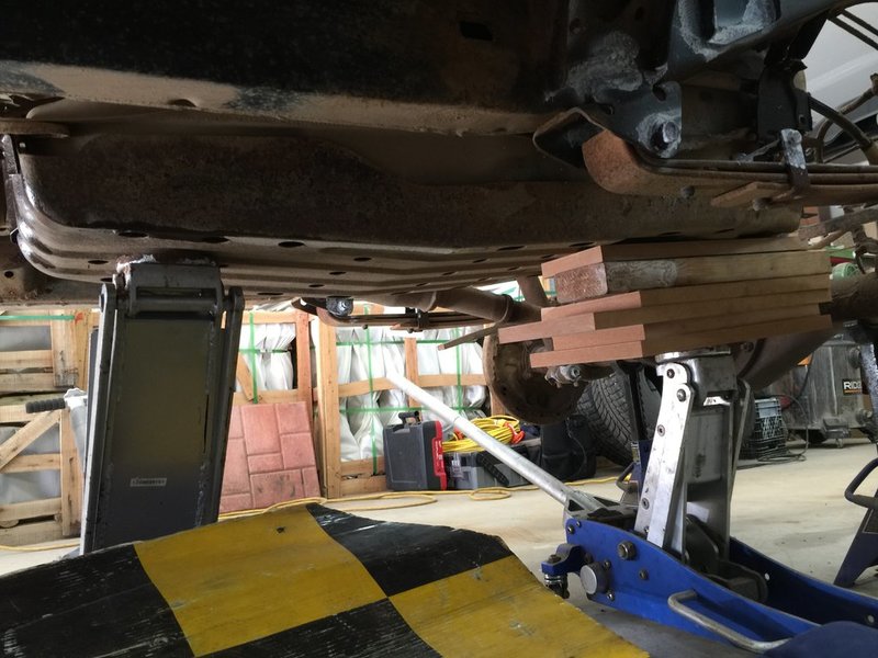

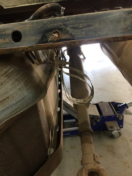

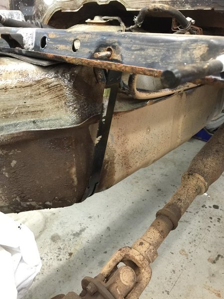

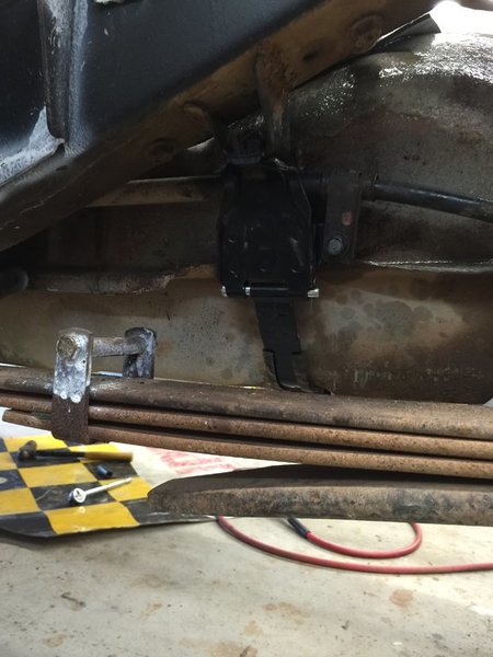

    A few pictures of the process of replacing the gas tank strap.
    There is only one btw
    One bolt holds up the front of the gas tank the strap secures the rear.
    4 bolts hold the protective metal cage in place around the gas tank.
