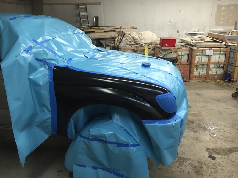

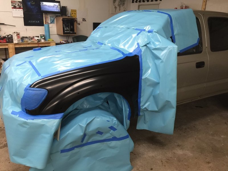

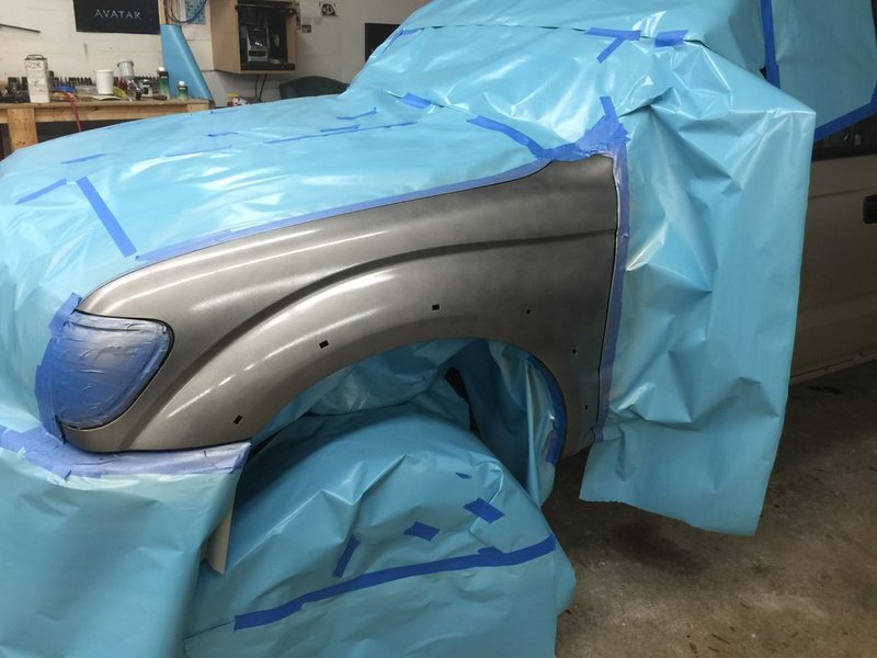

    Picked up paint today and painting the fenders as we speak. In between coats ATM.

    I have a meeting after I'm done spraying the fenders.
    I should be back in the shoup around 10pm to start tackling this pile of joyus parts!

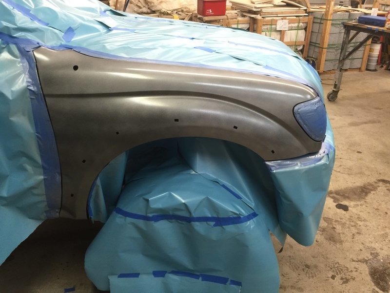

    Second Coat Done

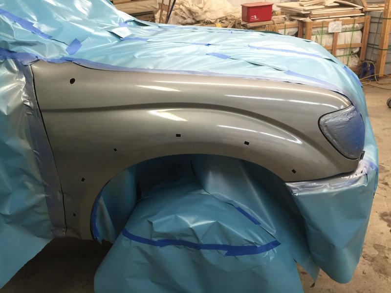

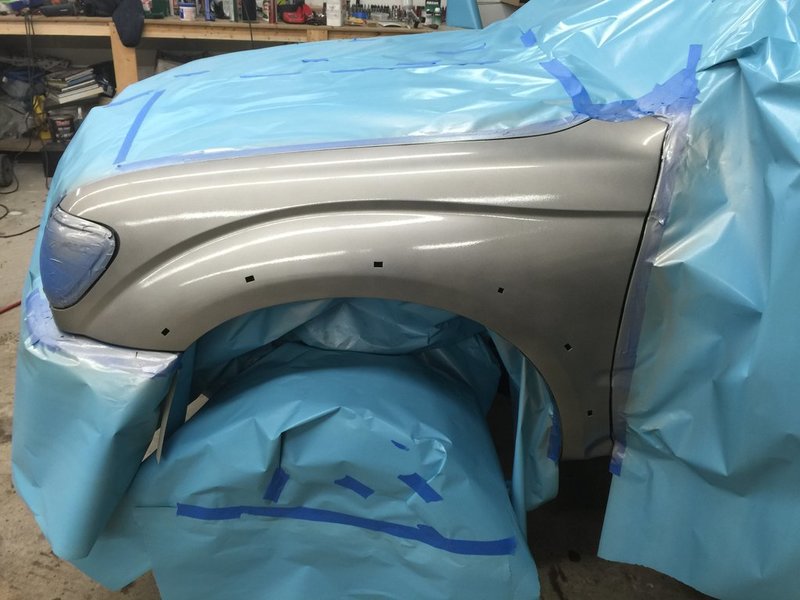

    Third Coat
    One more and we're good.
    These fenders will definately NOT match the rest of the truck. I expected as much...

    FYI, its impossible to color match that color. You need to fade it into your doors and hood if you don't want it to be noticeable.

    This I know, and I am not about to do that. WAY too much work.
    Silver is the worst colour to spray, you certainly need to be a pro to do amazing work, and I am not a pro!

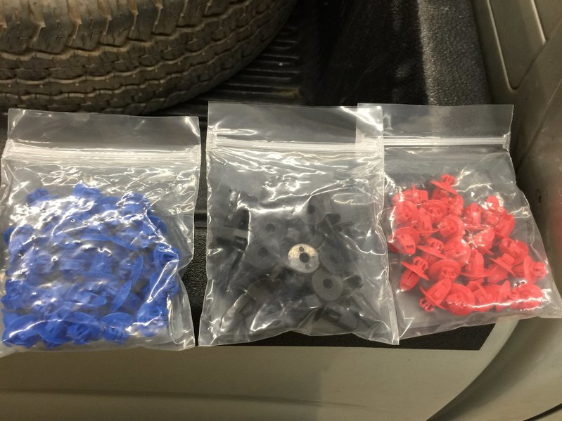

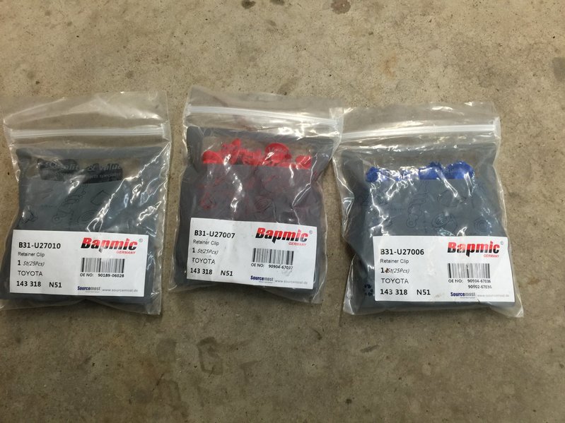

    My replacement clips for my fender flares and wheel liners areived today WOOT!!

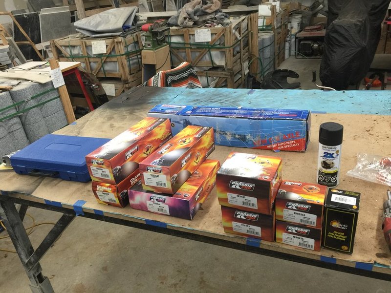

    I got a super sweet deal on this 12 Ton Hydraulic Shop Press.
    AND, my fender clips came in.
    So the fenders will be on tonight.

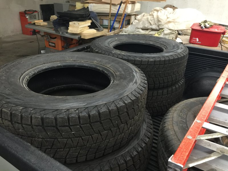

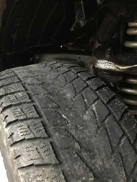

    Picked up some winter tires to get put on the rims to replace those poopy tires on there now.

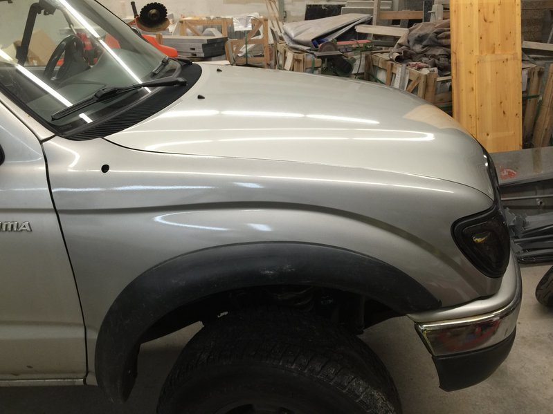

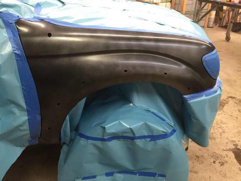

    And as requested here are pictures of the fenders after 4 coats of paint.

    Wow that tire wear on the old ones is pretty messed up, were they super over inflated?

    I think I like the color you invented more. Dark grey looks good on these trucks.

    That's what I thought. I purchased the rims with these tires on them so I have no idea what the previous owner did to them.
