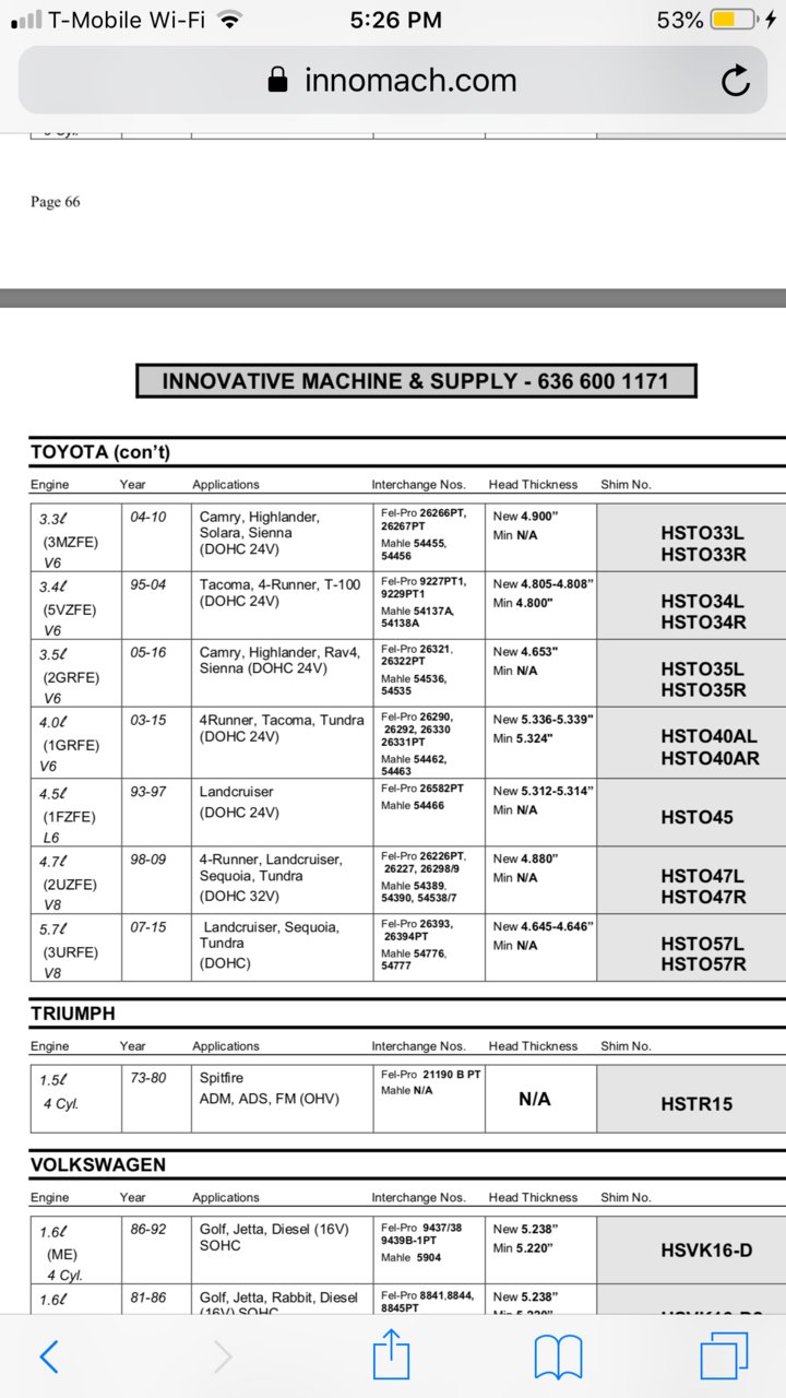

  9. Feb 25, 2020 at 5:14 PM
    specter208
    specter208 Well-Known Member
    Oct 6, 2015
    #165992
    4,206
    California
    2017 TRD SPORT ACLB w/ 6MT TRUCK WHITE
    TOYOTA OEM: Cast Aluminum Running Boards Mud Guards Bed Mat All-Weather Floor Liner NIssan Frontier Sliding Bed Extender
    Whaat is Head Max and minimum thickness? Also would valve job be necessary on 150k mile engine.

  13. Feb 26, 2020 at 6:43 AM
    specter208
    Oct 6, 2015
    #165992
    4,206
    California
    According to this. Max head thickness is between 5.336-5.339
    Min head thickness is 5.324
    Warpage limit is 0.0039 in the Haynes manual for 05/06 Tundra 4.0
