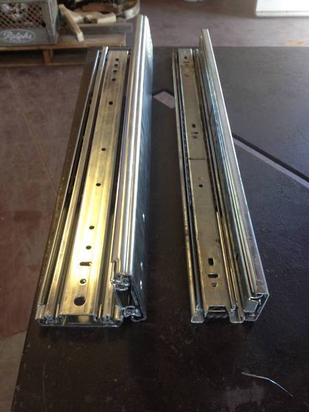

    I HATED these 100pd slides for my stove they dabbled to much so i got 500pd slides and made a whole new carrier, i added a little bit of room inside also by remaking this.
    the ones i had before weighed 4 pounds total the new ones are 12 pounds together very heavy duty.
    crappy pictures ill get better ones tomorrow

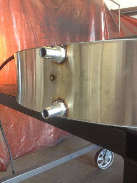

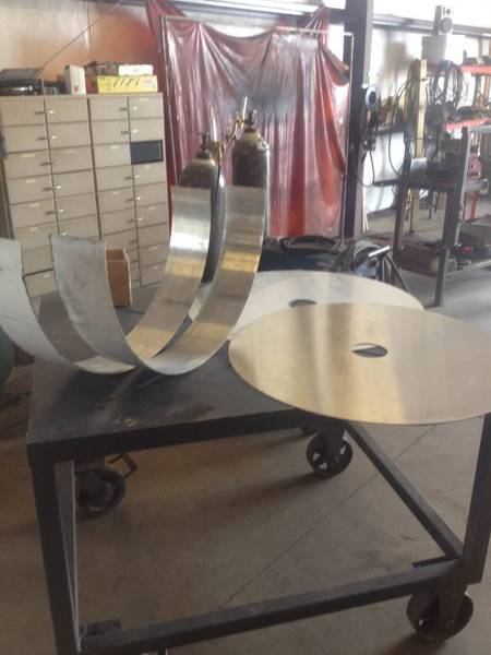

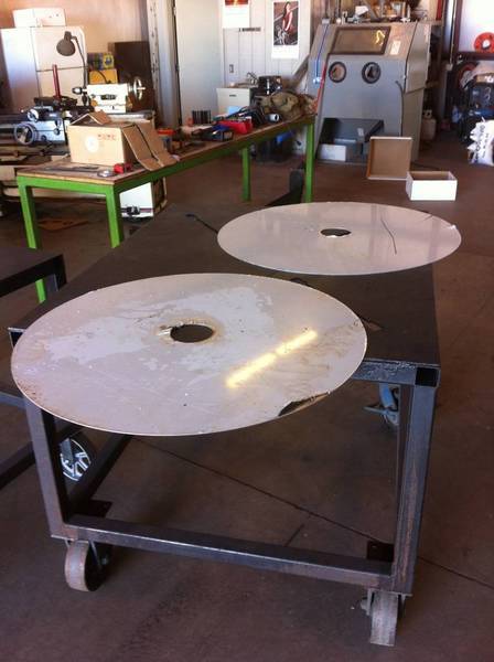

    Side project for a ol TW member.
    Its 32"X5.5" with a 4" middle whole, roughly 19 gallons of water with 3/4" inlet and outlet to took to a external pump. The tank replaces and unitizes the spare tire carrier under your truck and can be hoisted up when going on an adventure and taken out when at home. It is drinkable water all 304 stainless 0.83 wall Tig welded, this tank has over 250" of welding to be done:cool: I need to roll the outside should be tacked by this weekend. this tank will be used a lot it will be one badass tank.
    -I like making custom water tanks not cheap but people who like this idea, i plan on making more.

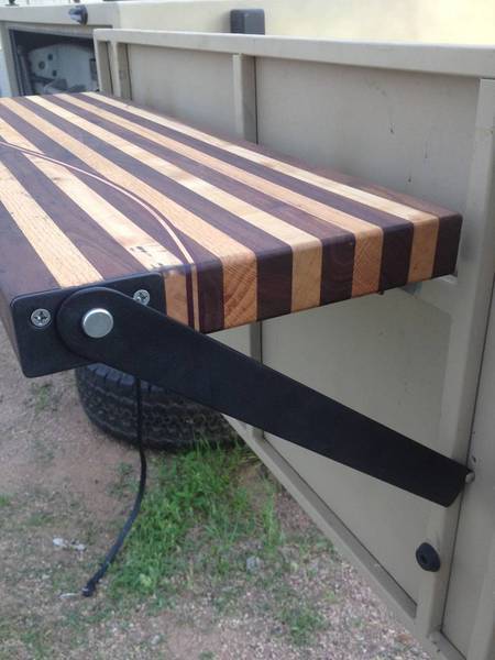

    a few thing got the hinges for the table painted :)

    this is the water tank i have been working on finished it today.

    Its 19 gallons of drinkable water, the guy I'm making it for goes camping for months, I'm glad he gave me a chance to make this i hope to be making more i will have pics of the full hook up and external pump filter set up on his rig here sooooon! the tank weighs 45 pounds dry
