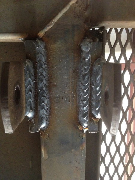

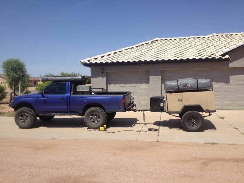

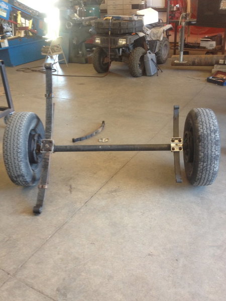

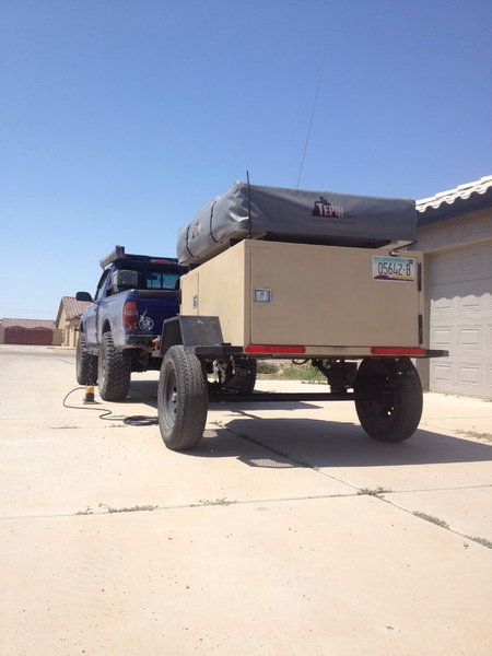

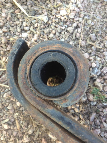

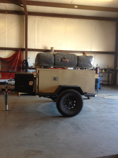

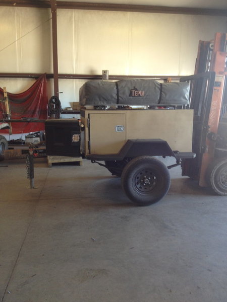

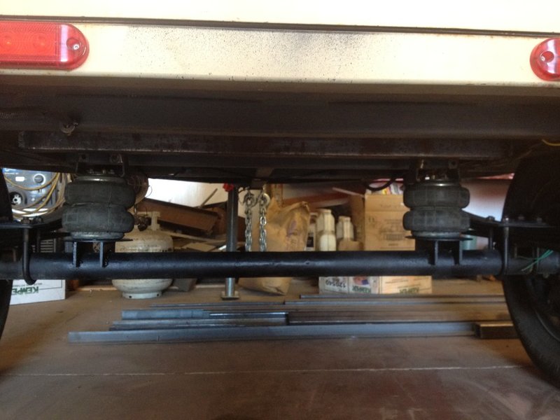

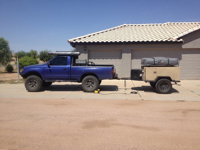

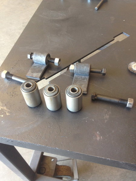

    So my suspension was way to stiff... last week i had the idea of using my old 1st gen leafs and run air bags should fix my problem. and which it did started the project on monday finished on saturday completely, besides shocks.
    first i started with the leafs i found new bushings ordered them only $45 for 4 of them, and bolts and hangers
    Old springs to my "new" ones
    I had to make front hangers cause couldn't find any wide enough wasn't hard. 0.45 er80 220A over head.
    This is when i just got the leafs on with no air bags, 2.25" from tire all the way down and 7.35 lifted up.
    Air bags installed with lines ran
    Now air bags all the way aired down.
    Aired all the way up

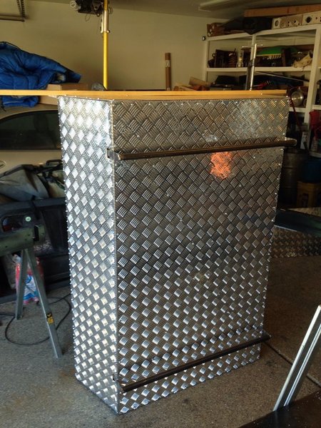

    Ran the lines out the tool box
    Overall i am more them happy with the come out tracks well on road doesn't bounce, it eats out all the bumps now, going to throw shocks on when i feel like going getting some.. can't wait for the next camp trip.
