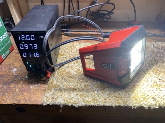

    In reference to my question above, yes you can apply 12V from a power supply to the largest two spade connectors of the m12 light and it works as usual. On high mode at 12V it draws 0.973A, i.e. 11.6W.

    Twins! I have that power supply in white!
