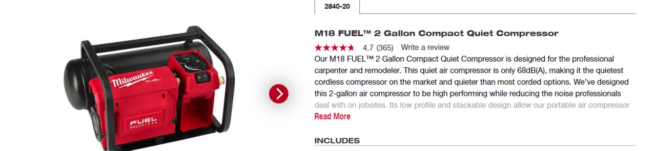

    Anybody have some experience with this compressor?

    Not on the Milwaukee but my cousin runs the dewalt version….it’s handy when needed, but not really needed. We are 90% battery at this point
    I think we use it the most when hanging insulation, battery staplers have a long lag between firing, air powered are instant
    for a couple more dollars you can get the m18 Brad nailer and m12 pin nailer and basically have no need for the compressor

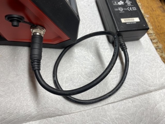

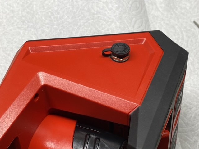

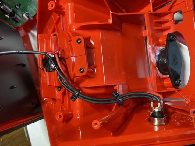

    I know it approaches sacrilege but I converted that m12 light to run off a 12V plug and it was entirely straightforward. I used a Switchcraft power jack that breaks ground on the internal battery connection before it makes the external positive voltage connection. This allows one to plug in external power even with a battery installed with no risk of accidentally subjecting the battery to externally driven current. Seems to work great.

    That’s pretty neat! A nice little adaptation, I’m sure it will suit you well. I see now your end product and realize why you were asking the questions. Nice work and clean.:thumbsup:

    1.41 cfm and 33% duty cycle for $170, eh I'm good

    The Napa Maxi Trac is advertised at 300L/min or 10.6 CFM at 0 psi. Applying the chineseium fudge factor and it's still good for about 5.3 CFM, or four times as fast as the Milwaukee. The Milwaukee is good for inflating tires without running the engine. That's about it.

    Yeah, unfortunate. For what you pay for Milwaukee you might as well get a Viair or Arb.

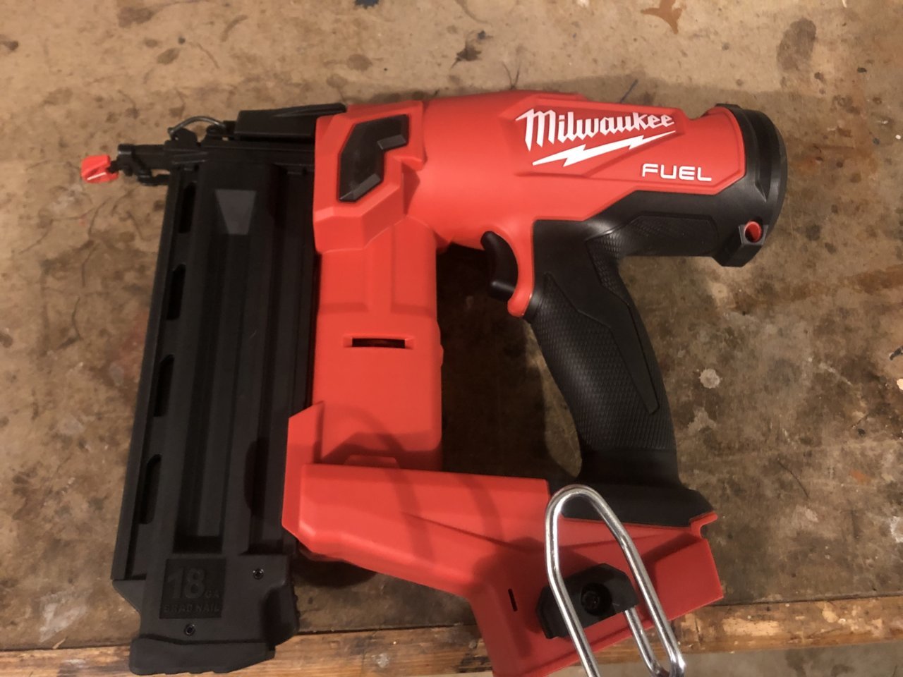

    Picked up the brad nailer a few nights ago.
    Never owned a cordless nailer. This thing kicks ass! I guess I need the finish nailer now, right?
