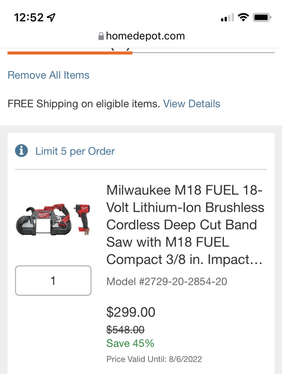

    One if the better prices I have seen for the deep cut portaband. Previous best deal I was watching was 279 for tool only.
    Site errors to view tool but add to cart button and checkout worked.

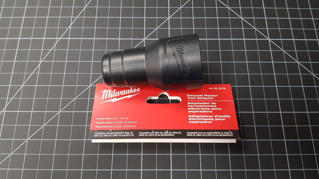

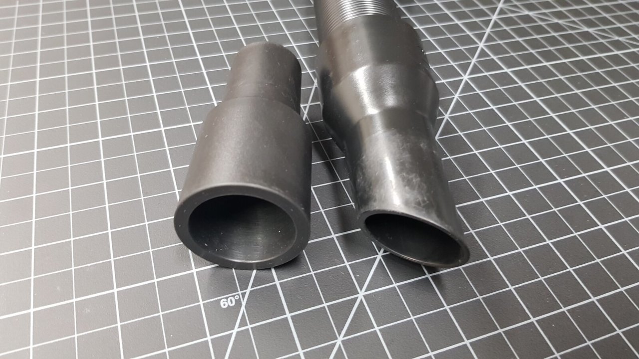

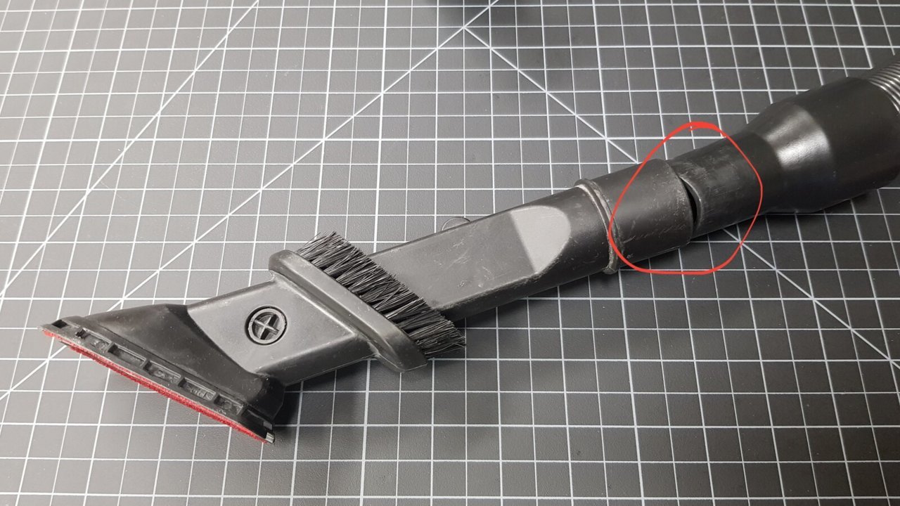

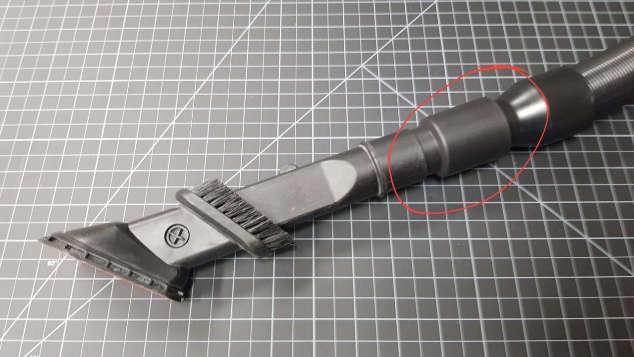

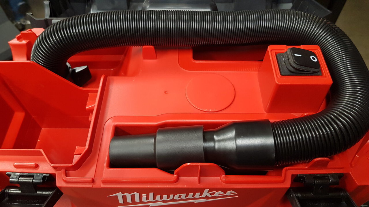

    I'm not a contractor so I have no need for one. Them AirTip attachments are interesting but pretty expensive, one of them costs just as much as I paid for my 0880 vac (HD hack). I guess if you have a need professionally they may make sense.
    But speaking of MW vac attachments. I hate that MW made them a proprietary size. They say they're 1-1/4" but none of the 1-1/4" attachments I have from other brands fit the MW. MW is oversized. Now that those AirTips came out, now I know why, so they can make more money selling their own stuff, no surprise. Edit: See post 2714
    Damn I really need a 3D printer. I thought for sure someone would have made a 3D printed adapter. Checked etsy & ebay, couldn't find one. So I had to make my own. :annoyed:
    Before:
    After:
    Still fits inside the vac for storage.
    Click for:

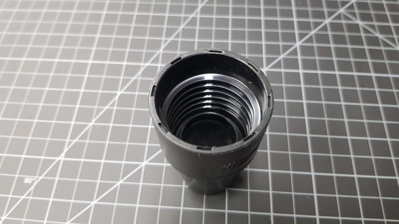

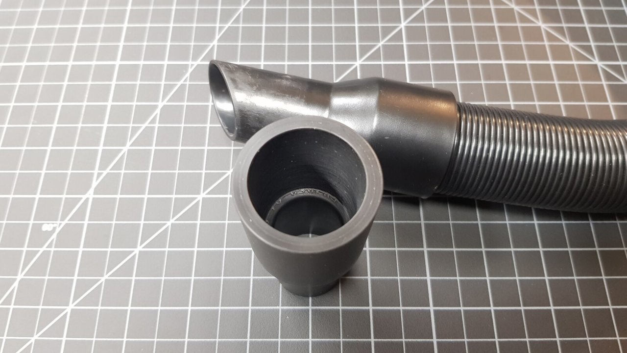

    First I found this "Power Tool Adapter" that has steps for 3 different sizes. Paid a little more getting it from HD online but at least I could return it in store if it wouldn't work out for me. Well none of the stepped sizes fit any of the dust ports on my power tools nor did it even fit the 2 MW attachments that came with my vac. Whatever, plan was to cut a taper in place of the steps anyway.
    So this thing is meant to screw on the hose but the stock one is glued on so you have to cut it off. I wasn't sure if this thing was even gonna work & I didn't want to cut the stock one off in case it didn't. Plus this stupid piece of plastic cost me $17! Back to HD it went.

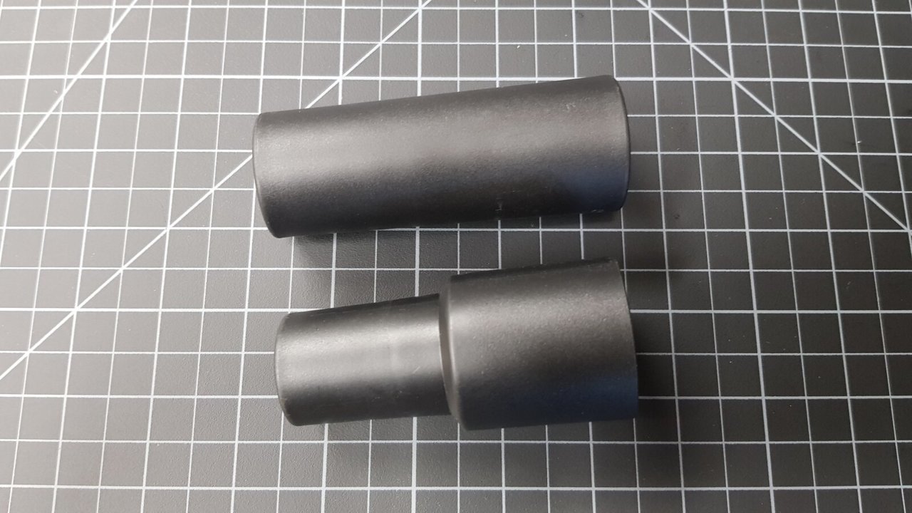

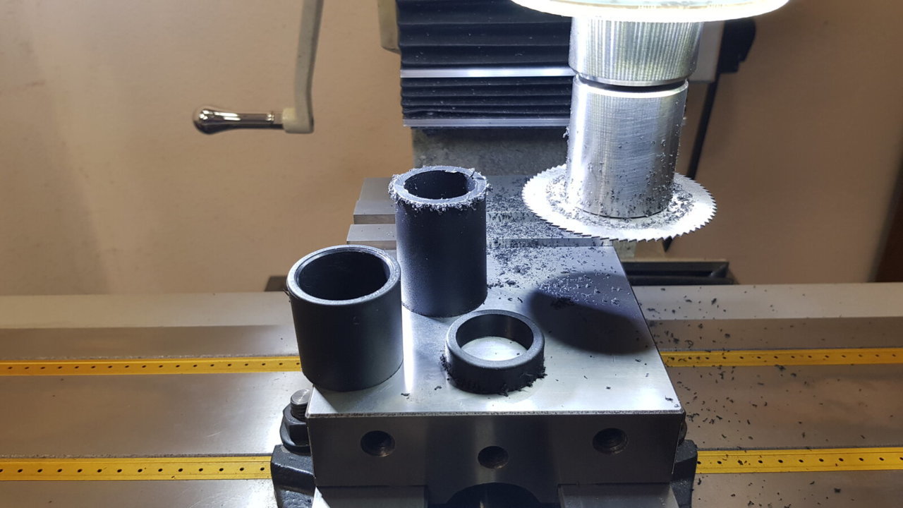

    Found this 4 piece adapter kit at Lowes for $9. Except my local Lowes didn't have it in stock. But I did find the 2 pieces out of the kit that I wanted loose in the bin. Spoke to an employee & then customer service, they sold em to me for $4.50.
    Cut out the middle section that I needed from the tapered adapter.
    Glued it into the other adapter. Luckily I looked inside the stepped adapter & saw the #5 recycle sign which meant these are made of polypropylene. Mentioning in case anyone wants to do this, most common glues won't stick to PP, I was planning to just use epoxy. You'll need a glue that will bond to polypropylene or polyethylene.

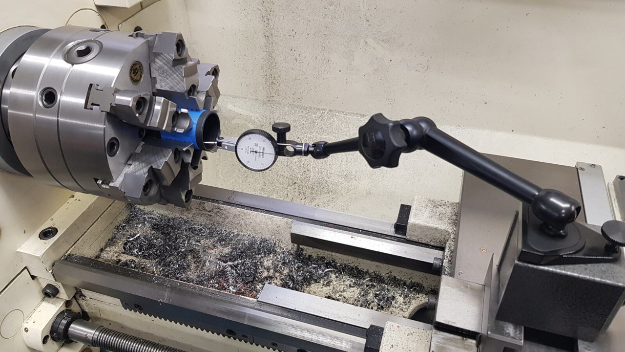

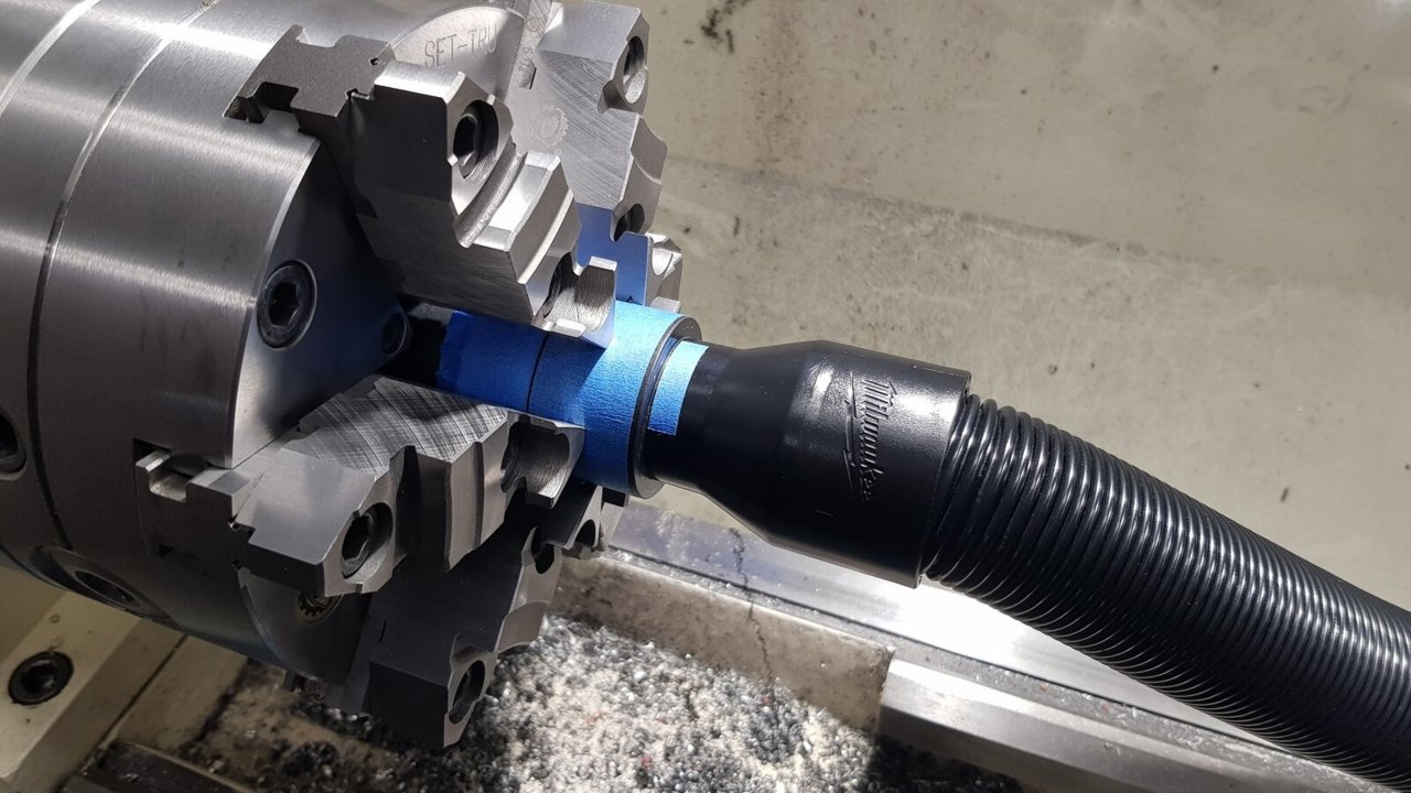

    Set up the compound slide on the lathe to match the MW nozzle taper.
    Bored the taper to fit.
    And done. Can barely tell there's an insert.
    Wish MW would have made it the "correct" size to begin with like everyone else so I didn't have to bother doing this! :rant:
