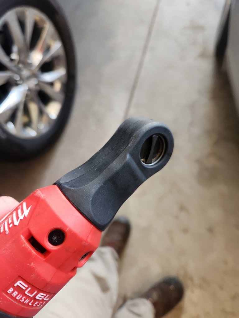

    Got a silicone sleeve for the ratchet off Scamazon. Fits like a glove and was $10. Ordered a real Milwaukee one for my old impact from HD and should be here next week. Tried to order another Milwaukee sleeve for the new one but they are currently sold out.

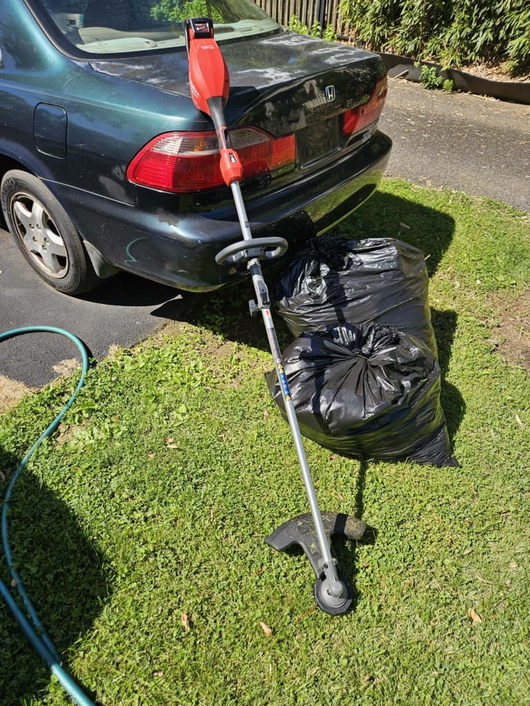

    This thing is a beast also. Glad I got it.

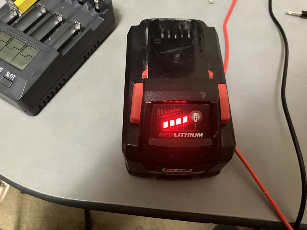

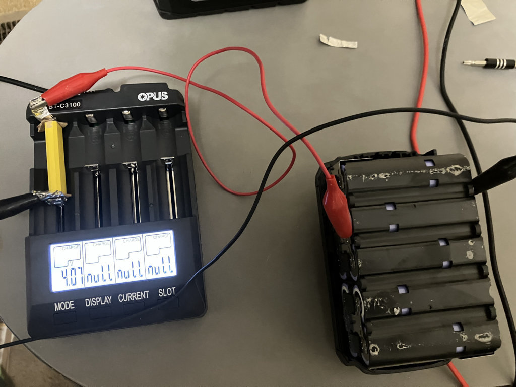

    Well, my tech persona got the best of me. I used the excuse that I needed a smart charger to purchase an Opus BT-C3100 and perform the battery hack. It was obvious to me that this particular pack not only had 3 bars but it also didn't have the life of my other XC8.0 when fully charged. Out of sync cell was 3.49VDC. Now all cell arrays are ~4.07VDC. I'm anxious to see if charger brings it back to 4 bars after use takes it down to 1 bar.

    If the cell was out of balance, usually it dies. It’s a known thing with Milwaukee.
    I’ve had it happen with Dewalt flexvolt battery before too, but the difference is you can actually balance them if you put them on the charger.
    Milwaukee on the other hand you really can’t unless you run the battery down enough for the charger to start charging.

    Which is why I got the smart charger. It’s got a discharge function and if it happens again I will discharge all cells to equal balance then charge. If I can’t save it, oh well I tried. And now I have a neat smart charger.

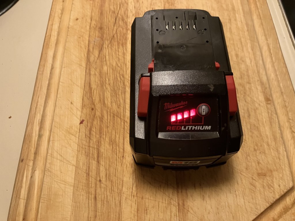

    First recharge after discharging to 2 bars:
    Result!
