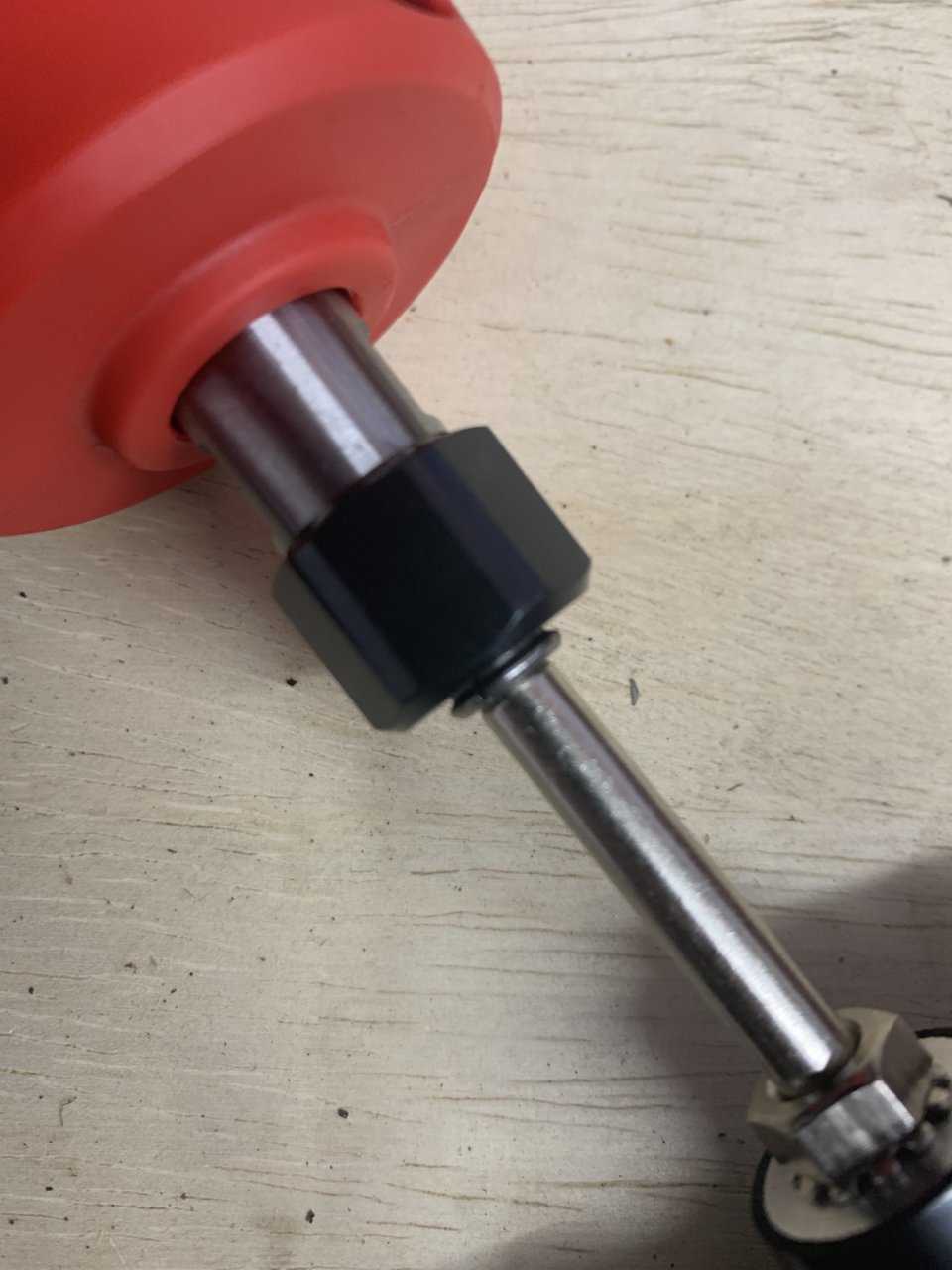

    Anyone have an issue with this kit?
    WORKPRO 101-pieces Roloc Sanding Discs Set, 2 inch Quick Change Discs with 1/4 inch Holder, Surface Conditioning Disc for Die Grinder Surface Prep Strip Grind Polish Burr Finish Rust Paint Removal https://www.amazon.com/dp/B0897MLK9B/ref=cm_sw_r_cp_api_glt_fabc_5GV2PWWWC6R56CXV00FA
    When I went out to the garage just now to check the shank sizing (yes, the rotary tool and die grinder shank/collet sizes are different), the 1/4" mandrel doesn't fit into the Milwaukee collet.
    Can I sand down the mandrel?

    You could possibly get a different size collet and nut to use accessories with different size mandrels.

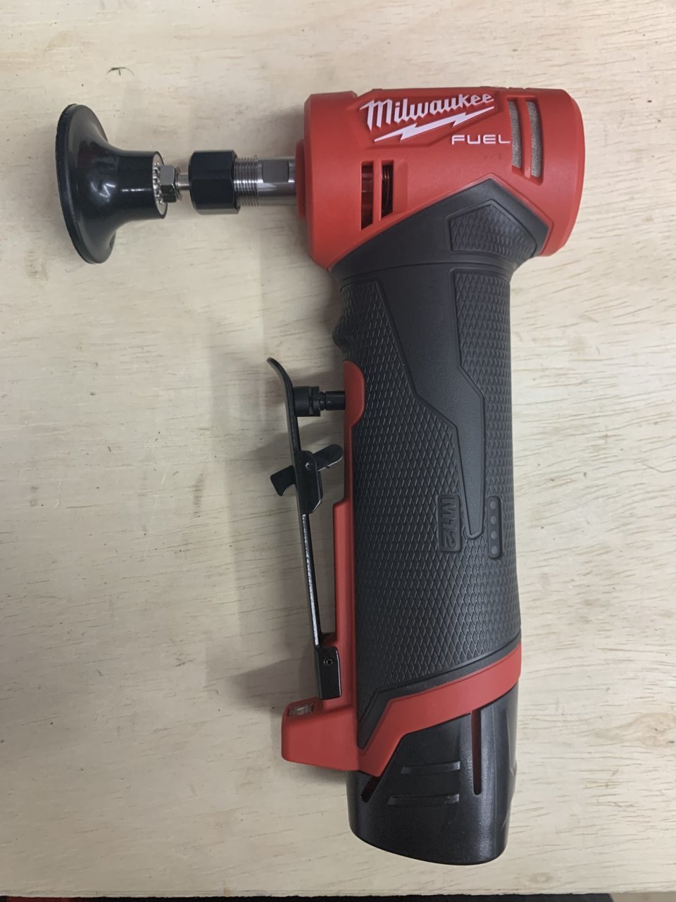

    Got it to work. Popped the collet out:

    that was clever :D

    Ahhh, I gotcha. I thought you were wanting to use dremmel 1/8” shaft accessories in the 1/4” collet die grinder. That would require the collet insert to be changed. I did read on the reviews that from factory, the collets like to stick and not allow the tool to go in easily.
    Glad you were able to get it fixed!:thumbsup:

    Don't waste your money on that kit. There's a reason that the Scotch pads cost $1-2 EACH, vice a couple of cents. You will burn through those so quickly you won't know where your money went.
    As far as using rotary tool accessories in the die grinder, remember that the die grinder spins a LOT faster and has a lot more HP than the rotary tool. Cheap accessories and those meant for rotary tool use may not last long and/or be dangerous to use in the die grinder.

    No. I was talking about shaving down the mandrel shaft to fit into the collet.
    The reviews are correct. Just FYI to those of us that got the die grinder recently.
