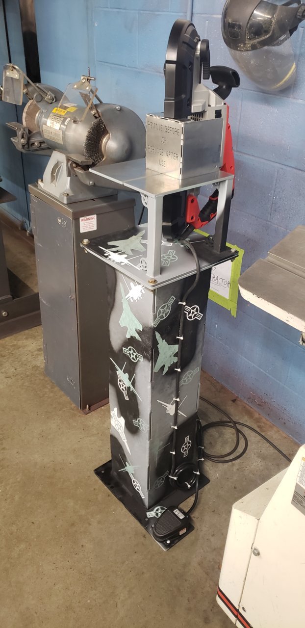

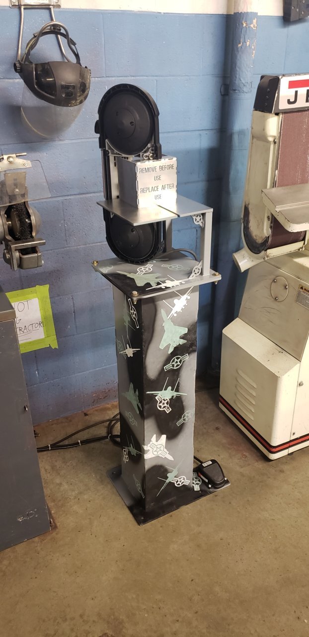

    Just wanted to show off the mini Band saw stand I designed. I shared the work with my fellow team mates for shop cohesion. We had fun making this project. Everything was cut on our waterjet so we could fit it all together like a puzzle. This was designed and manufactured at Seymour Johnson AFB Metals Tech shop.

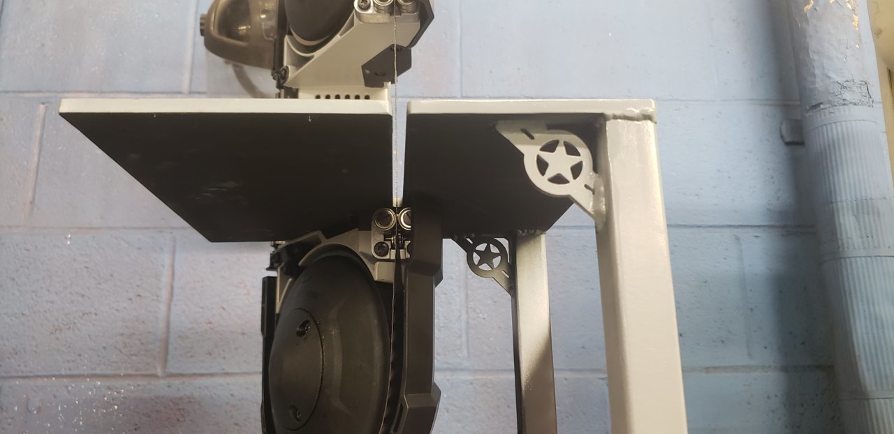

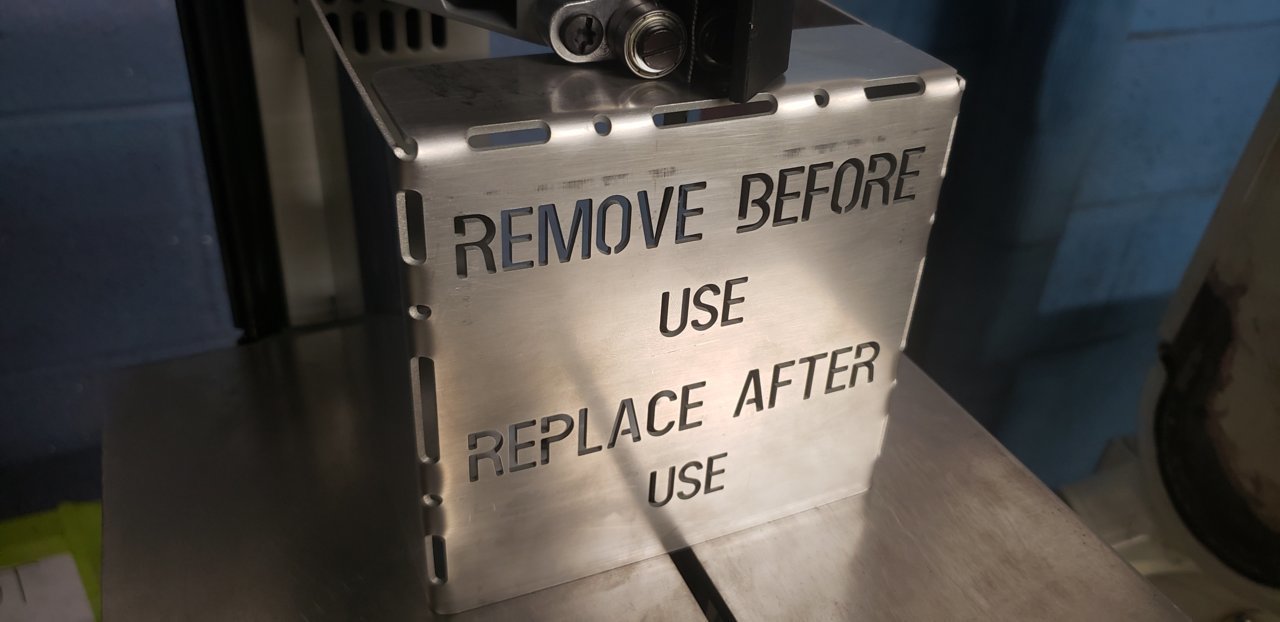

    Very cool. Do you have any pictures of the actual saw attach points and also without the nice blade guard? You have mad skils.

    Thank you for the kind words! Is this what you're looking for?

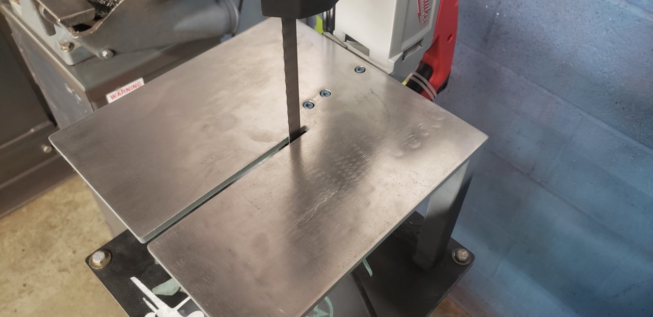

    Cool. How is the saw motor body attached to the stand? Is what I am getting at.

    It's only attachment points are the 3 screws you see on the table. Basically the saw is the 3rd leg of the table. The reason there isnt 4 legs is access to change the blade would require disassembly of the entire table would be required. This design enables quick change of the blade.
