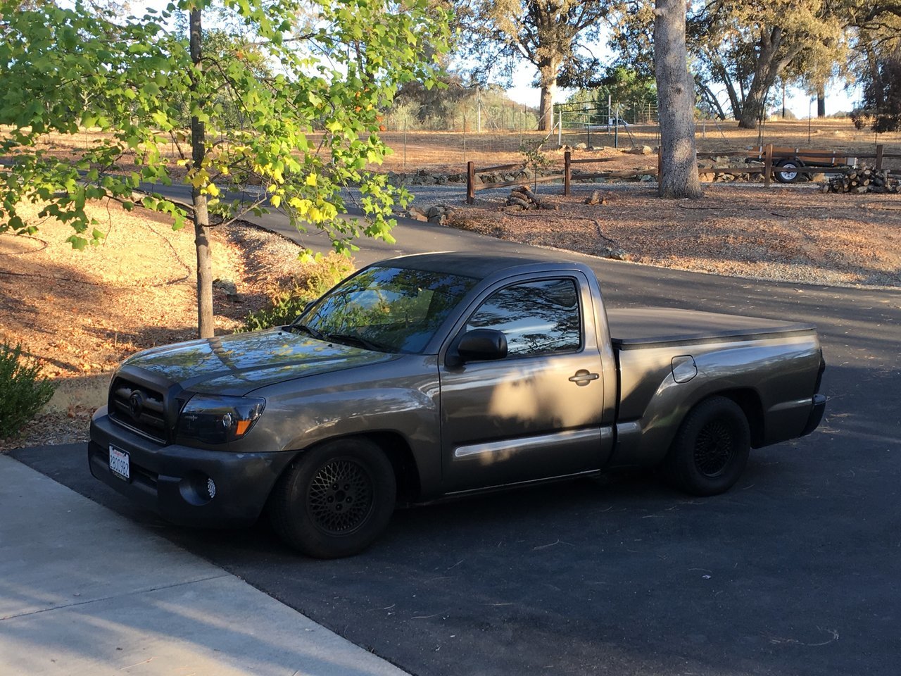

    Damn son that's low. I like it.
    BassAckwards and mini_twuk[OP] like this.

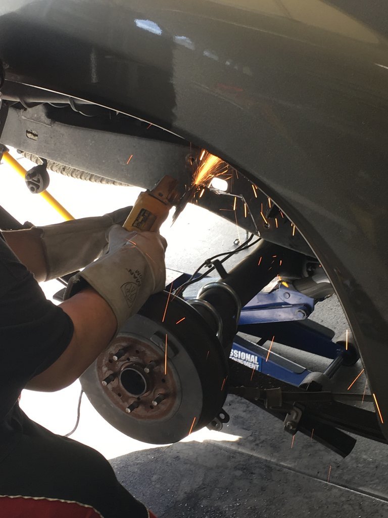

    Posting for op because he is busy cutting.

    Almost done, axle hit the bottom of the bed on the braces, cut those out, the cab was hitting a fuel tank hose bracket, moved that, and the driveshaft rubs on the back of the transmission. Clearancing that now! Then we hopefully are good to go!!

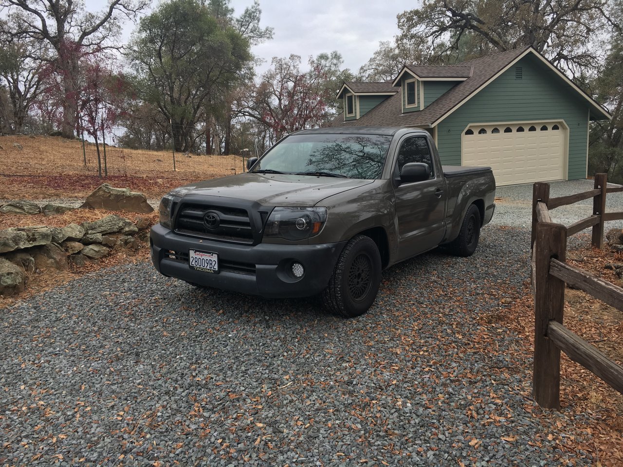

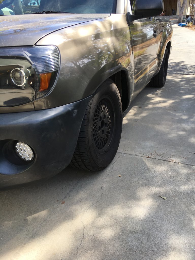

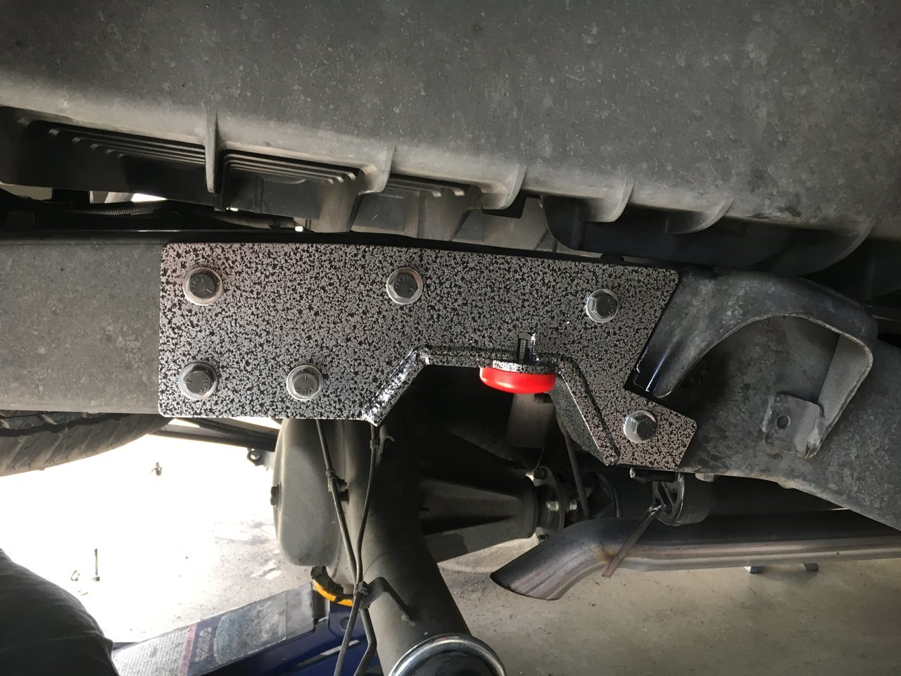

    Since Connor isn't replying I guess I will fill everyone in. The truck is beached at my house right now waiting for parts. It's so low it scraped my perfectly flat driveway with the leaf spring hanger, tires are hitting the top of the fenderwell, bottom of the bed hit the axle, and it shoved the driveshaft into the tailshaft of the transmission. #roached So now we have to replace the tailshaft, shorten the driveshaft and lift it back up a little.(no, not in that order) Going back up to only a 3/4.5 drop. Already cut all the bracing out from under the bed so after that we should be good to go.
