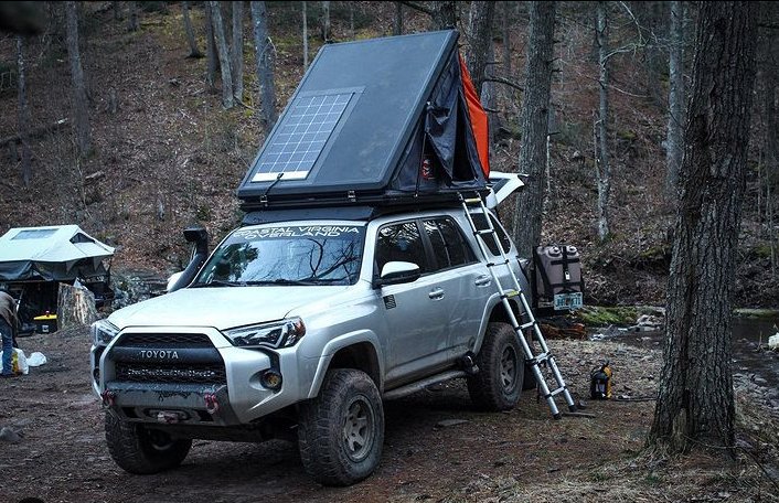

    Yes, they offer a suitcase style solar panel as well that can charge it. Or a flexible panel and mount it right to your GFC and have that run down to a house battery that you can pull power from instead of the jackery. Similar to this.

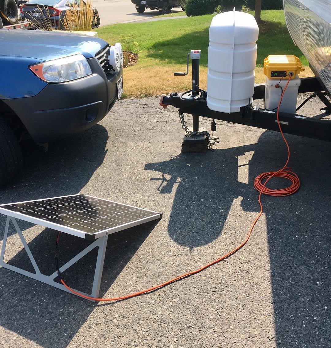

    As soon as you add another battery I wouldn't call it minimal anymore, I put together a solar box for our RV; 90w coleman with a controller in the pelicase.
    It's also got battery clips so I could use it on the truck as well.

    I do have a lithium jump box that I take on any trip I go on. I like the idea of a generator but looking for an alternative is all.
    This is pretty awesome, almost the ideal setup for me if I were to go second battery. I like this probably the most, and the only thing I'd look to add is utilizing that solar panel so I can either stand it up at camp or have it mounted to the roof of the GFC depending on the situation.

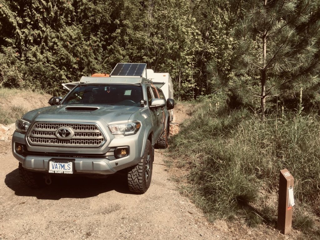

    mine goes on the Prinsu at camp;
