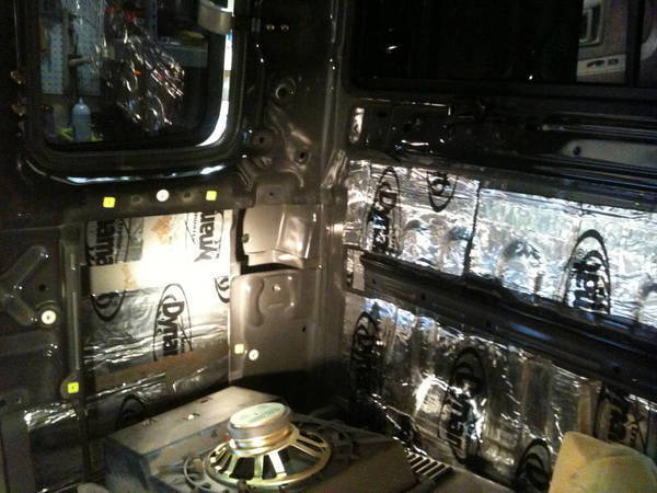

    I see you already know about deadener showdown. Im in the process of deadening my truck too, what im doing is "dynamatting" (though im using cheaper brand) http://www.sonicelectronix.com/item_27741_Stinger-RKX36B.html

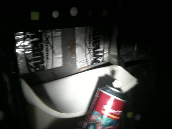

    After that, I got some foam upholstery stuff that is like 1/2'' thick with a vinyl layer on one side.. What im trying to do is mimic what SDS says to do with the mass loaded vinyl and closed cell layers. Basically Im just covering every possible surface on the inside of the door & inside the panel with dynamat and the foam.
    Heres the dynamat layer (had some extra before i ordered the stuff in the link)
    I use spray adhesive to glue the foam to whatever surface. Crappy pic but you get the idea..
    The area behind the speaker all foamed up. You should do this inside the layers of the actual door as well as in between the metal & plastic door panel.

    I got the vinyl coated foam at a fabric store. You can use a good variety of foam I just happened to see this and liked it. It was like $12/yard. The deadener in the link ^up there is the cheapest i have found and its just as good as dynamat. Good luck with your install, hope this helps :D
