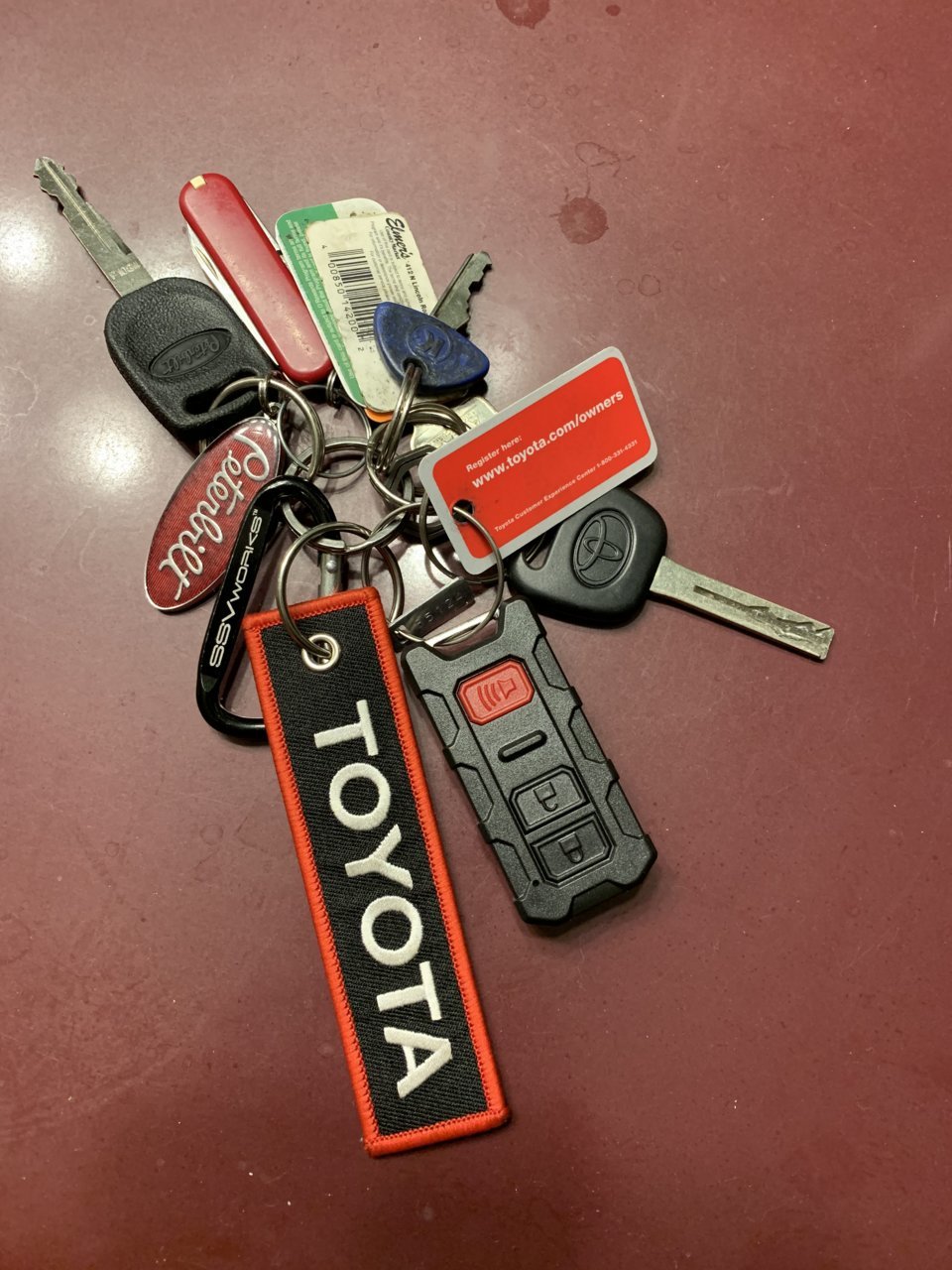

    That kit makes my sack hurt just looking at them.
    Here’s me:

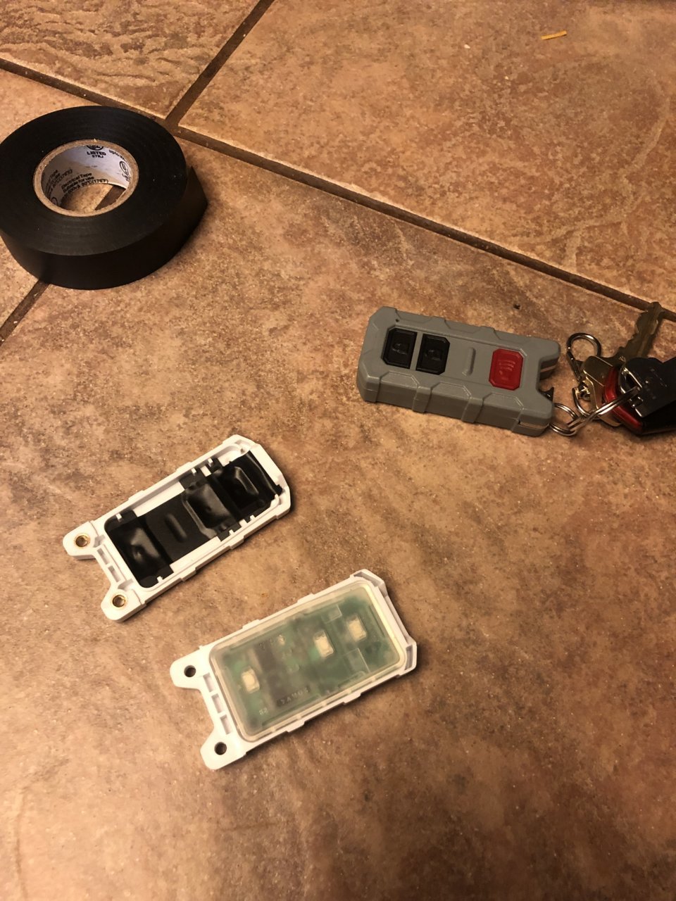

    I figured out a solution for loose buttons. I took my fob apart and put one strip of black electrical tape across the back of all 3 buttons. Pressed it down firm. Then reassembled it. It’s tight now and the tape is hidden on the inside. With the tape on, it made it easier to assemble since the buttons were taped down from the back.

    Did you include the clear plastic from the OEM fob too?

    Yes, the only thing different is adding the strip of black tape.

    Just did the wife’s with the black tape strip. I’m telling you it works.
    @MESO don’t spend $1000’s on new buttons. Just tell everyone to put one strip of black vinyl tape on the back of the buttons. Done!

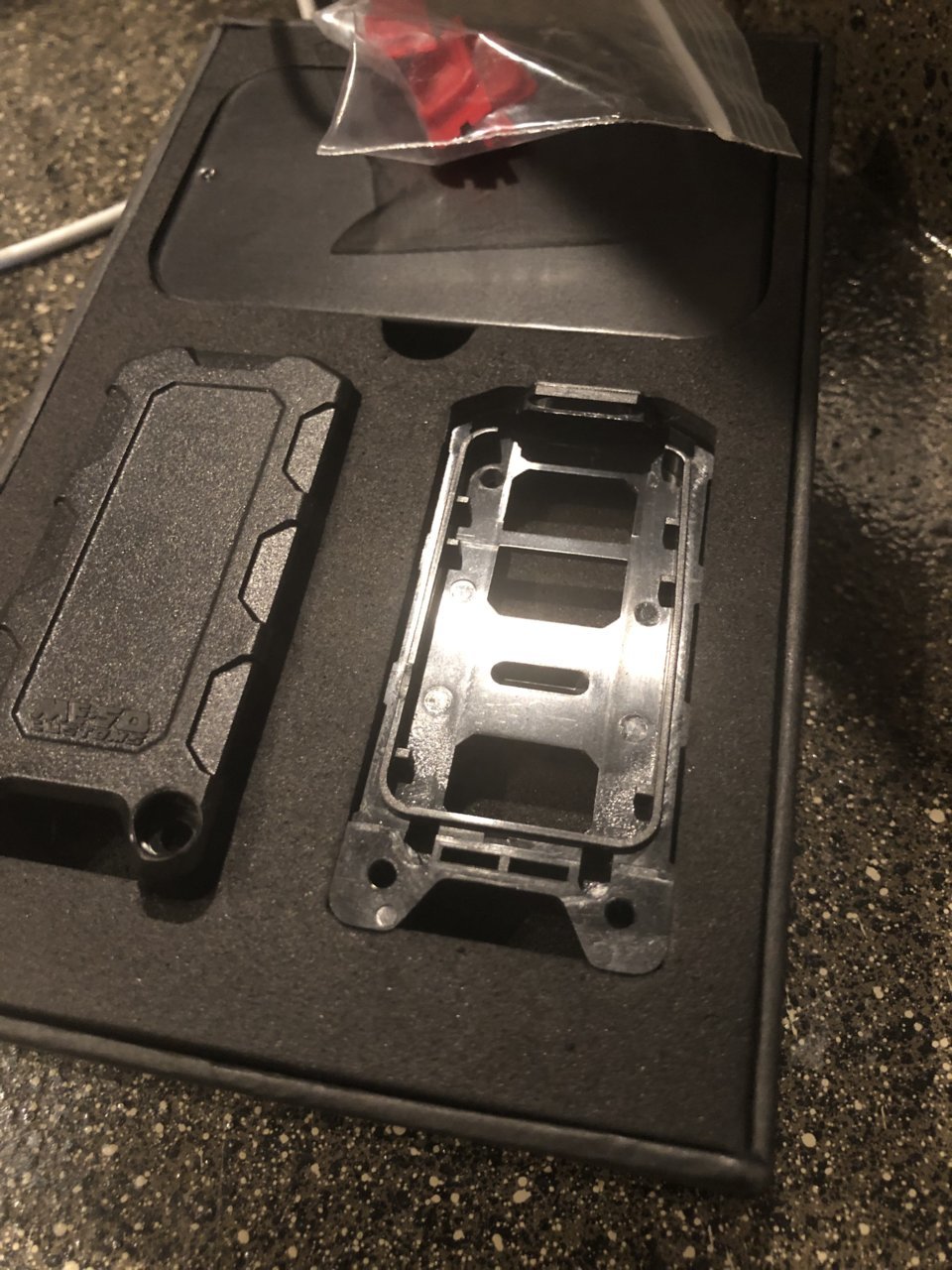

    Slight issue with one of mine. No captive nuts in the front half C90CD82B-4283-43C6-80DB-FB0565A0C1C0.jpg

    That can be a problem...
    PM your order number and I’ll send you a new black one. Pick any other color and I’ll send you one of those too.
    Lol.. this isn’t a Toyota fix likenthe tape over the TSS sensor. I’ll do it right, whatever it costs.
