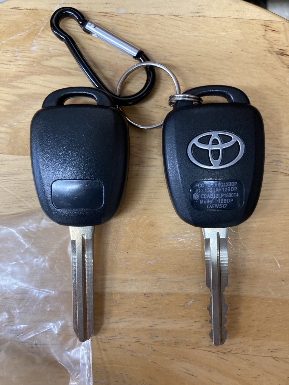

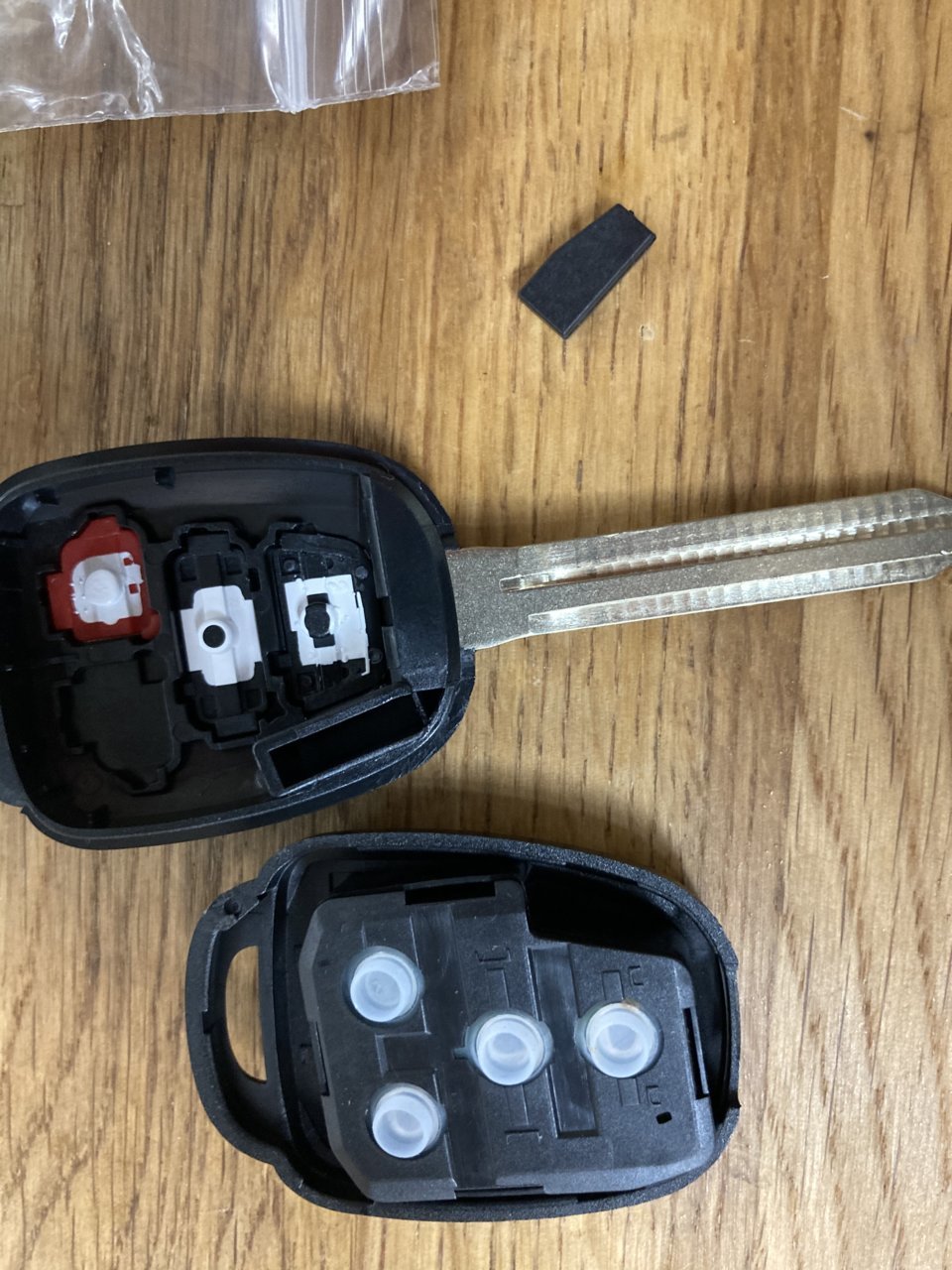

    So this is interesting.
    I ordered a full key off flea bay for twenty something and it came like this. No cutting required. Of course I’ll have to techstream to add the transponder but that saved me a bit of time right there.
    ETA: I couldn't get the electronics to be recognized by the truck. So, this plan is poor for someone wanting to use those. I'll work more on the transponder part tonight or this week, that was the only purpose of my purchase. A better plan for someone only interested in the transponder is the one Tony found (I got one of those too but it's not here yet.)

    This is the one I went with. Keep in mind I have no idea yet if it will work but it looks promising upon receipt and it was pretty quick to arrive (don’t have my flip fob yet)
    ETA: See above, electronics didn't register for me, though it was my first time using Techstream so remote possibility of user error on that one.

    I noticed the “tuning” part. Pretty slick stuff, you think of everything.
    I’m fine with using the guts from one of my OEM keys to make it work, just really didn’t want to destroy it extracting the transponder. I expected this key to show up glued. Nice surprise that it wasn’t.
    if my darn kids ever go to sleep I can try out programming it.
    ETA: Failed to get the new key electronics added.

    It’s a total fake. I only got it for the transponder really. The $8 one Tony found seems like a better deal on that. I had a small hope the electronics might play nice but it doesn’t seem so. I’ll update my post.
    I didn’t spend enough time on it last night but the post from GF8er indicates I should be able to program the immobilizer transponder part without having a key cut but I thought it prompted me to insert the new key. I will put more effort into that tonight.
    ETA: From reading prior posts someone suggested taping the new transponder to a known good key. I could try that.
    I’ll update my prior post to indicate this plan is not so good :)
