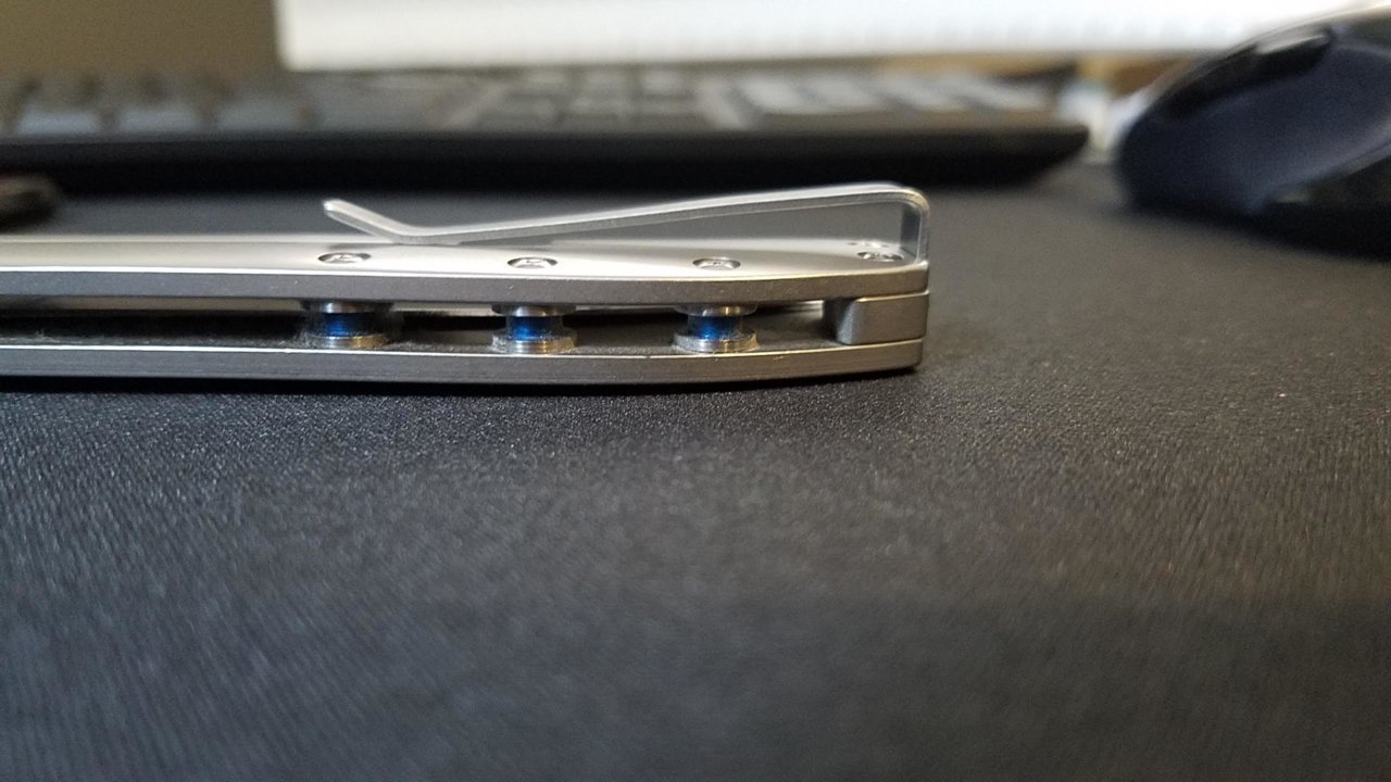

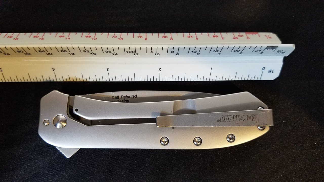

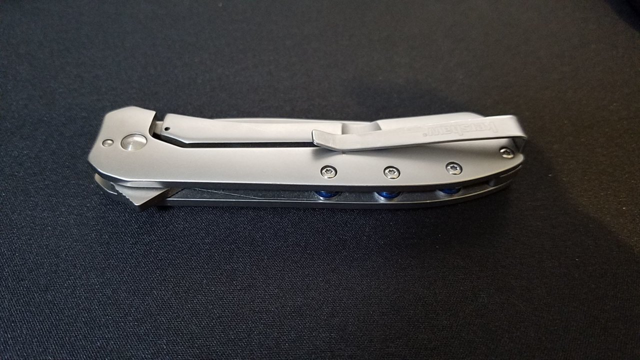

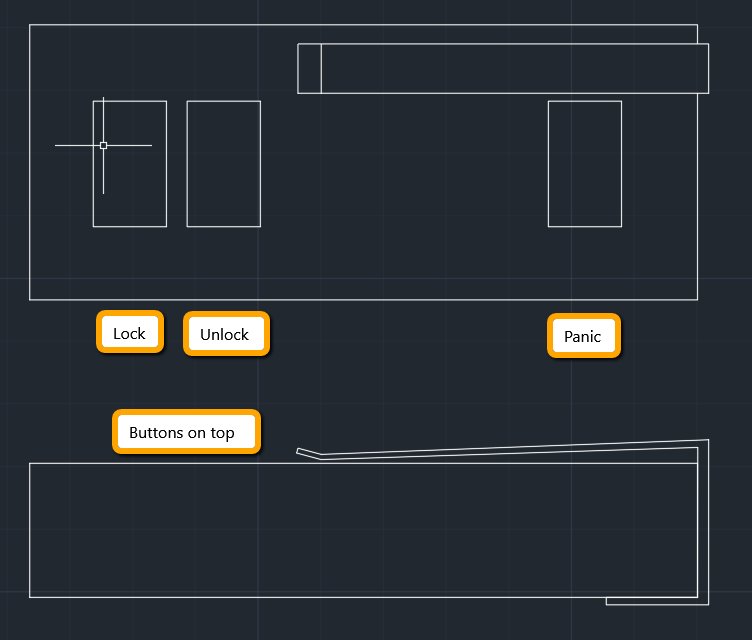

    Yes, I would change it for deep carry. I personally prefer the buttons pointing out so you can click them through your pants pocket. You would be able to feel the buttons through most pants material and know lock is down, unlock next, panic at top of the clip.
    Might consider just a single clip from one side so it doesn't get in the way of the buttons. Sorry for the crude CAD work, threw this together to get the idea across. Included pics of my Kershaw pocket knife for reference. This clip is perfect, small and discreet. The clip on the knife is simpler and screws in from the right side of the photo instead of wrapping around. I figured wrap around could possibly leverage the existing screws on your fob design.

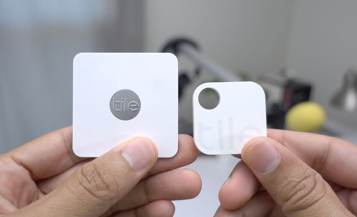

    Did you look at their super flat one? The Tile Slim. It's super thin but larger than a standard Tile.
    Issue would remain with sourcing internals...

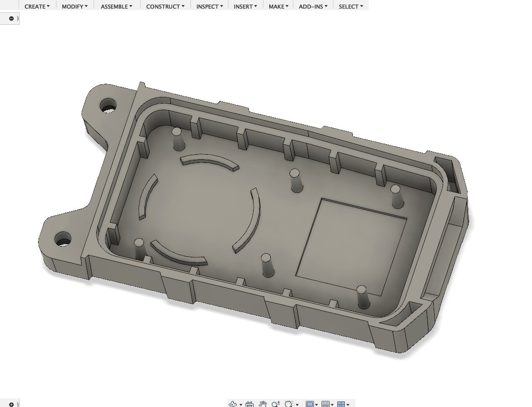

    The problem with the clip going higher is it would possible interfere with the bottle opener..

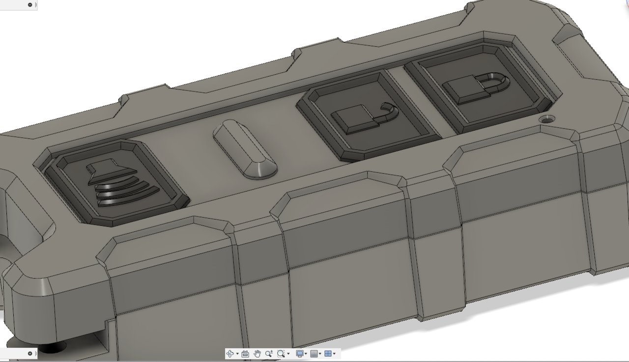

    Negative. It uses the 2 screws to anchor it down. The top is just a plastic slap clip and not enough meat for an opener.
    edit.. here's a better idea to show you the space constraints
    I've also added a "locating nub" in the dead spot between the panic and unlock. This will be useful when reaching in your pocket and quickly locating the fob orientation. Plus it fills the empty void and reinforces the face.
