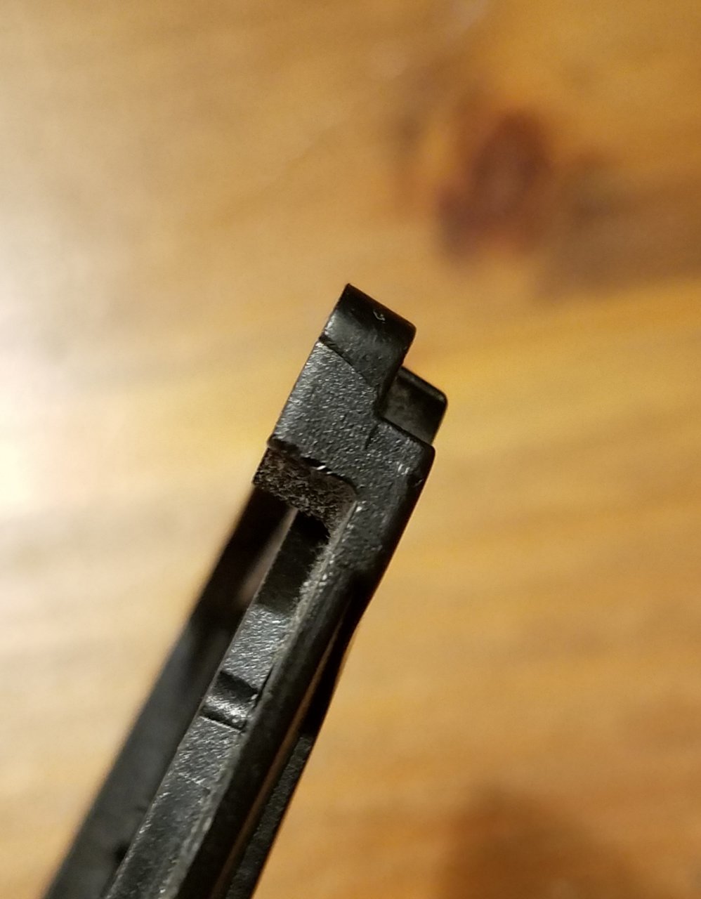

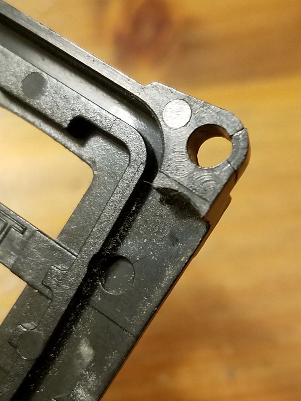

    Top corner

    Mine did that on all four corners, waiting for the MESO one to release, hopefully I can get one so I don’t have to go back to the awful stock one...

    I’m going to have more than enough to go around:cheers: and these metal tabs aren't breaking;)
    I wonder what material that is(100% ABS Or a mix)

    Don't know, but it's soft and scratches easily. However, the OEM ones from our 2013 Highlander still look new.

    I’ve never held, owned, or examined one... but it looks like ABS which can mar and break easier. Just speculating, not bashing at all. Your OEM key fobs are made of a polycarbonate ABS (PC+ABS) or PA6 which withstands scratching and impact much better.

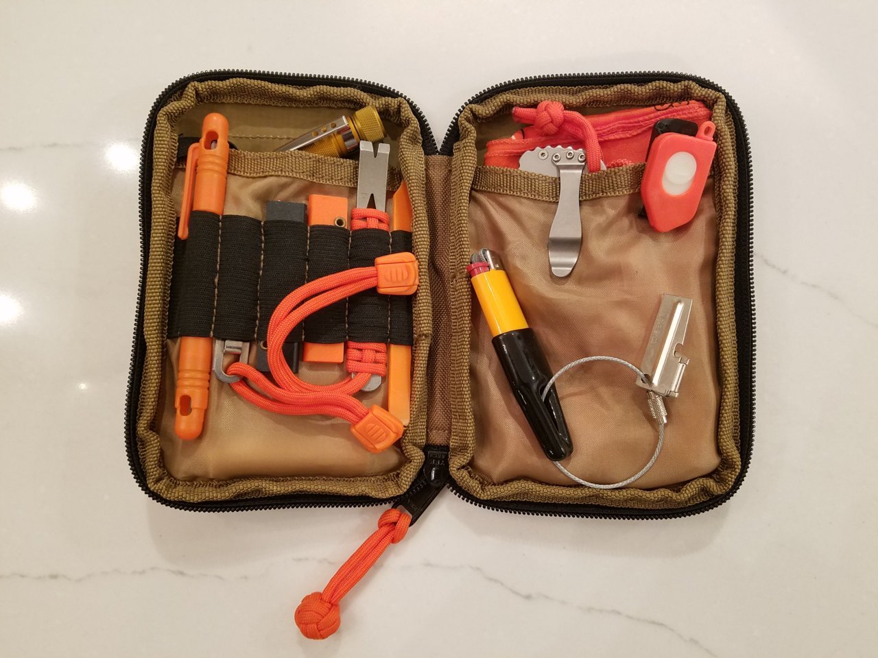

    Just don't forget safety orange. Apparently I have a thing for orange tools.

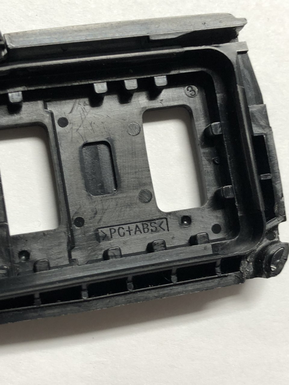

    PC+ABS with a “micro” pebble texture (look at your stock fob finish) it will be very close to that. In fact if you pop it open it’s even stamped on the inside

    Looks like over torqued screws

    The inserts will make it better than any other fobs on the market.
    Unless someone is planning to put a bushing in to these things with a shoulder bolt that’s going to be the best bet. Another problem with the AJT fobs is that there is a small gap between the two halves before they’re torqued down. The plastic has to handle that stress and ABS is horrible for that.

    Dropped from waist high on the driveway one time. Screws are just barely snug.

    +1 for safety orange!
