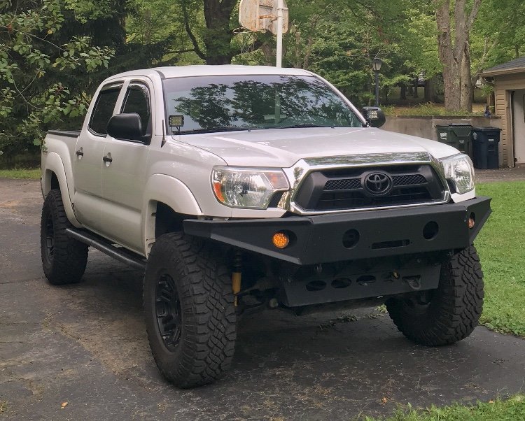

    haha man, not sure what to tell you guys. i ran my 2012 tacoma on a 2.5 in OME lift for 3 years, 2 years with NO sway bar. never did a CMC. rubbed on some plastic and had trim to the inner fender, but otherwise no issues. i had an 06 tacoma, 285s, 2" lift, wheeled hard, did keep the swaybar on that one, no issues.
    lots of offroading trips. smashing sliders, pivoting against trees and bouncing off rocks type wheeling... i'm sure i rubbed a little at some point, but never noticeable, no chunks out of my tires, etc
    not many pictures of my truck in action but here it is a few miles into the woods with some dudes on 37s and 35s including Mike from Resz fab, you can see how much its leaning just sitting there on a slight bank since i ran no sway bar
    here it is sitting in my driveway to prove i had 285 (i guess, is this what you want me to show you?)

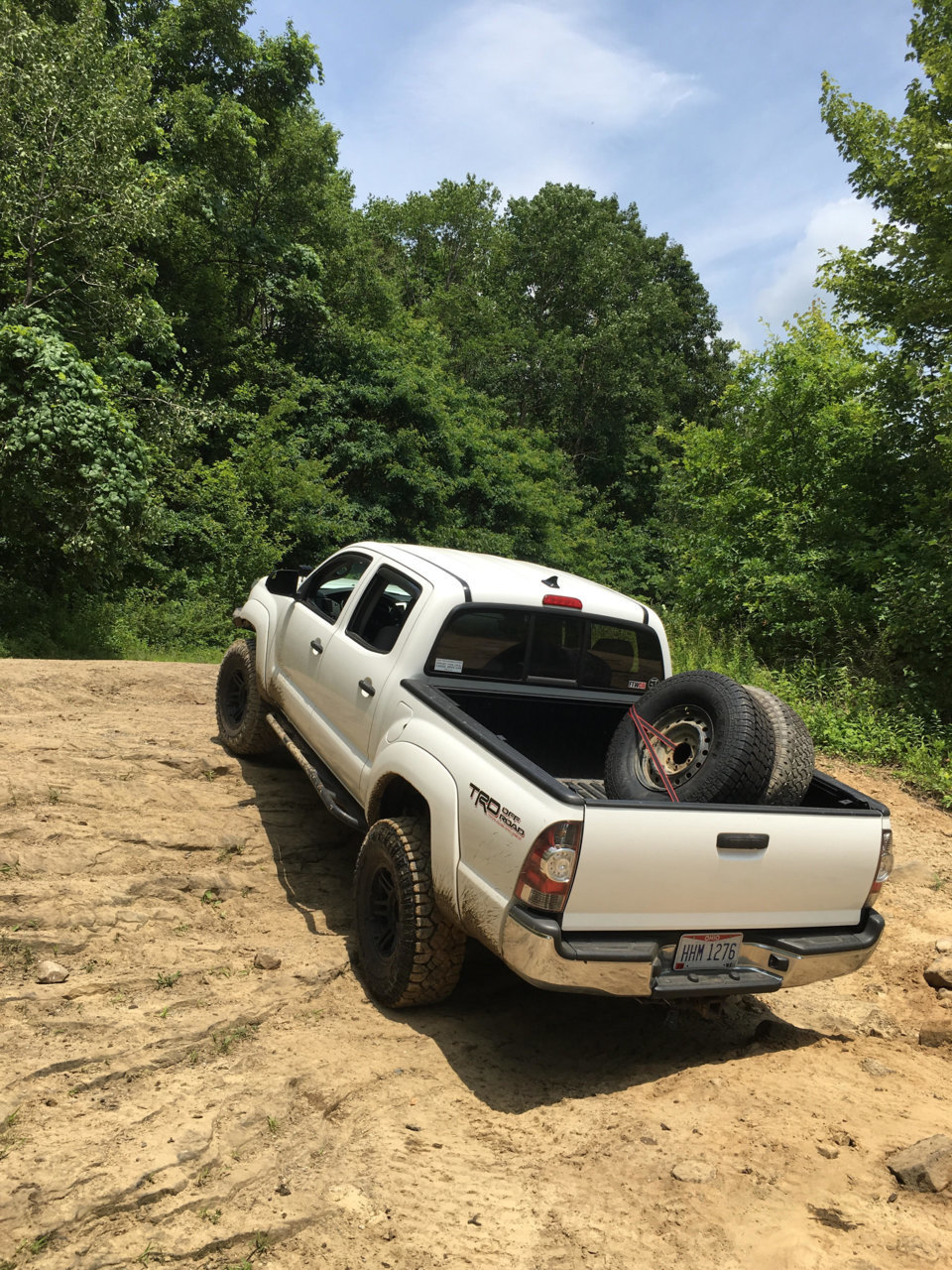

    here is the only "action" shot i have on my laptop... not exciting, literally just driving up some stuff, not even flexing.. but again, i'm "showing you" something
