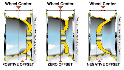

    I’m sorry if I sound ignorant but I don’t know what an off set is. I had a Mustang GT. I purchased tires and rims had them mounted and balanced and put on. I had the GMC blazer years ago and I did the same thing. I never heard I had to off set rims when I installed them. Please explain. I will do my lift, tires and rims soon, I plan to put 35” on. I plan to do a high clearance front and rear bumpers as well. Thank you guys in advance.

    Look at the diagram below and imagine a line down the exact center of the rim ("Wheel Center"), this is like an equator. Offset is a measure of how many milimeters the face of the wheel hub is recessed or poking outwards from that equator. The more "deep dish" rims will have a "negative" while probably the majority of wheels have positive offset instead. It's just a matter of how the manufacturer designed the rim. The more "negative" offset a rim has, the further away from the suspension of the truck it will sit. (Generally, but also depends on the overall width on the rim)
