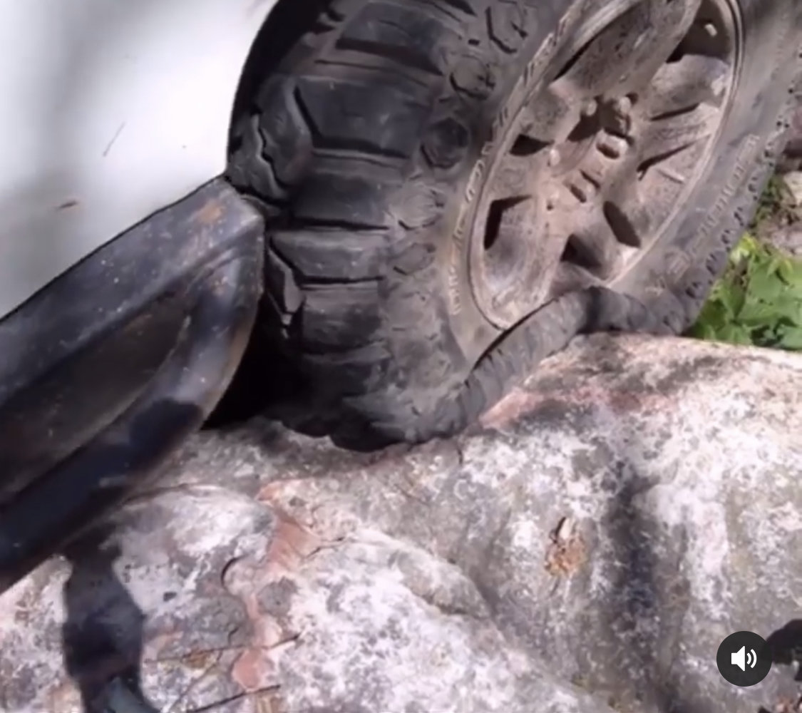

    I’m not OP.
    my argument is off-road traction, not on road handling. Side bulge is what you want.
    Body roll partly due to no sway bar and soft tires are my expectation. I purposely chose tires for maximum off-road traction. Not on road handling.
    maybe I am confusing all you with people who go off-road, not commute to work and home and that’s it.

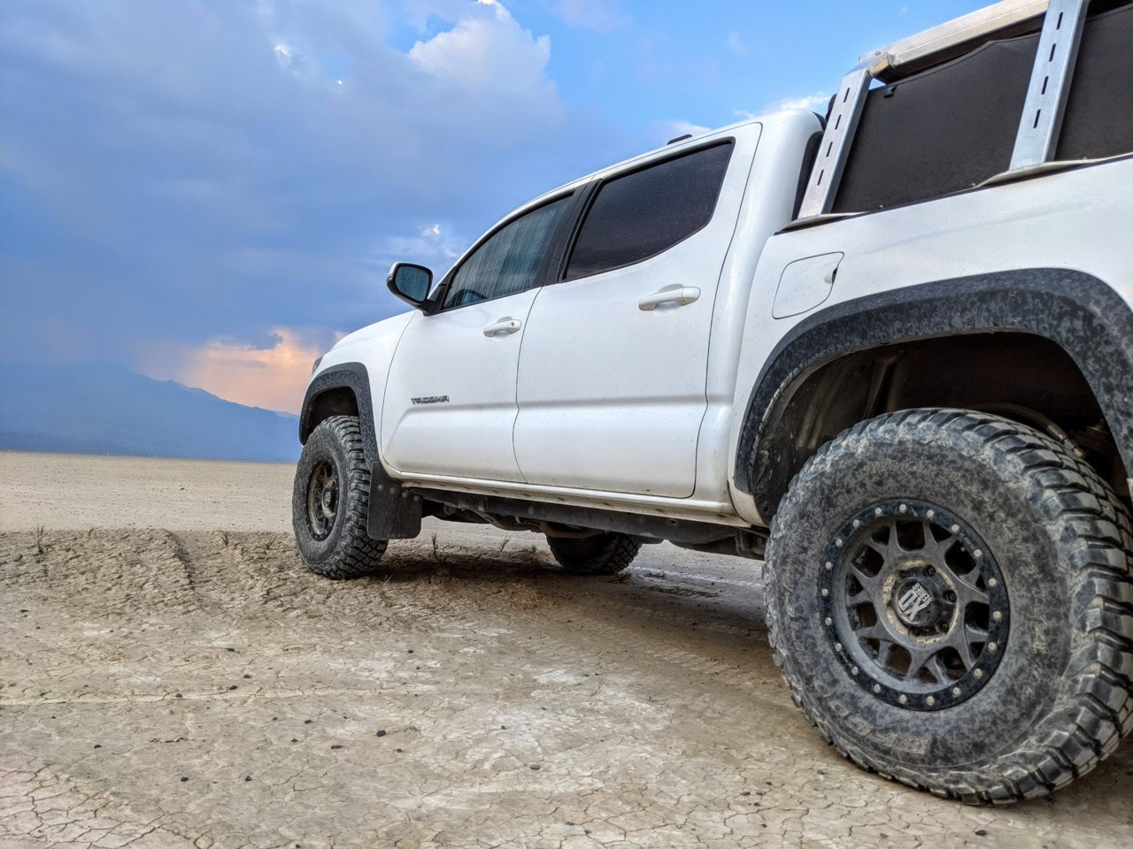

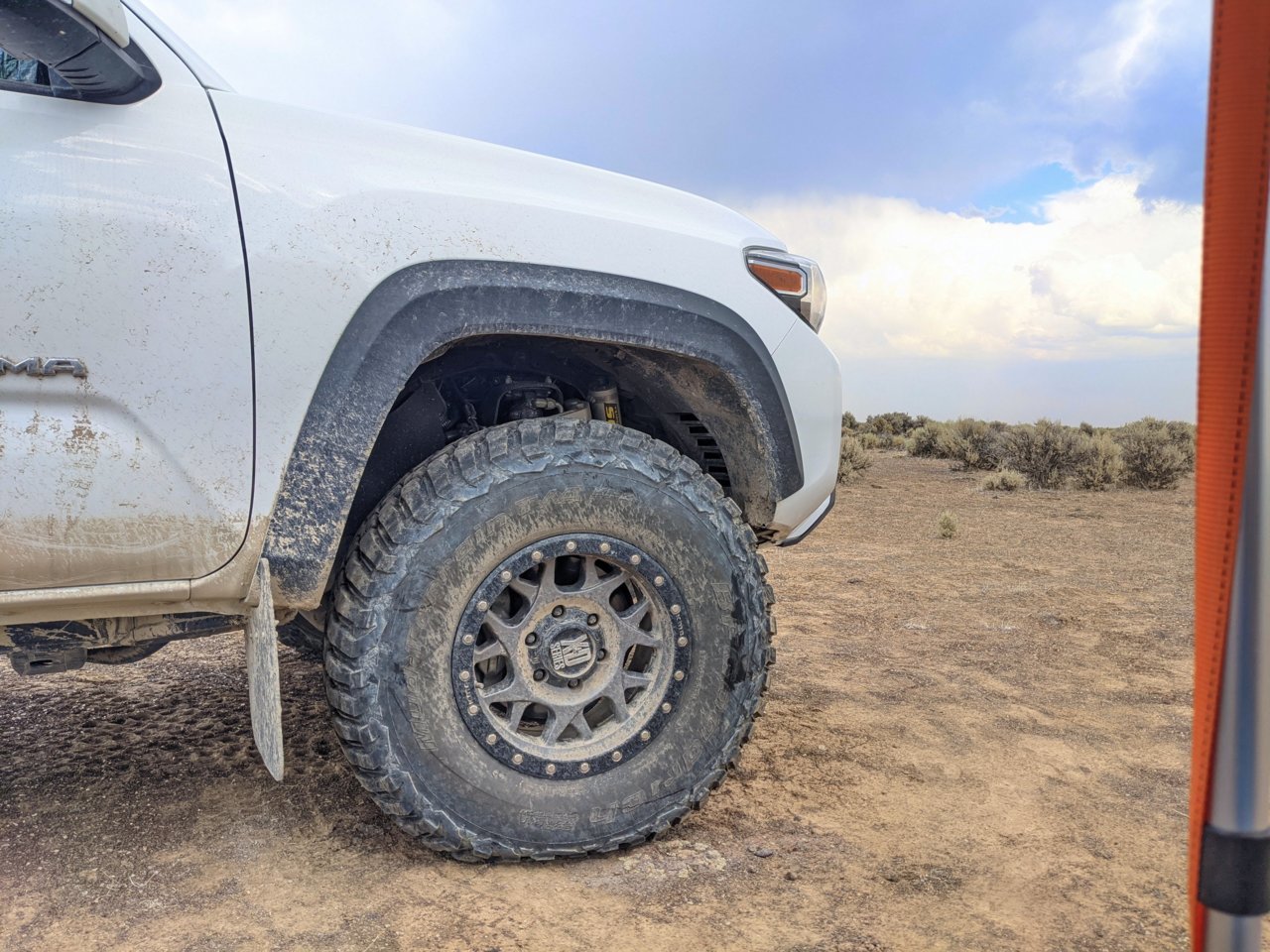

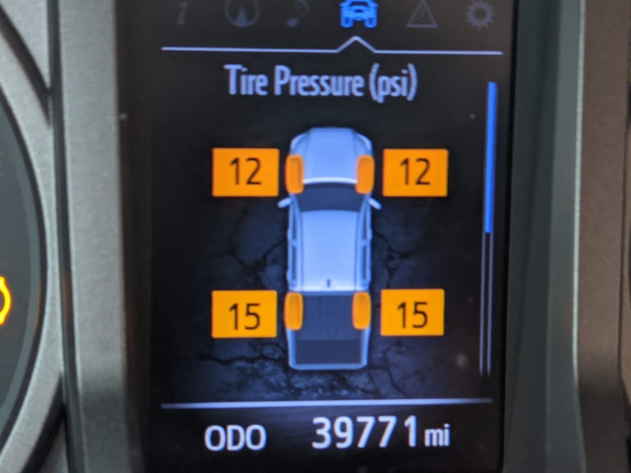

    My bad on the OP, should have looked closer.
    Side bulge is NOT what you are trying to accomplish while aired down, and for several reasons.
    Side bulge in and of itself does nothing to the effect of better traction. The lengthing of the contact patch is what is giving you the added traction. Excessive side bulge also has a direct relationship to tire instability.
    Side bulge is a direct result of sidewall flex, which can over stretch said sidewall material repeatedly to the point of failure due to degredation from built up heat.
    I am certainly not confused by offroad, vs onroad commute. My E rated tires spend their concrete miles at 36psi, while my offroad miles are between 12-18 ps (terrain dependant). The stability of my truck between 12-36psi the doesn't feel any different to me. Traction has been spot on when aired down as my tires are skinny, and sidewalls don't really buldge much at all, yet tread is lengthened appropriately.
    If you look closely, my sidewalls don't really show much change when aired down to 12-15psi. What do your's look like at that psi?
