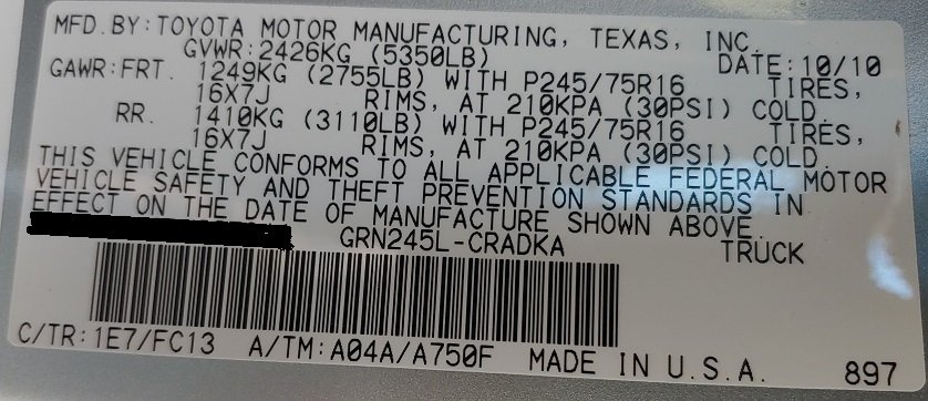

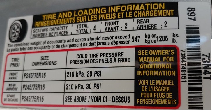

  3. Oct 4, 2021 at 10:43 AM
    #43
    cwadej
    cwadej Ballerina Award winner
    Feb 23, 2018
    #245352
    1,236
    Right Here
    2011 Access Cab 4x4
    really? Which sticker? which line shows the minimum tire pressure to run offroad?
    here's my stickers.
    @Knute
    INSAYN likes this.
