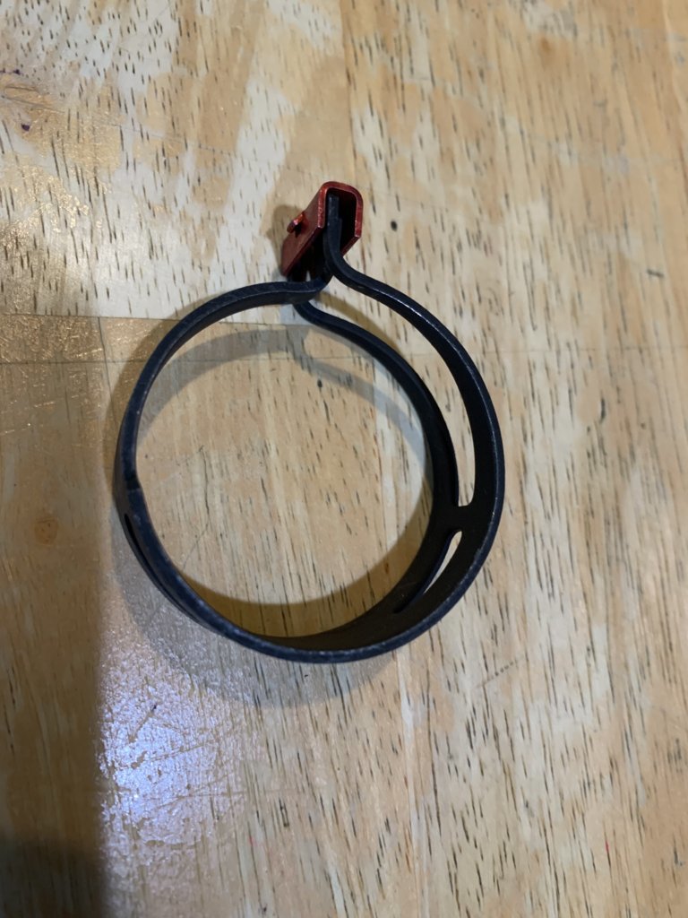

    Ok, I decided to buy OEM hoses and clamps from Toyota. Upon taking a close up look at the clamps (not worm clamps) I'm now wondering if there is a special type of pliers or tool that would make opening the clamps to place them on the hose easier.

    I hate those dang things. Plenty times it’s smacked me. Even with the special tool.

    I know another mechanic who doesn't like those spring clamps either. Sounds like it would be worthwhile to pull the old hoses and clamps off, clean the outlets with sandpaper or steel wool, and put the new hoses back on with the spring clamps (wearing goggles). I should probably get a OEM thermostat while I'm at it.
