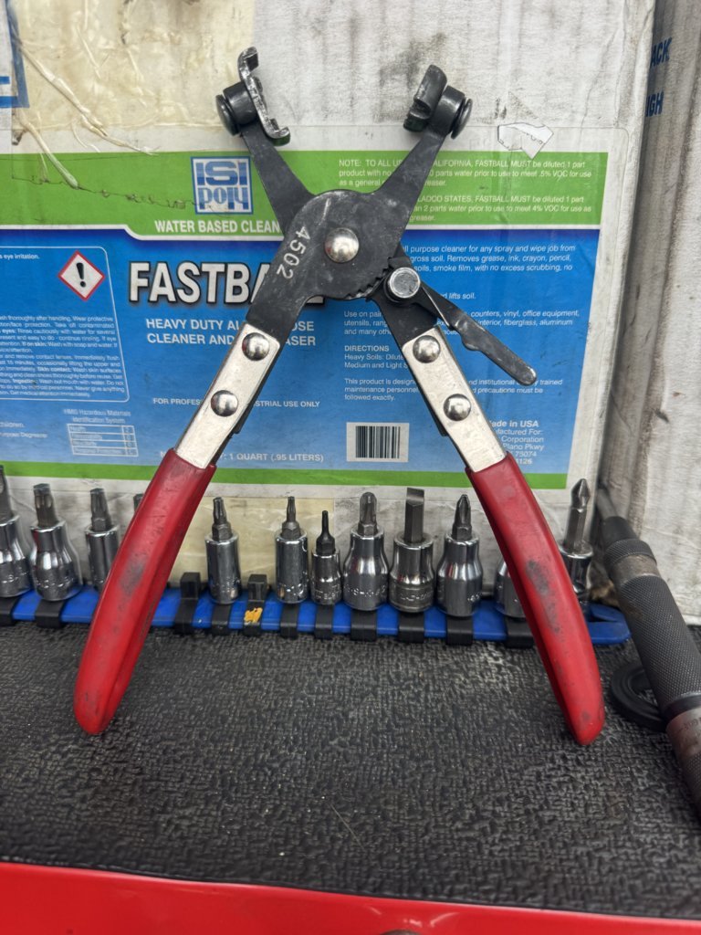

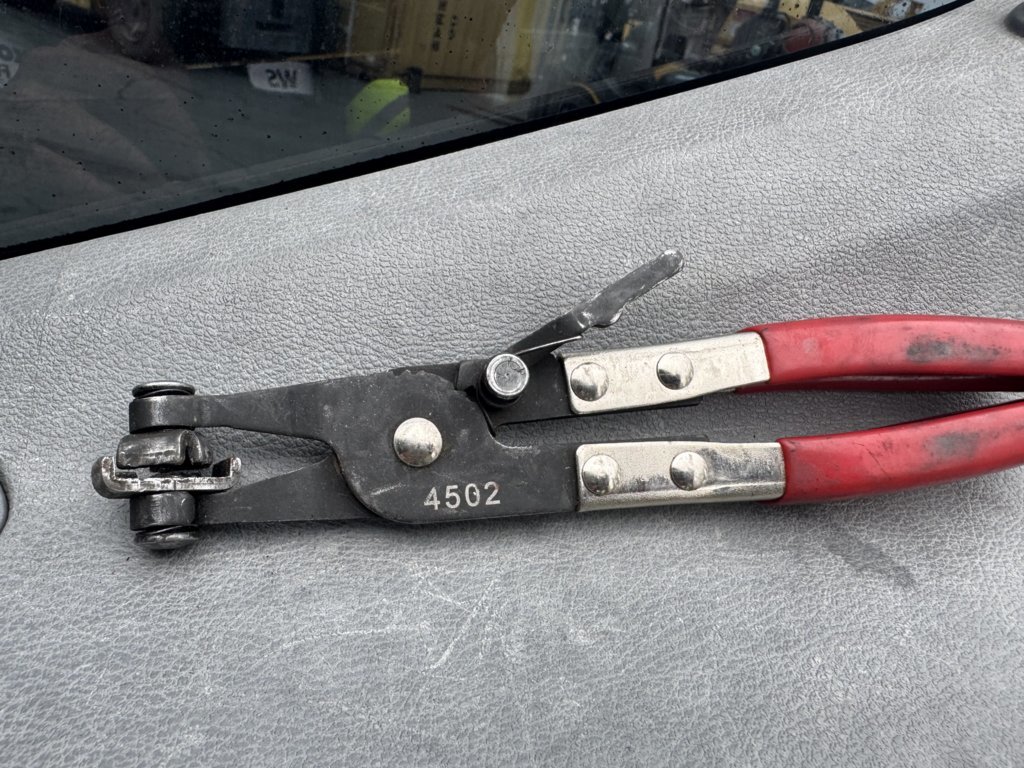

    I bought the whole kit but only ever used this one out of it. Astro pneumatic 4502
    danarello[OP] likes this.

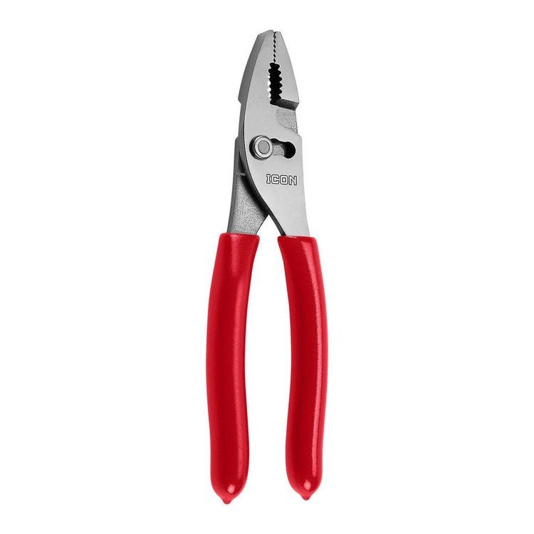

    You can use slip joint pliers. No special tools required for the radiator hose clamps. Just watch your eyes, they like to go flying.

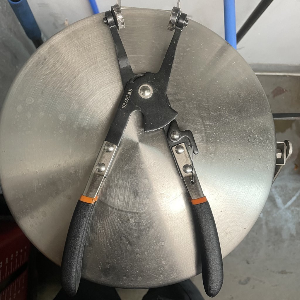

    Since I mess with coolant lines a lot I’ve grabbed special tools for the clamps they have been easy to use and get the job done quicker IMG_5835.jpg
