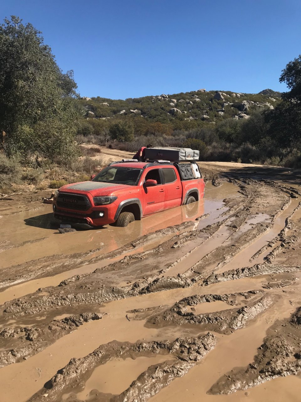

    So I went to this trail with couple friends last weekend
    and this is trail I went though couple times before so I am pretty familiar with it.
    We checked weather and all, but it rained a lot more than expected while we camped over night and water was up pretty high.
    long story short, I got stuck at rut and got pulled out by friend right away so it was in water for maybe 1 min or so. During this time water came into cabin few inches. No meca/ electronic issues just wet carpet for the moment.
    soon as i got home i took out the seat, lifted carpet and dried as much as I could with box fan and shop vac and a lot of towels. I am planning to take out the whole carpet soon as possible to clean& dry.
    Under carriage also has been cleaned with pressure washer and soap.
    How screwed am I?

    Such an awesome pic man!

    did you get any water in the cabin?
    Looks like you're lifted at least haha
