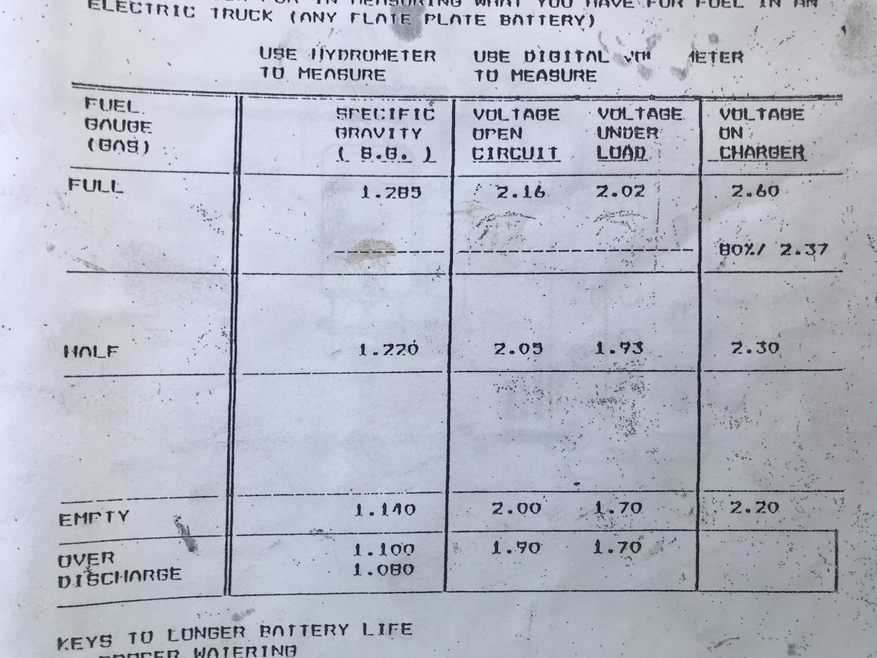

    This is a chart I use to evaluate a battery. A car battery has 6 cells so 2.16 x 6 = 12.96 static voltage, not running.
