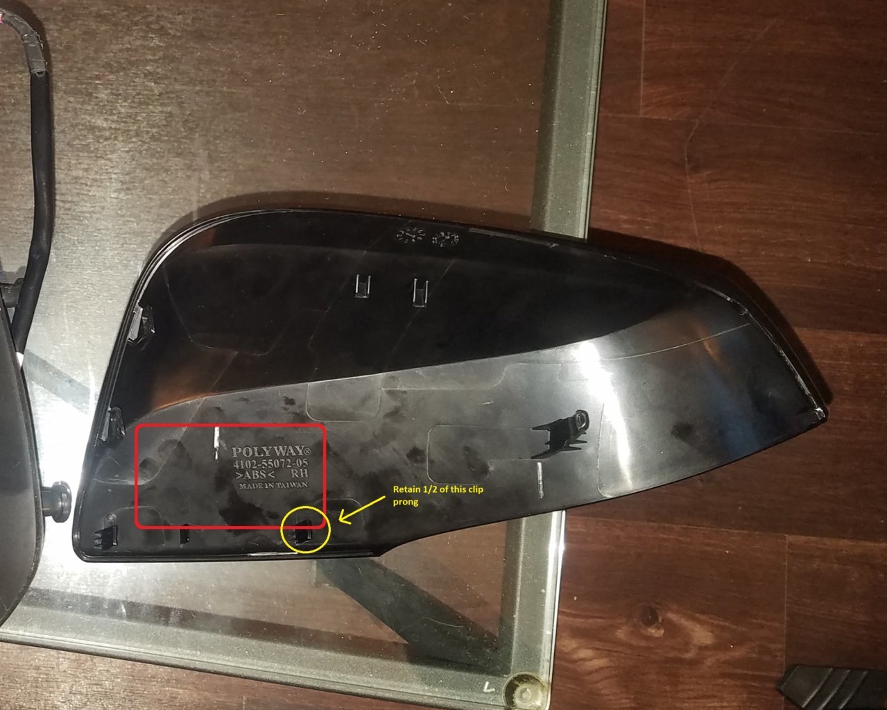

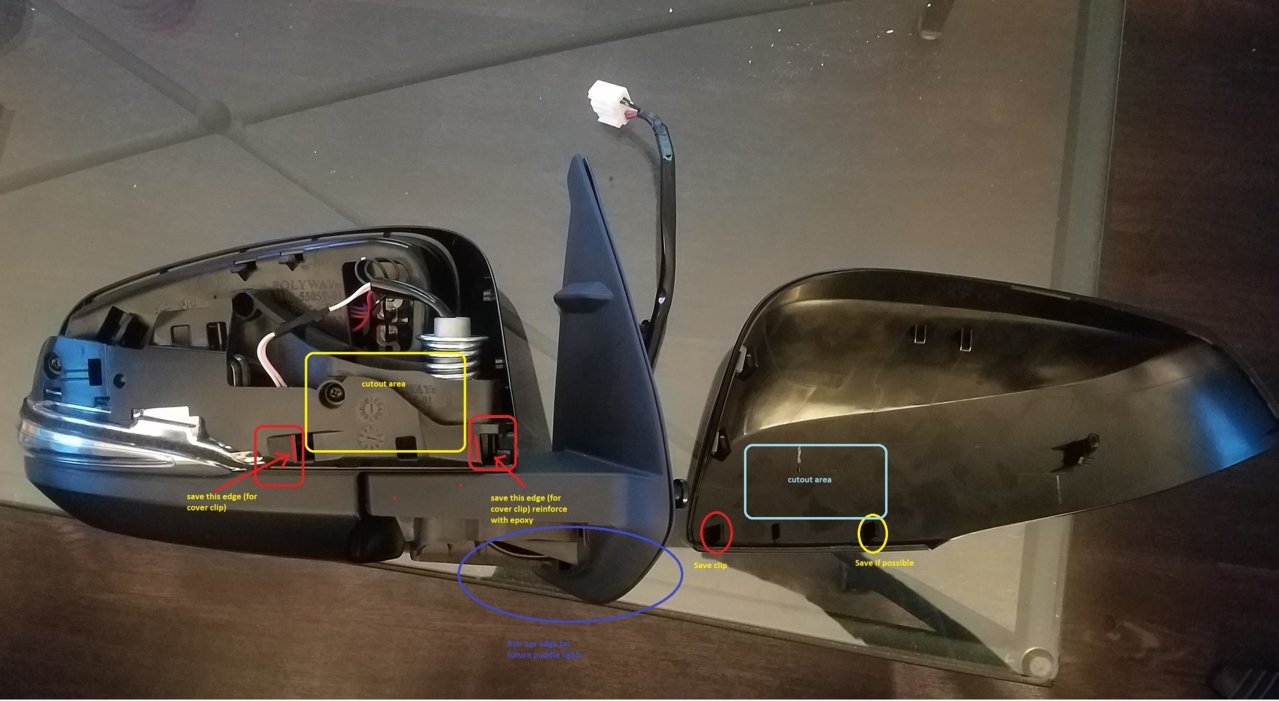

    Thanks! And I didn't get pics inside the cap or housing, though I wish I had. Would of been helpful for others I think to see how the cutout looks from the back of the cap. There's two prongs / clips in there that need to be retained, and I had to shave almost half of the center prong to fit the light and keep it level. But I was able to retain it, and the cover clips in very securely still.
    (Using the Poway replacement mirror housing assembly for my notes here, but this housing won't work for BD S2's due to the configuration of the spring on this mirror. To fit the S2's, you have to go with the OEM housing with the spring assembly located in the underside of the housing.)
    Inside of mirror cap before I modified. This is very close to how my final cuts came out.
    I thought the other day I should have taken final pics of the inside of the cap for those who may attempt this in the future, but did not do so before I had it re-installed. And right now, don't want to mess with success. I'd be super bent if I messed up paint or broke a tab getting them back off and trying to take pics at this point!
