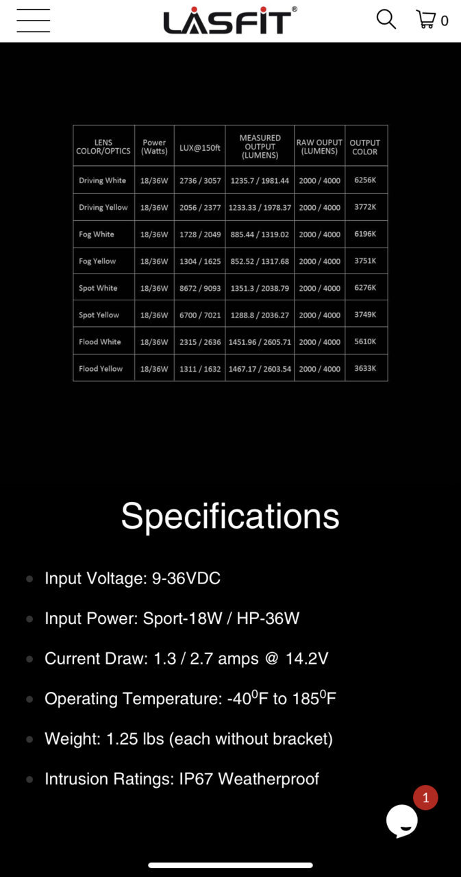

  5. Jul 3, 2021 at 10:26 AM
    #85
    mynameistory
    mynameistory My member is well known
    Jul 3, 2012
    #81862
    1,046
    Tory
    Redondo Beach, CA
    4Runner
    Yes, they're the Lasfit pods. Pretty well known for aping the Diode Dynamics SS3 design language and even promotional material. They're industry copycats, but with poor engineering and execution.
    The hysterical part is that they're not true TIR optics, just projector optics that attempt to mimic TIR.
    No thanks, that sounds like a colossal waste of time. Checking a spec sheet is much faster. Here's one for the SS3. Can you provide one for the Lasfit pods?

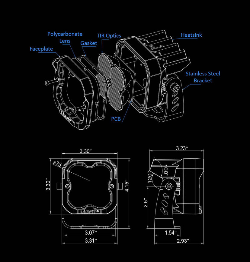

  7. Jul 3, 2021 at 1:58 PM
    #87
    Tcodyw88
    Tcodyw88 Well-Known Member
    May 5, 2021
    #364823
    281
    Cody
    El Segundo, Ca.
    2020 TRD offroad
    Surely.
    Above is the factory specs for the lasfit 3” pods, they’re available on the lasfit website it’s not hidden or anything. I’m gonna guess their lower numbers was gonna be your “told you” but the only lasfit factory parts is the housing and their TIR optics (yes they are true TIR). I designed a new pcb because for the new emitters, I run more regulated current and additionally I have a small fan behind the exterior helping cool the heat sink which helps reduce temperatures internally as well. The invite was mainly because I saw a lot of your posts specifically about DD products so I thought you might be their brand ambassador or employee of some sort and wanted to hahaha when you saw the difference.
    Enjoy your 4th of July

  10. Jul 3, 2021 at 8:16 PM
    #90
    mynameistory
    Jul 3, 2012
    #81862
    1,046
    Tory
    Redondo Beach, CA
    4Runner
    No, I would say that their numbers are too high. For their spot light, they've listed the output at 4000 raw lumens, but it somehow places 9000 lux on a surface 45 meters away. That... violates physics and the inverse square law. I'm not knocking your ability to modify the lights for more output (the fan is a great way to change from passive to active cooling, especially in an enclosed space). That sort of modding is completely out of my wheelhouse.
    Nope, not a company rep or "sponsored" guy. Just someone who enjoys a quality set of lamps.
    You too. Sorry if I came off like a dick.
    Hotwheels85 and Tcodyw88[QUOTED] like this.
  11. Jul 3, 2021 at 11:22 PM
    #91
    Tcodyw88
    May 5, 2021
    #364823
    281
    Cody
    El Segundo, Ca.
    2020 TRD offroad
    Thanks it’s all good and I appreciate quality as well.
    I can’t and won’t speak for lasfit, I bought them knowing I was gonna use the heat sink and TIR optics only for this project.

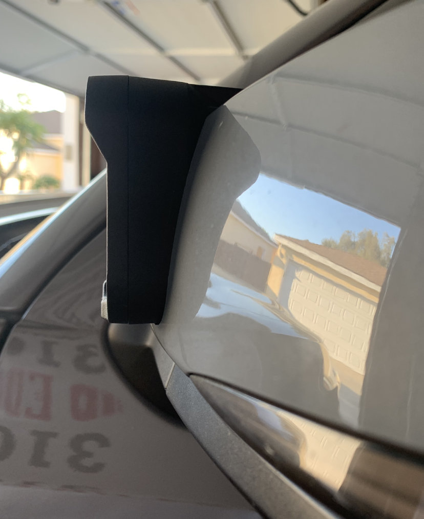

  15. Jul 4, 2021 at 11:51 AM
    #95
    helix66
    helix66 Well-Known Member
    Nov 10, 2017
    #235675
    1,845
    DPRC
    2017 DclB TRDor MgM
    ProGrille,MesoStuff,Tinted,AllPro sliders, RCI ALL skids, BAMF diff skid, KDmaxPro tune, Demello bumper, Warn evo10s, BD s8 & squadrons, Accutune UCAs, Fox 2.5pes, Eibach & Deaver
    Those look amazing, what’d you use to cut the plastic?
    Any pix of how u mounted them?

  17. Jul 4, 2021 at 12:58 PM
    #97
    Tcodyw88
    May 5, 2021
    #364823
    281
    Cody
    El Segundo, Ca.
    2020 TRD offroad
    I believe you’d have light failure issues before being able to drive the heat sink to a high enough temperature to warp the plastic cap.
    But if you ever damage a mirror cap my Toyota dealer had them instock already paint matched for 58 bucks. I know because I bought 3 passenger side caps before achieving the fit I wanted.
    Hotwheels85 likes this.

  19. Jul 4, 2021 at 1:17 PM
    #99
    Tcodyw88
    May 5, 2021
    #364823
    281
    Cody
    El Segundo, Ca.
    2020 TRD offroad
    I think your talking about the mirror cap plastic. First I tried to mill it but couldn’t secure the mirrors firm enough without damaging to maintain straight cuts. I ended up whole Saw cutting the four corners for the rounded shape and hand filed my straights and beveled the interior plastic Edge so the thickness of the plastic wouldn’t be visible just the painted edge. The HARDEST part of this project for me was alignment of the hole in the mirror caps.
    Hotwheels85 and helix66[QUOTED] like this.
