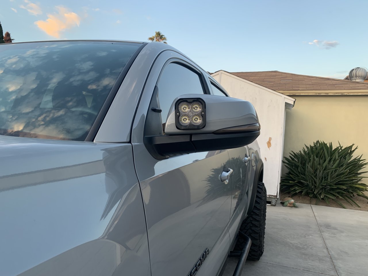

    Do you have a side pictures of your ditch lights?
    Hotwheels85 and Tcodyw88[QUOTED] like this.
  13. Oct 20, 2021 at 11:20 AM
    #113
    Tcodyw88
    Tcodyw88 Well-Known Member
    May 5, 2021
    #364823
    281
    Cody
    El Segundo, Ca.
    2020 TRD offroad
    I think this is what you wanted to see.

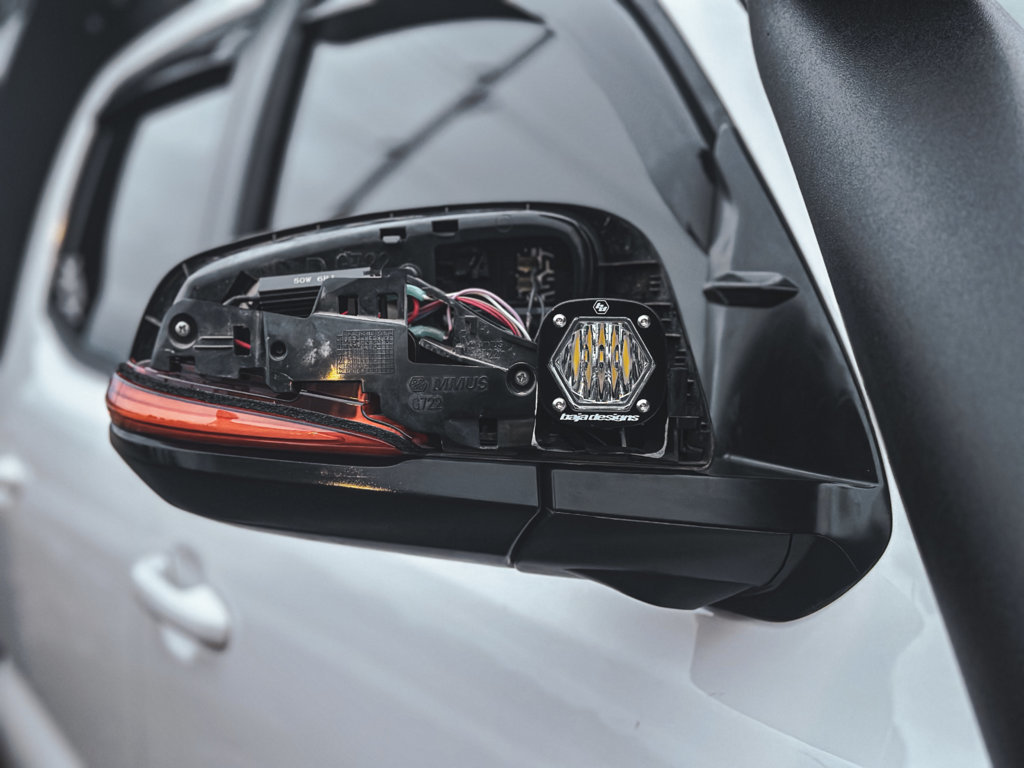

    The Baja S1's fit in the mirror space like a glove! I think these are definitely easier to fit compared to S2's
    Honestly pretty minimal trimming to make them fit, took about 30 minutes to get them mounted and aimed. Had to strip the wire sheath on the baja lights to slide the wires through individually through the mirror grommets. Wires are tight in there but everything fits snug! Time to trim up the mirror housing and get the wiring routed through the annoying door grommets :p
