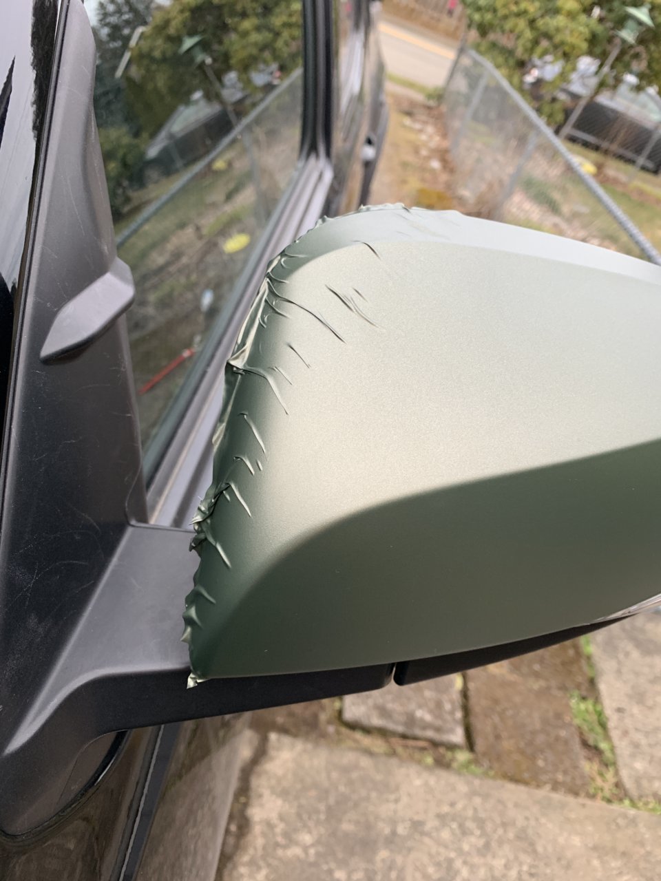

    has anyone tried to wrap thier side mirrors with vinyl film? One piece or two?

    Should be able to do it with one piece, just lot of heating and stretching.

    Thanks, everything comes out great until I get to the backside that is closest to the cab. Need to keep practicing I guess, lol.

    I tried it and the same thing happened. Got frustrated and peeled it off. Told the mirror to screw itself.

    Doesn't look like you're not using any type of heat, should use a hairdryer and stretch it over for that part where it curves. If I'm not lazy this weekend I'll give it a try.

    Also it would be way easier if you took the cover off the truck.
