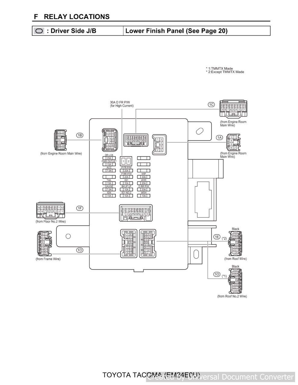

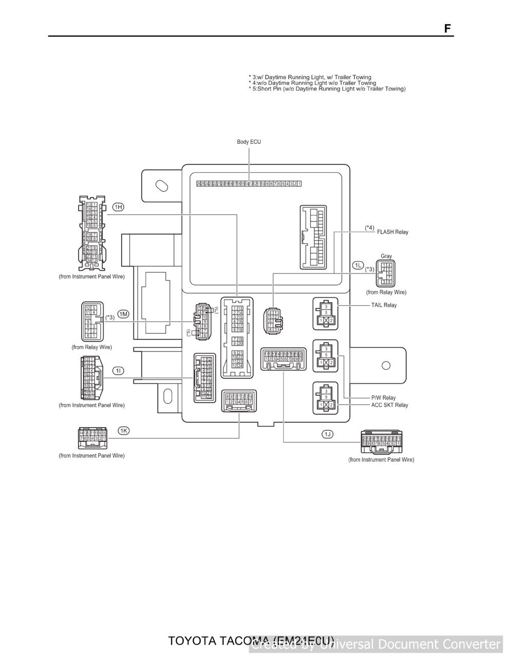

    So the locks cycle when the passenger door is opened or when the passenger lock button is pressed?

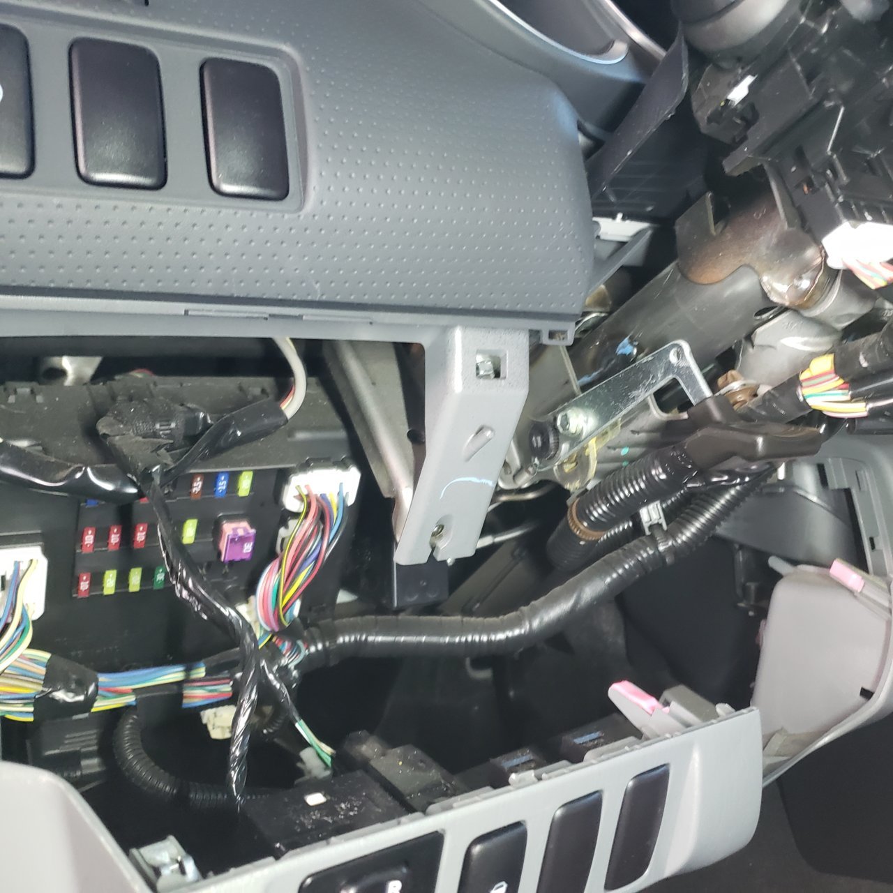

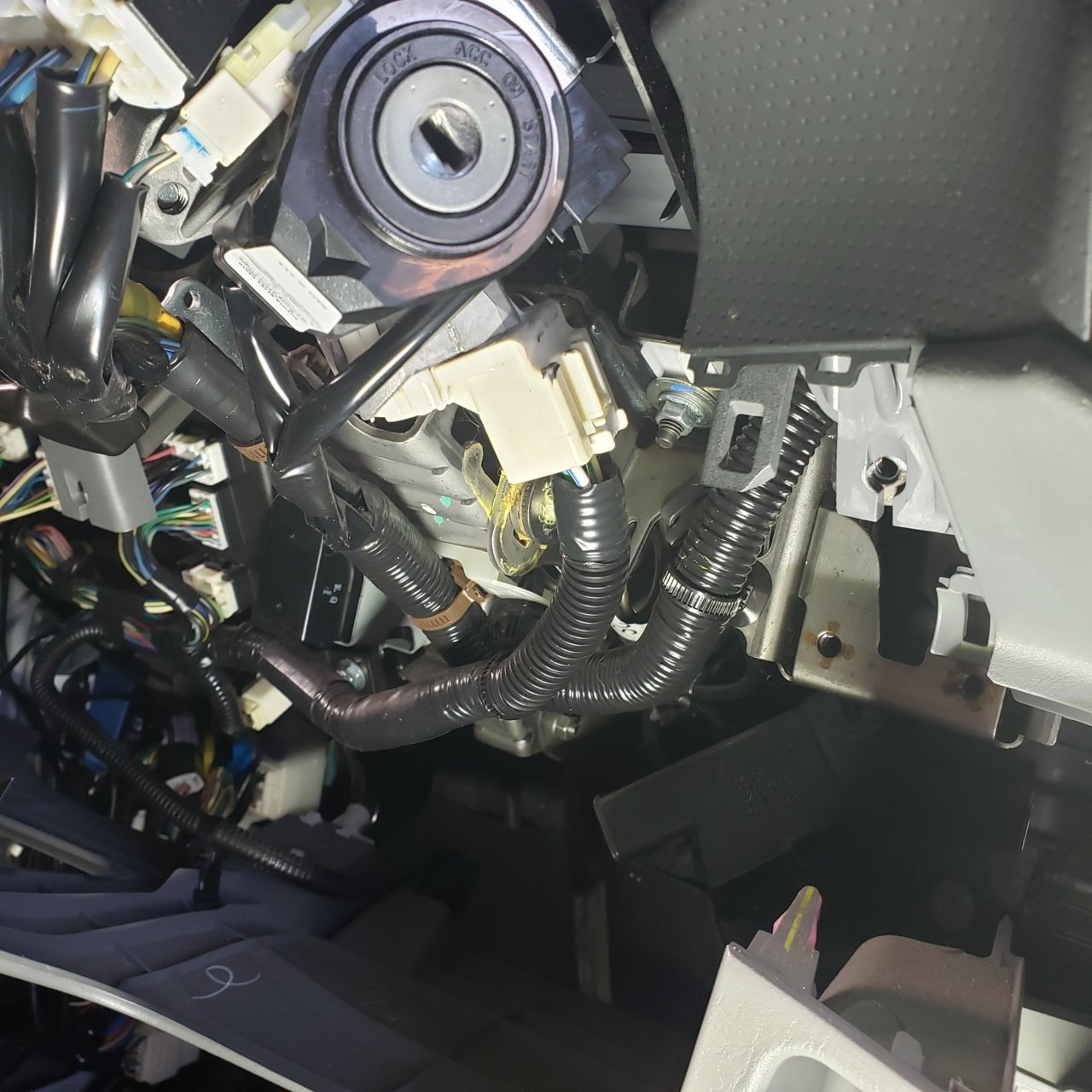

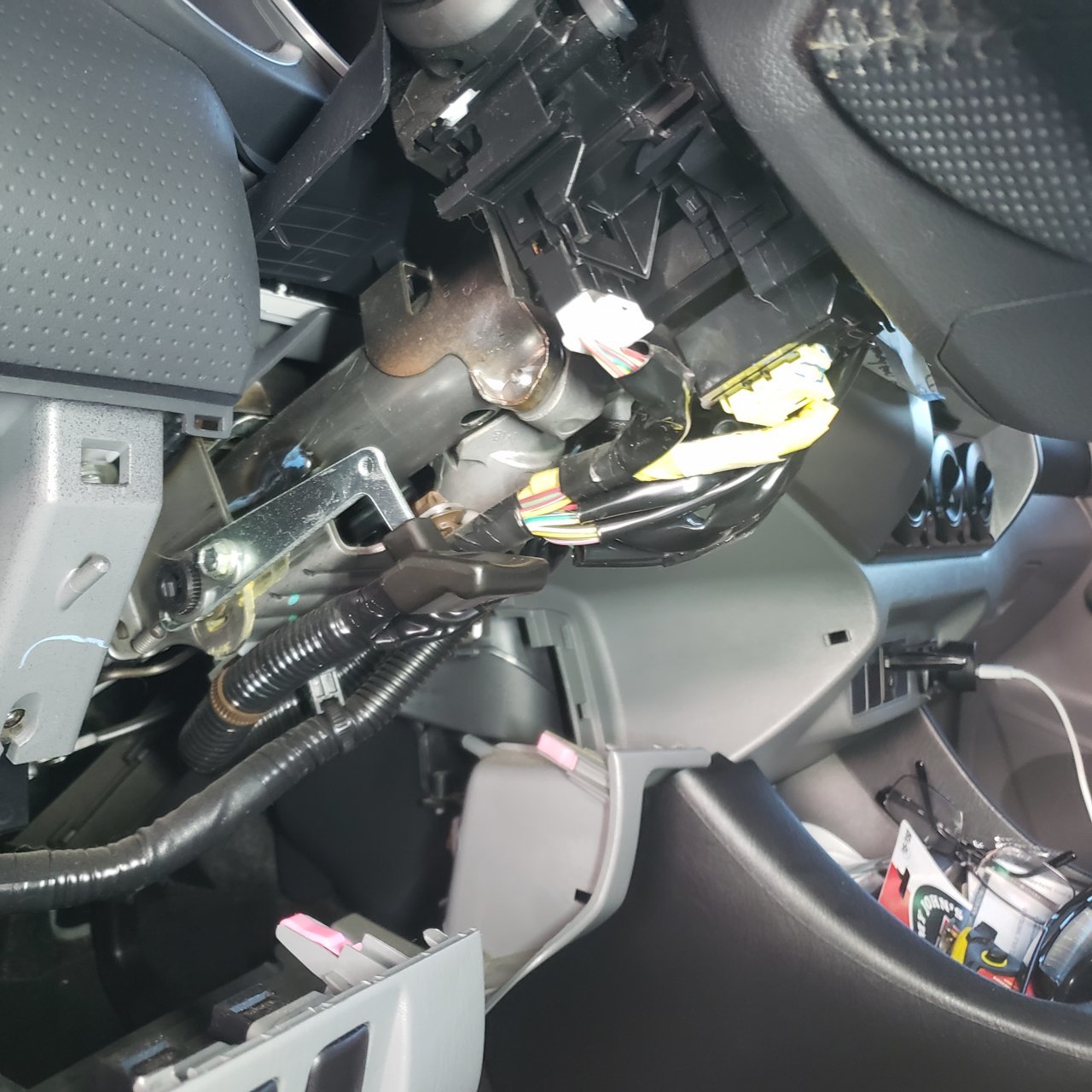

    Plastics came down this morning and unfortunately I'm not seeing any signs of an anyone being in here after if was assembled.20230729_072117.jpg 20230729_072120.jpg 20230729_072200.jpg
    Unless its shoved way up behind the instrument cluster in an area I can't see very well. Did take a peak behind the cover for the door harness going to that door and didn't see anything out of place. I have the harness a pretty good pull and stretch around the entire range of motion and that changed nothing.
