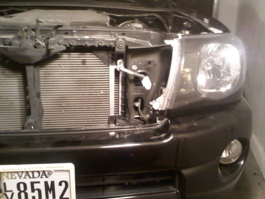

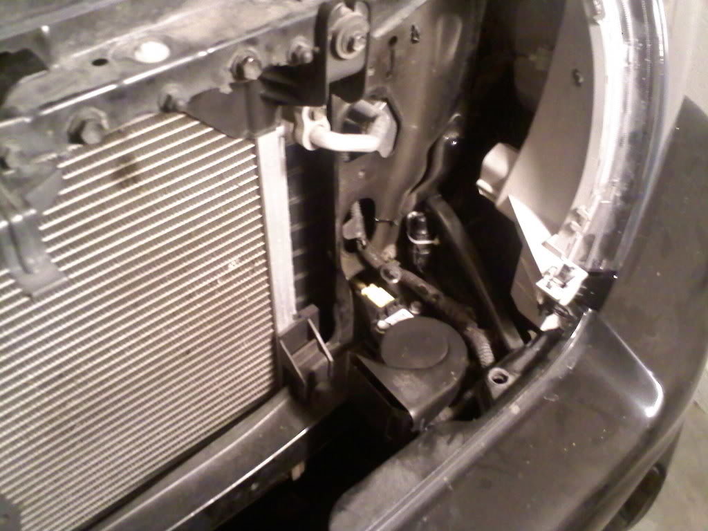

    I didn't flip mine upside down but I did separate it from the factory wiring that is shared with the horns...
    my sensor is in the OEM location while my horns are here...
    where did the horns go?
    there they are...lol (BTW...this picture was shot prior to separating the horn and temp sensor module...if you look closely you can see the temp sensor zip tied just to the right of the horns...)
