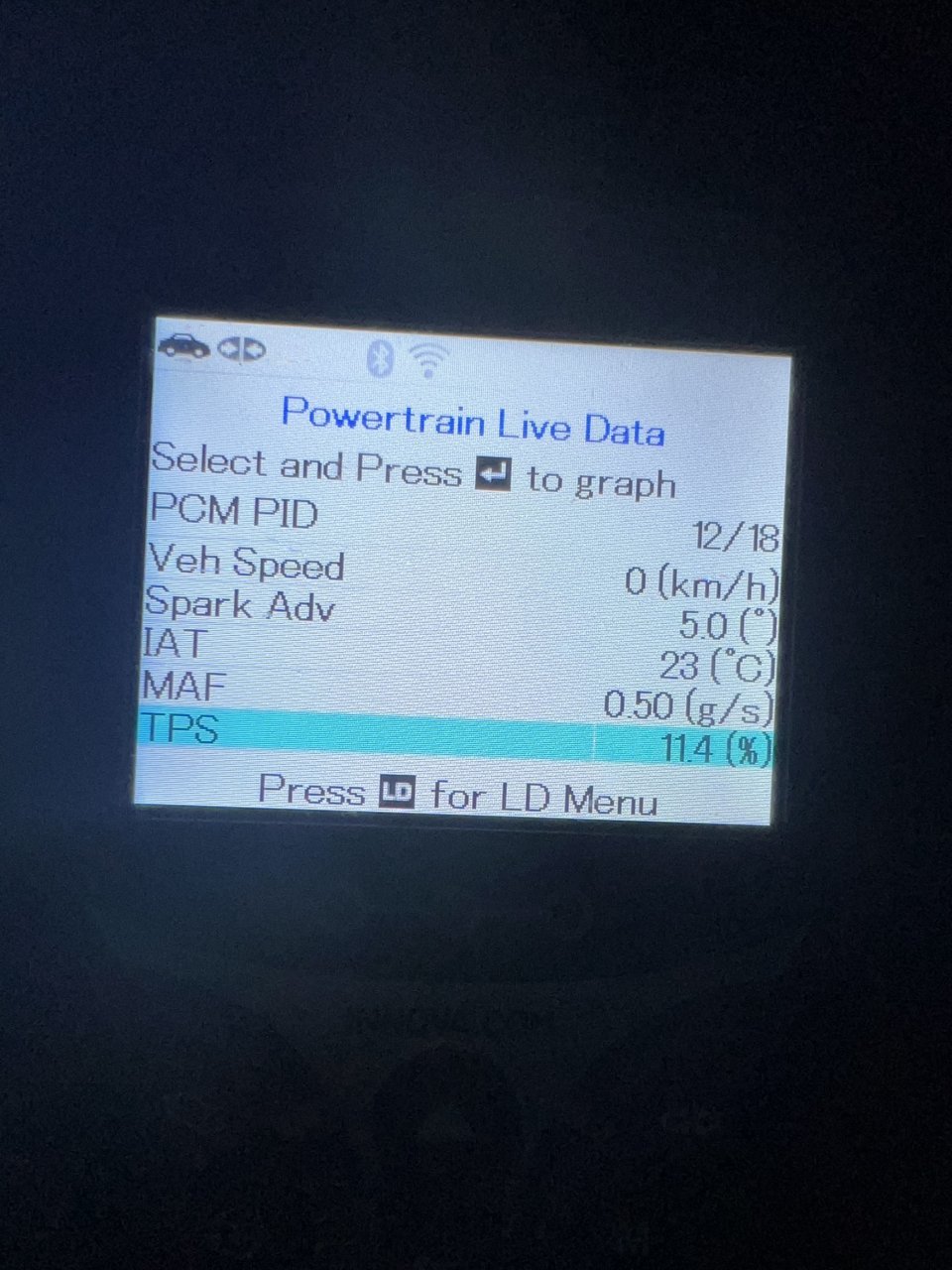

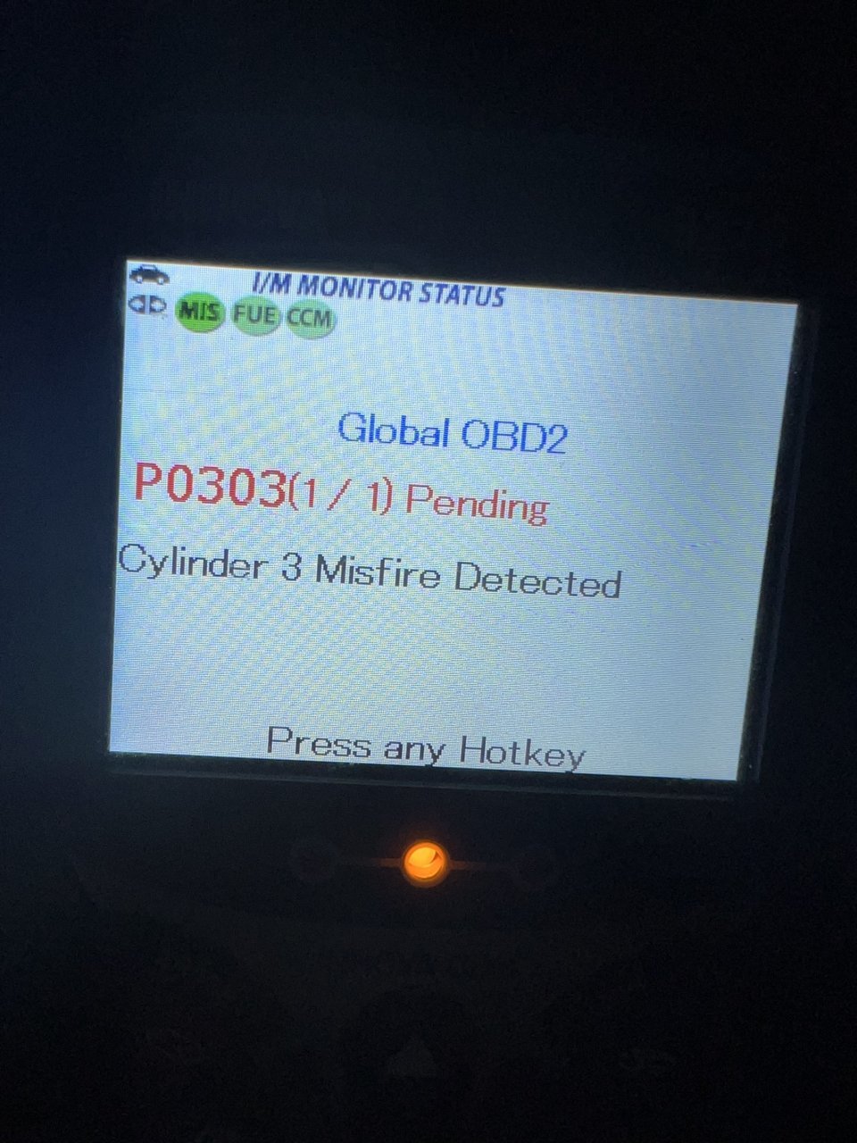

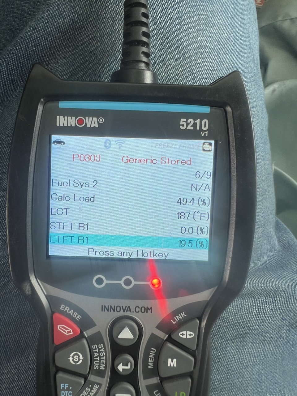

    Can anyone please help. I have a 1997 Tacoma 2.7 5speed 4x4 300,000 miles . I have never had any major problems i was trying home about 30 miles and then I stoped at Walmart and when I started to leave i had a miss fire and this is what i have come up with so far I have a Misfire #3 p0303 and we have done a compression test injector on number three ,both coil packs spark plugs , plug wires,. smoke test ,check compression,cat seems to be good. I have took it off and straight piped it to just check.ive checked oxygen sensor’s .i can clear code and i dont show misfire code when idling but I can feel its still. Put in gear and start to go it will pop up soon as I start going. Ltft is 19.0 I have noticed that sometimes it will stay in open loop and finally go to closed loop after a little bit but when I put on the gas it will say open loop fault some times and sometimes it will say open loop drive and sometimes it may say closed loop. I can’t figure out what’s going on. Coil is pulsing and firing strong. I took spark plugs out and it looks like #3 is a little darker. And I’ve changed spark plug with 3 different brands just to be sure it wasn’t the plug. If anyone can please help I would appreciate it. C7C6536A-671E-44F4-BABE-E42C78F079C4.jpg4196F8FA-5100-4687-BBAA-E10BCF667243.jpg 2AC86CDE-7FFC-41C8-89CA-8F46AD23BA9F.jpgC7C6536A-671E-44F4-BABE-E42C78F079C4.jpg

    148 147 148 148 changed the injector and then put another new injector because I thought it was faulty but same results. No coolant leak and did straw test on cylinder and nothing was in there. And I just put new spark plugs in again today and it’s running a little bit better but still missing the spark plugs I took out was ngk and I just put champions in today. When I give it gas driving it my scan tool is saying open loop fault for fuel and I let off and it will go back to closed loop
