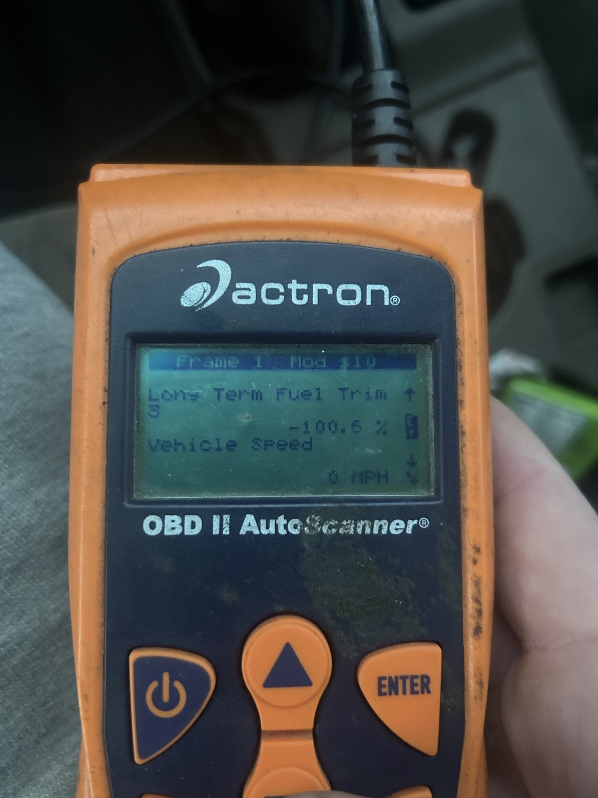

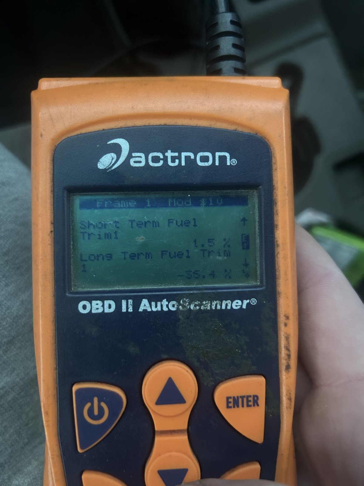

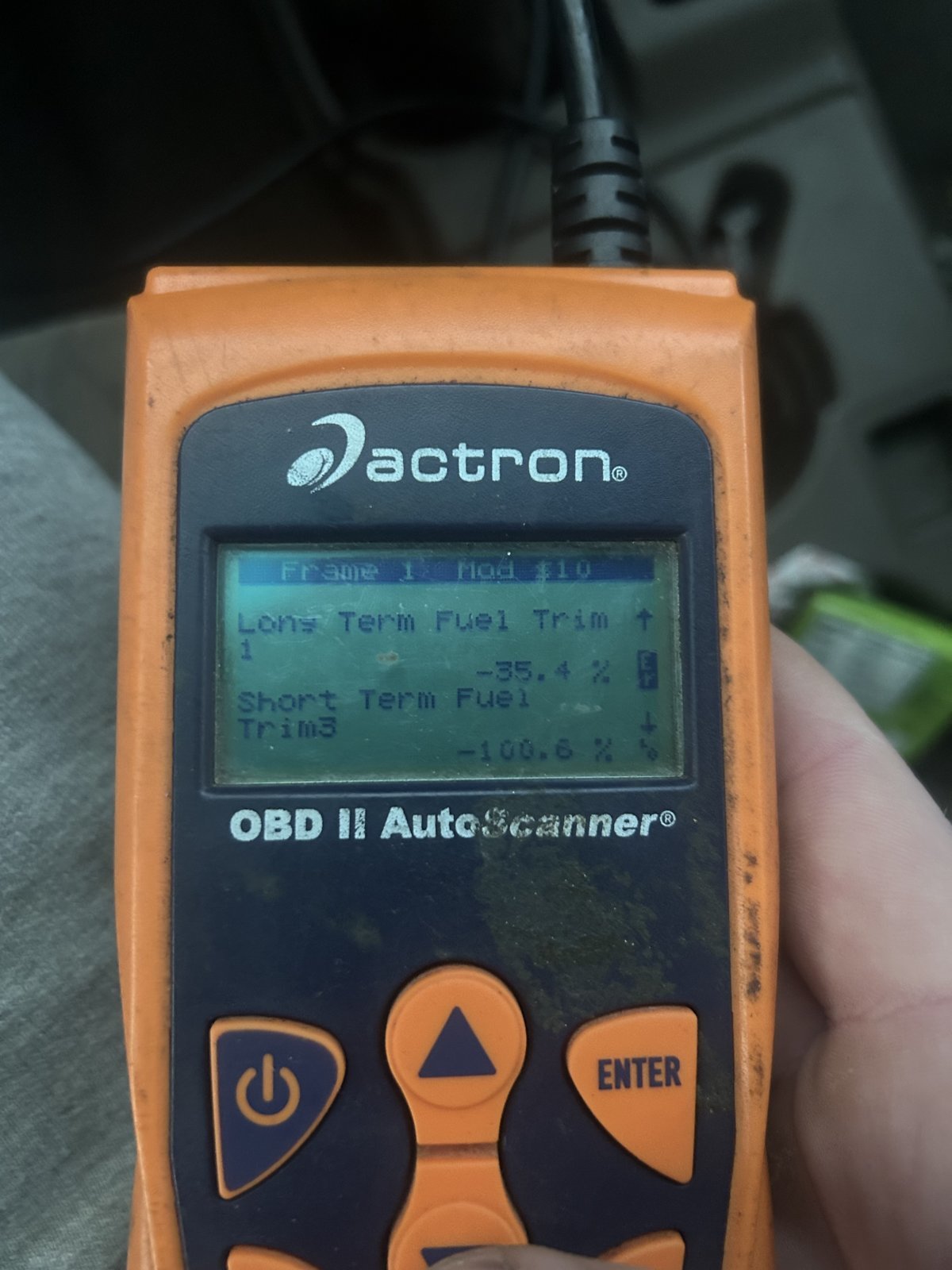

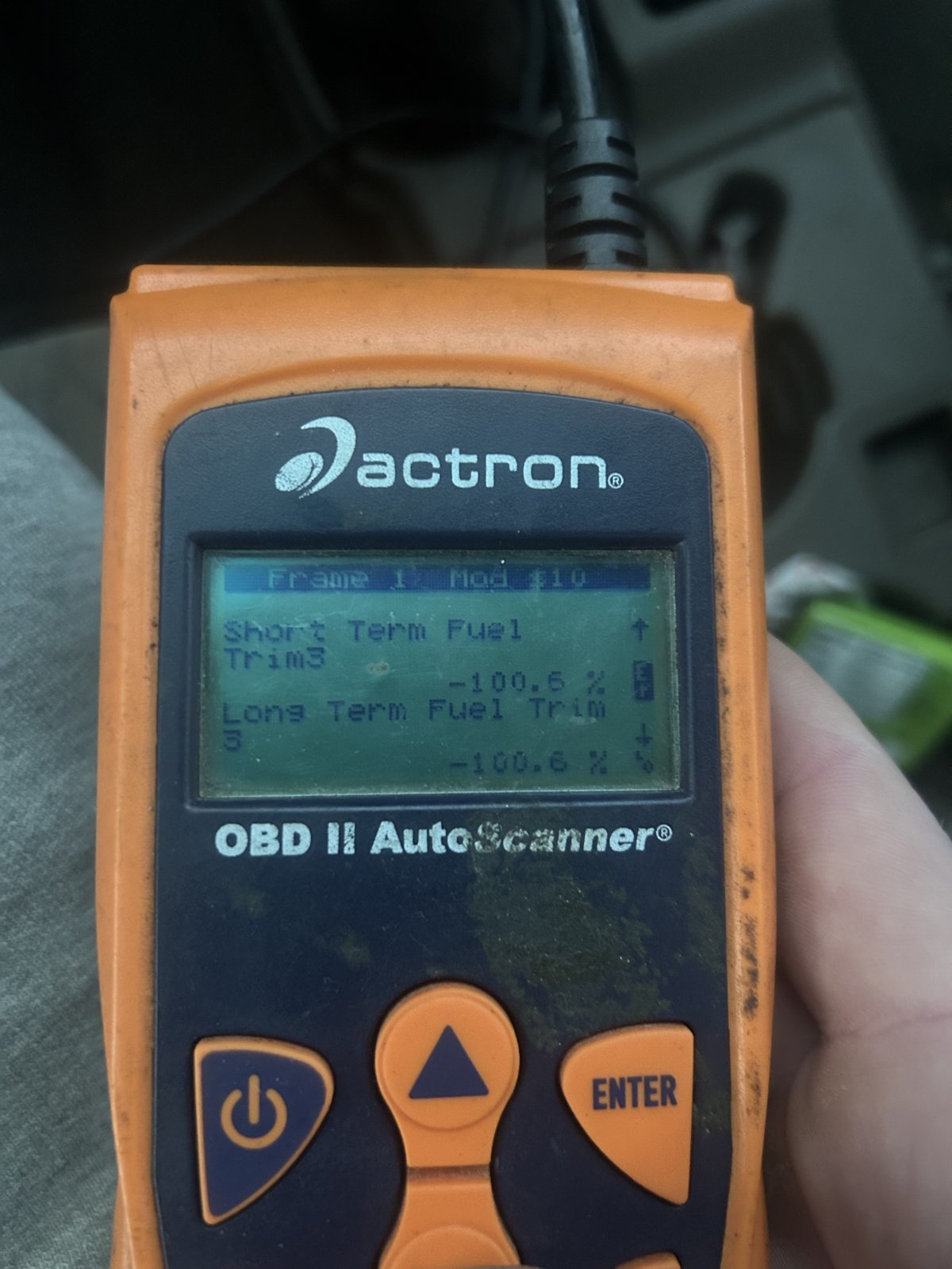

    I have a misfire in cylinders 3 and 4 (P0303, P0304), its running really rough. I also have had a persistent P0172 code. I have replaced all sparkplugs, both O2 sensors, MAF (its a denso), and one leaking fuel injector. I tried switching the cylinder 3 coil pack to 5 and its still popping the same codes for cylinders 3 and 4.
    Coolant levels are good and Compression is 150 in all cylinders. I have used my code reader and gotten the following data:
    Short Term Fuel Trim1: 1.5%
    Long Term Fuel Trim1: -35.4%
    Short Term Fuel Trim3: -100.6%
    Long Term Fuel Trim3: -100.6%

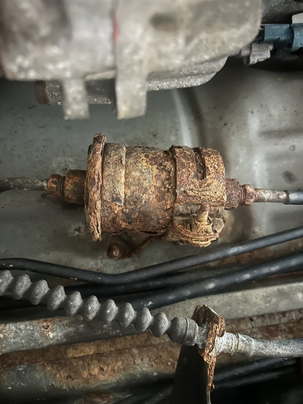

    Kinda at my wits end here, have no clue where to begin. My mechanic suggested it was a bad ECM but that seems unlikely to me. I also have a really rotted fuel filter but I don't know if that would fix it. Any advice is appreciated.

    Those fuel filters are like $30? Definitely should replace that. No clue if it will resolve your issue but that thing looks quite toast and that is mostly a simple job, though the rust makes it difficult. Take your time freeing up those nuts.

    Disconnect the front O2 sensor and see what happens. Check the coolant temp reading on the scanner as well as the Intake air temp sensor.
    I have never seen fuel trims above/below 35%. I didnt think it was possible. I would put a set of known good injectors in her and go from there.

    Would definitely work on that fuel filter, start spraying the fittings now to help get them unstuck. I can't imagine it's helping anything.

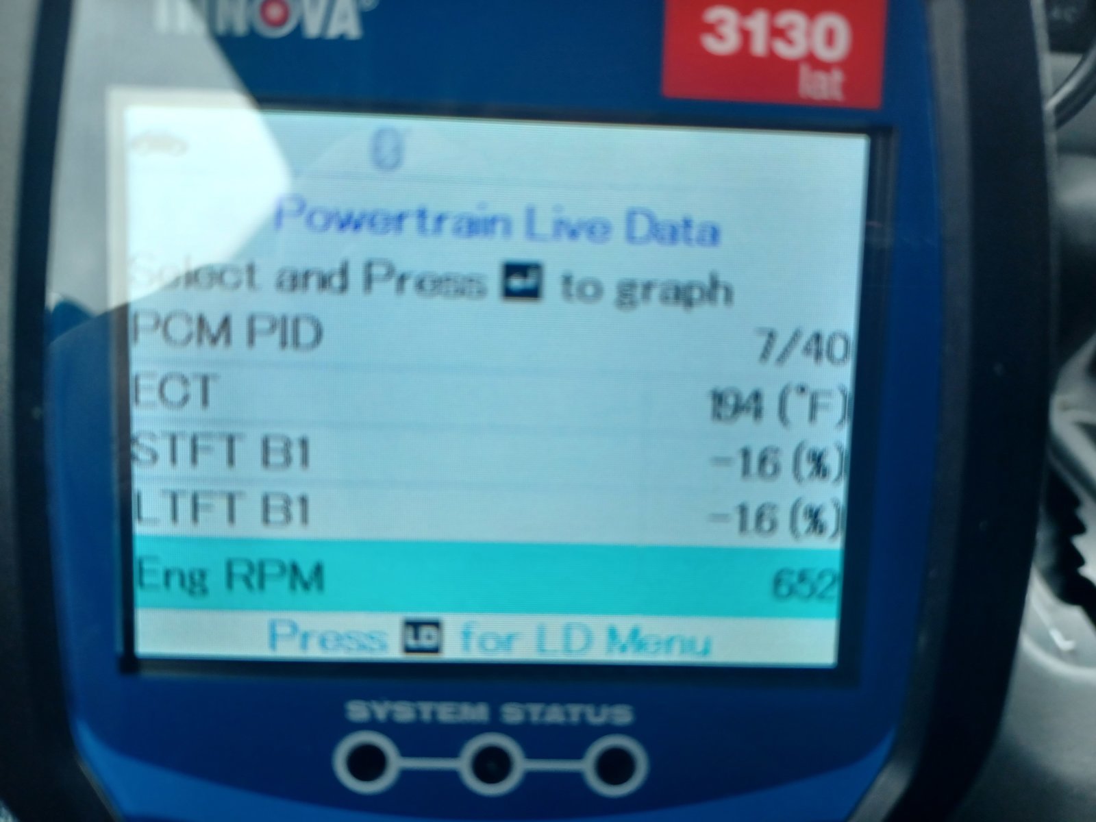

    Are the new 02 sensors oem? An did you try the disconnect method on front 02,as mentioned earlier? Those readings are way off onthe 2nd readings for STFT an LTFT..
    Id swap 2nd 02 sensor out an see of it balances out..or changes dramatically..
    I just checked mine ..an a good steady low - % at warm idle.
    I also checked the readings for voltage at 02 sensord an did the other tests the scanner can do to test them. Theres also a graft that can be monitored on them on most scanners.

    Negative fuel trims and misfire means it's detecting rich and pulling fuel. Could be actually too much fuel and misfiring, or actually lean now and misfiring. Fuel pressure? Injectors leaking/need cleaning? Spark plugs gapped to spec?
    I'm inclined to think your "#3" fuel trims are fake and just a result of the scanner you're using. AFAIK there are no first gens with multiple trim banks, there should be one short and one long, which I thought capped out around +/-20-40% each.

    Are you still having a rich condition? If so that needs to be addressed first because you will have misfires if the PCM can't properly control the air/fuel ratio.
    You can ignore the long and short term fuel trim 3, they aren't used.
    Long and short term fuel trim 1 are what you need to look at.
