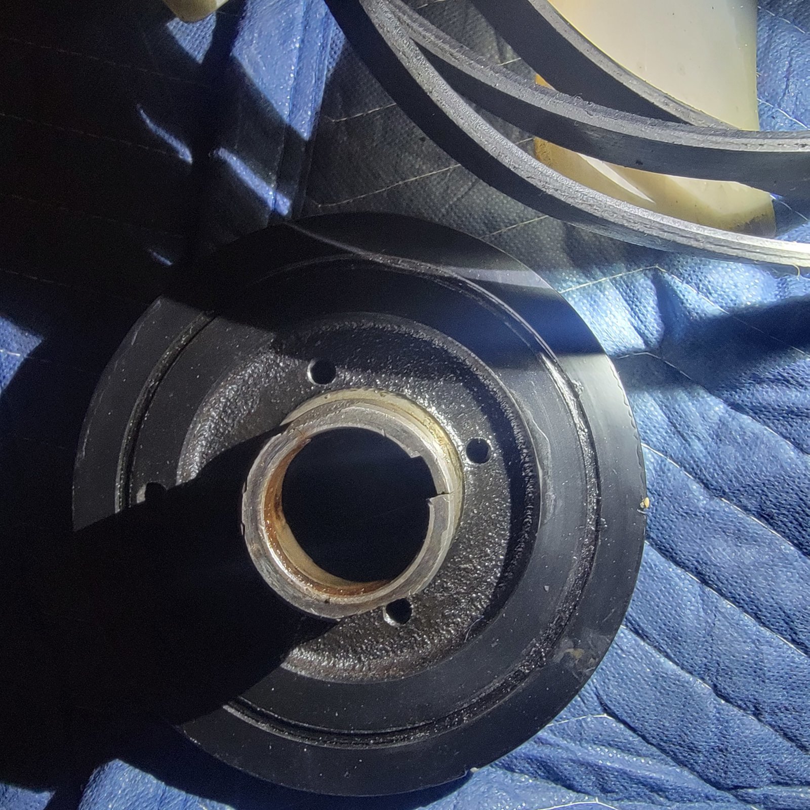

    Hi first post I have a 99 tacoma 2.4l with 441000 miles it has an oil leak on the harmonic balancer seal after pulling balancer and replacing seali noticed a Crack in the balancer I have new part to replace. does the balancer just slide in? I noticed a small piece missing in the groove of old balancer should I look for it in motor or just replace oil? would this be the cause of misfire ( p0301)? compression is fine I did plugs ,wires and injectors. had plenty of power but oil.leak got progressively worse. any advice would be greatly appreciated thanks

    The P0301 not related (anything is possible!!!)
    the steel to steel (and woodruff key) area not likely to fail
    It’s the ‘rubber’ part in between the inner and outer rings of HB fails
    Creates a wobble
    I would replace HB if already removed
