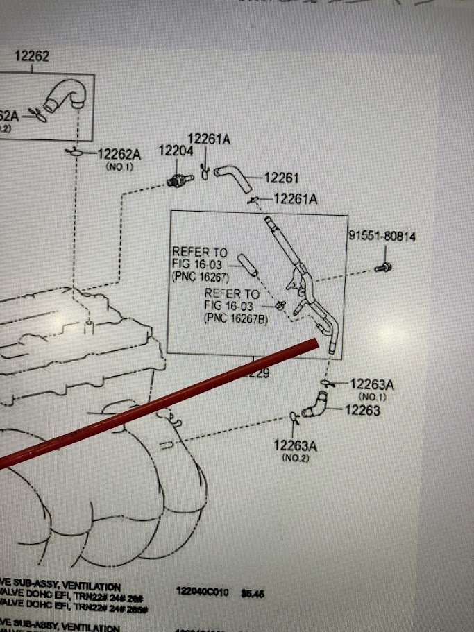

    A friend and I just did the timing cover on my 2tr two weeks ago, We had the same thing happen as you did, wicked misfire across all cylinders. Engine would start up, rev high ( like 2500 rpm ) try to settle down to normal but just could not do it. The whole engine was shaking violently anytime it was below 1000 rpm. Another thing we noticed is that I just **could not** keep it revved up to 1500 rpm, it was so touchy / sensitive I could not hold it there.
    Our culprit was "un-metered air". We had a vacuum leak in the form of an un-plugged hose. The little bugger that's on the back of the air intake on the right hand side of the engine. The one that goes from the PCV check valve to the hardline that's bolted on the back of the head, and then goes back into a rubber line that connects to a nipple on the intake.
    I know you said you already checked all hoses, but I thought I did as well. I had my hand on that damn hose and swore it was connected. My buddy was the one who triple checked it and found that was the culprit.
    We started to head down your path as well. Checking Timing, checking injectors, electrical connections, checking the Cam and Crank sensors etc...
    AP1GczOV-CLq0lFvDITLQRsGGTSgnpzjf2BSXnRu_582eaae06d24052fe1c8b100a27a559c01f05b9b.jpg
    So that's the air line, It was disconnected from the intake right at the last hose clamp ( # 12263A ). Its hard to see/reach, and I found the hardline its connected to gave me a "false positive" of it being connected since I would have bet my life on it being connected. I remember trying to wiggle it, but that stiff line made me think the other end of that little elbow was connected when it wasn't
    Hope this helps, and that you get your truck back on the road.
