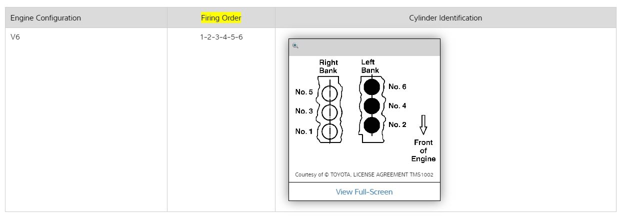

    Sure sounds like secondary ignition based on your description, did you change the correct coil? #6 is drivers side rear.

    One thing that many mechanics don't think about when it comes to diagnosing a misfire is to also check the companion cylinder to the one indicating a misfire. There are times where a companion cylinder miss will actually trigger a code for its match. The way to find the companion cylinder in a V6 or V8 configuration is to place the first half of the firing order over the 2nd half. In this case, as noted above, the firing order is 1, 2, 3, 4, 5, 6. So you would get
    1, 2, 3,
    4, 5, 6.
    #6 companion cylinder is #3 cylinder. What a companion cylinder is, is the cylinder that is in exact opposite of the other cylinder's stroke. So when #6 in TDC of the compression stroke about to fire, #3 is in TDC of the exhaust stroke.
    Now I'm not saying that it IS the culprit, but something to consider taking a look at. As DM93 stated, having a bad coil from the aftermarket isn't unheard of. I would get a Denso coil to replace them if it were my truck.
