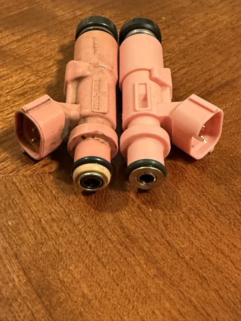

    Now the real journey, finding the correct fuel injector. I needed this running now because the condition had gotten worse (rough condition at all times of running, not just hot start. Every shop in my area told me they had the part but upon inspection they were different units. No seal on the tip, no chance of them sealing and working.
    Frustrated by the idea of a $160 part that may or may not work (most likely not) I went and purchased a full set of remanufactured injectors from Rock Auto. These are the parts I purchased. Upon arrival I received the EXACT SAME incorrect injectors, these are what they looked like:
    I sent these pictures to Rock Auto and they said they should work just fine. How? They're a different length and attachment?! Thinking I was just being an idiot and apparently these are OEM remanufactured replacement, I installed one injector.
    It proceeded to SPRAY FUEL LIKE A PISSING DOG from the mounting point to the rail. What the hell!

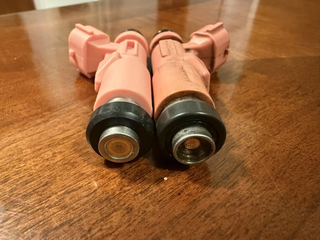

    Then I went on the hunt. After being burned I wanted an injector that at least looked the same as mine, like yesterday. I need this truck to be running. After shopping around and being impatient, I bought these from Amazon. I know I know, Amazon parts, but I was getting desperate here.
    I replaced number one injector and IT WORKS. THE PUPPY PURRS.
    Planning to find a proper OEM remanufacture in the future but this is my tale. Thanks for all of you that suggested injector, I wish I had listened to you sooner.
