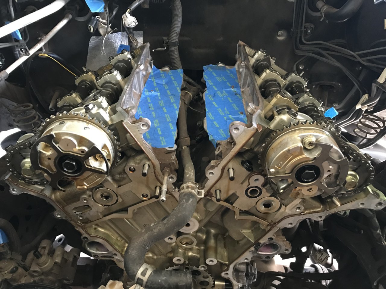

    Took me last two evenings after work just to clear out the garage to make room to work LOL!! Got the charger and most of the top stuff off and I can clearly see down cylinder 6 intake runner and valve is stuck open, all other valves closed - couldn't get a clear picture with phone. Should have water pump and timing stuff off by end of day - so if I can find locally the special cylinder headbolt driver socket then heads should be off no later than Monday. Some side notes : seemed to be a lot of blow by oil in supercharger and intake runners - I do have a oil catch can though.

    Looking at the cam for that valve, is there any obstruction on the top side?

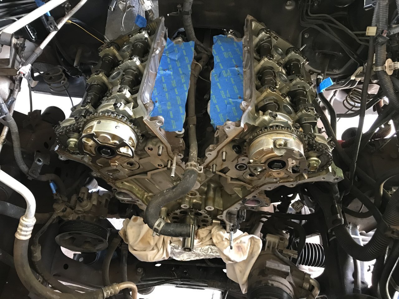

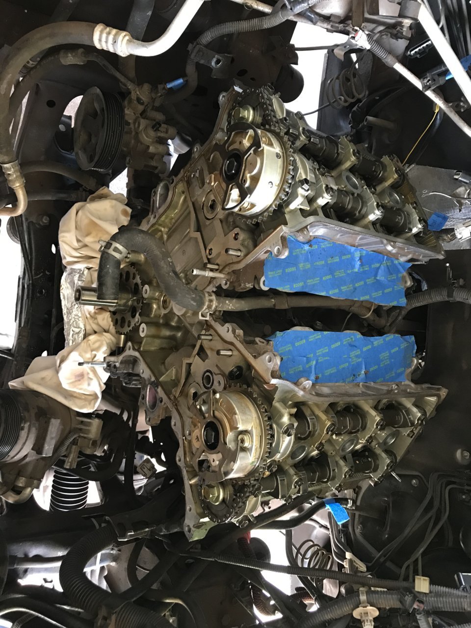

    DD718E91-A671-4E5B-94B9-BF00CDB0E365.jpg 61E7E9AA-F05E-449D-B31C-E83AB410EE95.jpg
    So been doing what I can the last 3 days, my snap on head bolt bit arrived late this afternoon so that's a plus. Nothing on top side of cams show blockage or broken spring - heads will be off soon. Timing chain was nice and snug and main tensioner #1 showed no signs of extension or wear, small light scuffs on chain guides. I'm at 109,000 miles and 85,000 of those were with supercharger. Would you guys change all the timing stuff out at this point? Taking my time and blessed that I have not had any problems, issues, or broken bolts LOL! Here's some pics of progress:

    Looks like time to pull the cams then.

    something is holding the valve off the seat..............
    if ALL the valve gear is OK .............something mightily strong would be to resist the spring closing the valve
    UNlikely the valve will be reusable be certain to ‘ V ‘ block the valves when U inspect them
    clear photo of head B4 !! disassembly
    take close up of head at combustion chamber#6 !!!..............real close
    maybe U can see whats holding valve open
