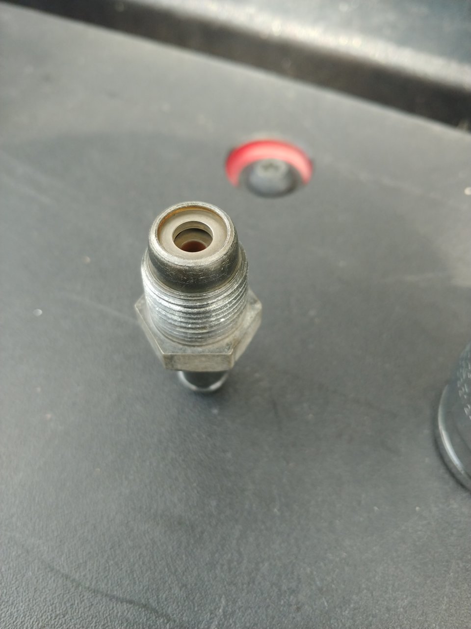

    Just cleaned pcv valve and noticed It does not completely seal when check valve is closed. Also, I was running to cold of a spark plug - originally the part number for the ngk iridiums spark plugs on the supercharger tips and tricks thread was wrong (now updated). Going over everything with a fine toothed comb.

    I was going to ask about the PVC valve. Are you running a catch can? The cheap ones work just fine. Just get one with the brass filter.
    IIRC on the 1GR cylinder 6 is the cylinder that gets all the gunk from a failed PVC valve.

    Yes, running a catch can. When pcv valve is shut should it be 100% closed? I sprayed and cleaned the pcv valve and when blowing through in closed position air seeps through lightly.

    Yeah, I’m fairly confident it should be sealed up.
    That may have nothing to do with your issue though.
    I would send pictures to Gadget at URD.

    Just cleaned my PVC a few weeks ago. Not saying this is right or wrong, but doesnt look it would be a 100% tight seal to me (granted its upside down in that pic). 90k miles on it

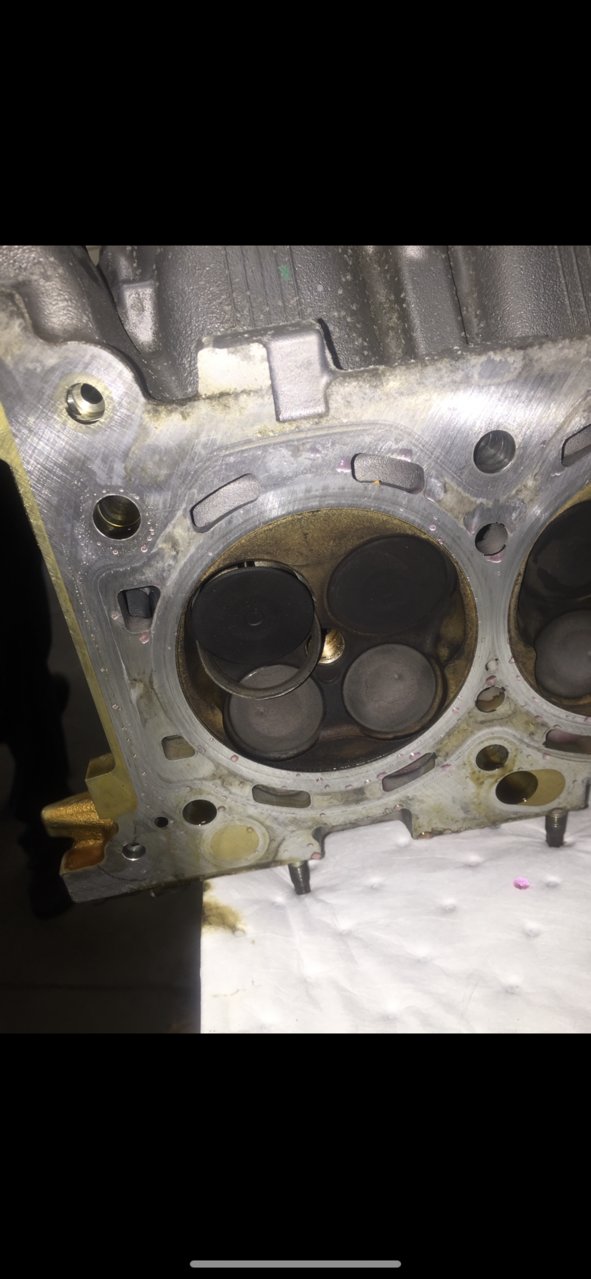

    That is so odd to see.

    Impressive failure. I've seen these pop out on moto heads, usually after overheating.
    Those combustion chambers are narsty, what's your AFRs in/out of boost?

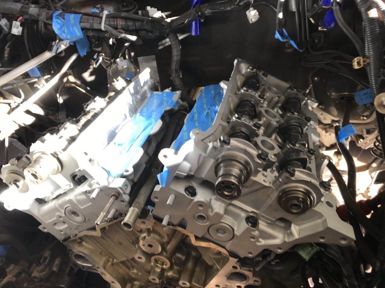

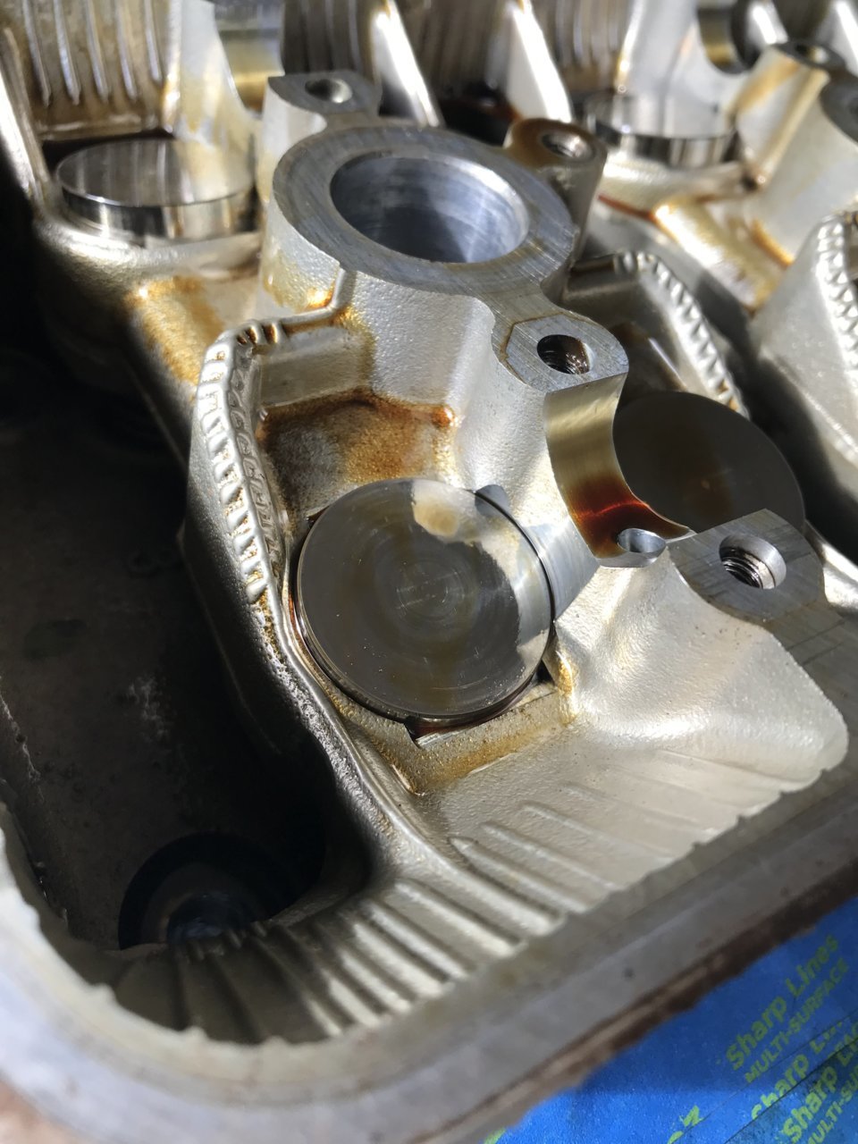

    Amo-cat3
    Amo-cat3 [OP] Wizard Sleeve Master
    Jan 26, 2009
    #12980
    655
    Maui, Hawaii
    07 TRD Blown dubcab
    TRD Supercharged 4.0 w/ 2.5" Quick change Pulley, UCON EMS, URD 7th injector, AFE Stage II intake, DT Longtubes, MBRP 2.5" dual exhaust w/ Vibrant Ultra resonator, URD Y-pipe w/ vibrant v-bands (Cat free), Walboro 255 fuel pump, SS Oil catch can, Aeroforce gauges, Icon CDC 2.5 coilover set at 3", 1.5" Wleelers Progressive aal, Light racing uca, 17x8.5 Fuel Anza 4.5" backspace/-6 mm offset, Kelly Safari a/t 265/70/17, scanguage 2, AMP electric steps, bed extender, Low-pro tonneau cover, 20% tinted windows/headlights/taillights, tacoma seat covers, Image dynamic sound system w/ Pinoneer avh3200 head, assrtd stickers................
    Since my compression numbers were good for all the other cylinders I decided to go ahead and get some remanufactured heads sent to me without having to send my old heads back for cores. As of right now I have engine about 90% back together just waiting for some supercharger parts (intercooler foam seal and lid oring), once those arrive I just need to intstall radiator, belts, and refill coolant and oil and should be ready to start her up by the end of the week. 14 year old truck, we'll see how many more years I get out of it - it is now officially my project vehicle.
    lifter.jpg here's a pic of the top of the dropped valve - no damage to note up top.
    nwhd2.jpg Pic of new heads

    Not wasting any time! Where'd you get the heads?

  20. Aug 11, 2021 at 7:33 PM
