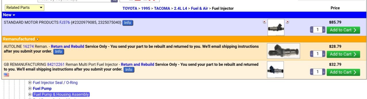

  17. Jul 22, 2021 at 6:36 PM
    #17
    mech160
    mech160 [OP] Well-Known Member
    Oct 22, 2011
    #65675
    58
    50th
    1995.5 Tacoma
    This is whats offered on Rockauto (see attached photo). What would you all suggest? For milage on the vehicle, I have a hard time justifying $85 ea. Do you all have any experience with these brands?
    Thanks guys!
  18. Jul 22, 2021 at 6:38 PM
    #18
    mech160
    Oct 22, 2011
    #65675
    58
    50th
    1995.5 Tacoma
    Disregard, just noticed I gotta send my parts in to be serviced. No since on sending counterfeit parts
