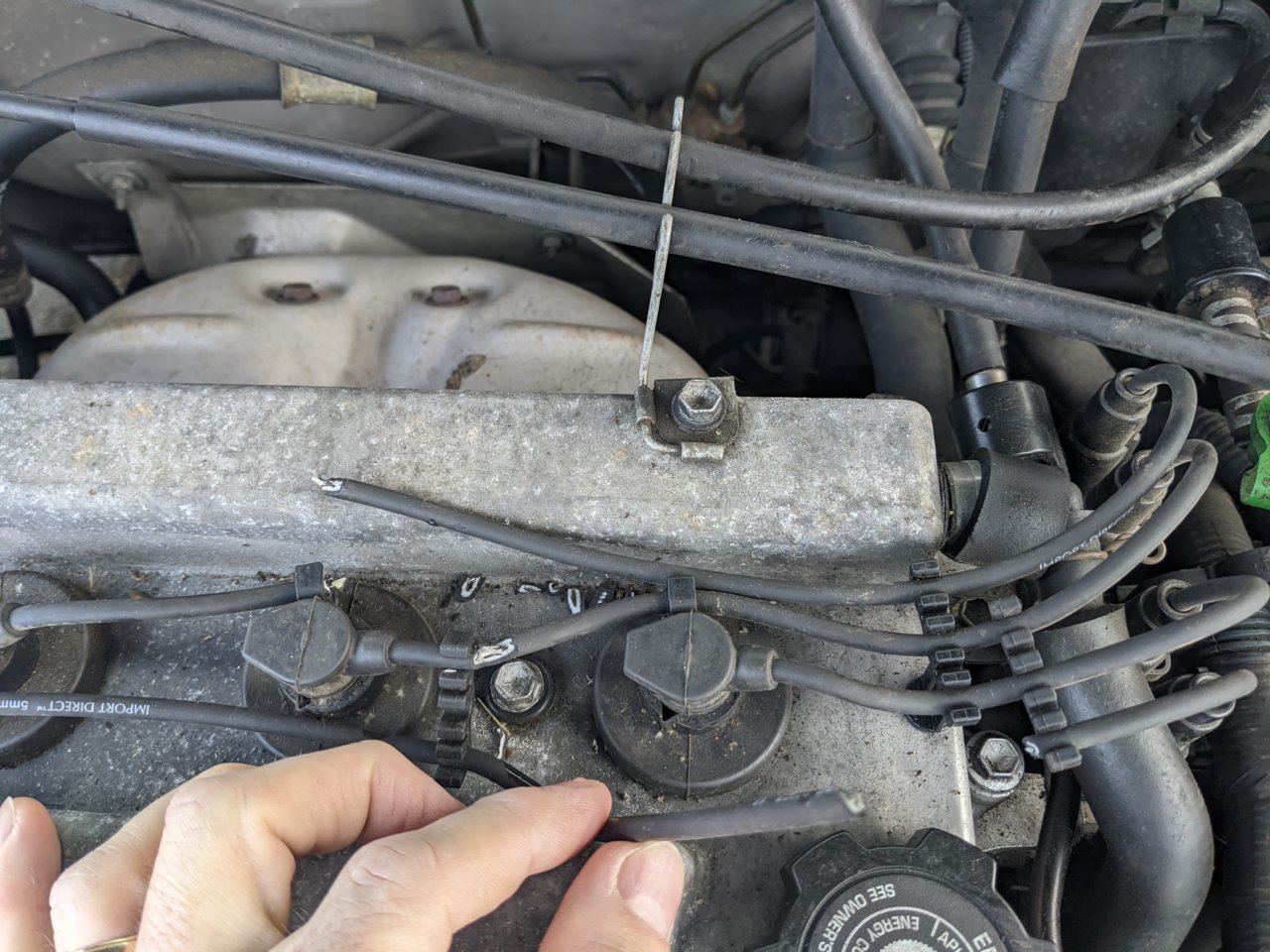

    On a side note I went out a few weeks ago to move my 1999 Corolla to the other side of the street. Case if too many vehicles and not enough driveway, causes the local parking enforcement to get nosey. Anyways the car that ALWAYS starts, just cranked and an cranked and spit and cranked. After nearly killing the battery trying to start it, it smelled of raw fuel.
    Pulled the battery and put it on the charger in the garage. Then it snowed 8" on the damn thing before I could get back to it. Snow melted, so I got back to it.
    Gave the engine bay a quick once over and then plugged in my OBDII reader to see if there were any codes. No codes, but while cranking in live data mode, I did see that the RPMs were being indicated. This tells me that the crank sensor is good and not the issue.
    Ran out of time that day to fiddle any further. Got back to it a few days later.
    This time upon opening the hood, I just happened to look in the right place immediately.
    F'n rodents!!!!
    Three out of the four spark plug wires chewed to hell. Explains why it sputtered while cranking, the silly car was trying to start with one cylinder.
    Easy fix, all is good now.
