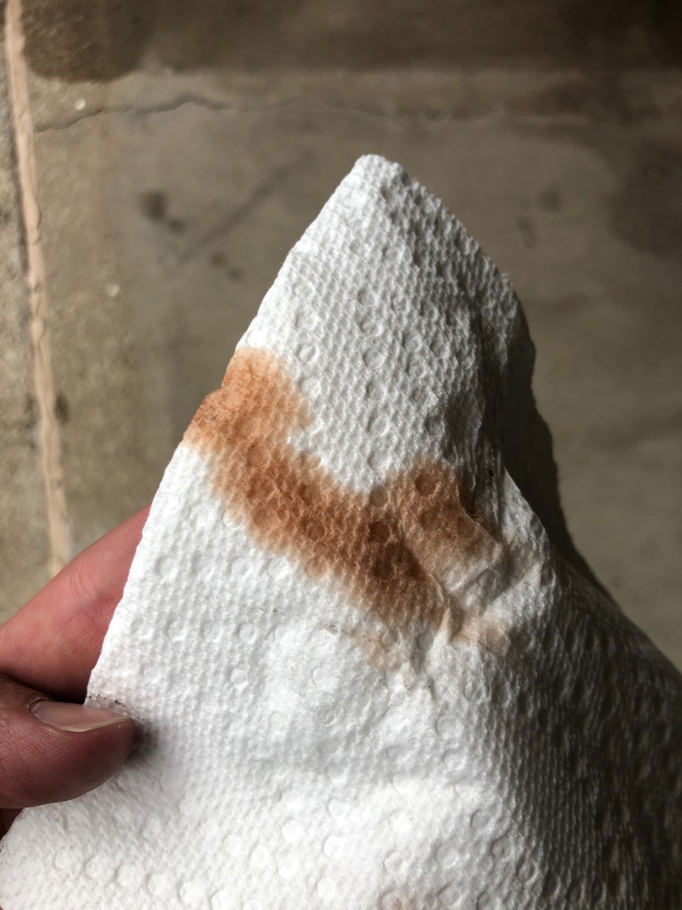

    UPDATE: My mechanic started by pulling out all the spark plugs and noticed that they were very worn and plug #3 had black scoring on it. He replaced all six plugs and now it runs like new again. I'm very happy that solved the issue. Now I suppose the next thing to tackle is the transmission... Here's a picture of what the fluid looks like. It's not the best lighting, but in person it looks almost rust colored. I think this is because of the fluid I added to top it off mixing with the old stuff because before I added anything it looked like engine oil. It seems like the majority of you suggest a simple change and not a flush so I think that's my next move, but I'm also a proponent of "if it ain't broke don't fix it." Thanks for all of the advice!IMG-2832.jpg

    Fluid changes are normal maintenance, the 'if it ain't broke don't fix it' doesn't apply there...not changing the fluid is going to shorten its lifespan. Would be like not changing the differential oil because it runs fine, eventually it's going to crap out on you earlier than it normally would have.
    I'm talking about a drain and fill, not a flush...you are correct about not flushing it, but a drain and fill with ATF won't hurt anything and will likely help it.
