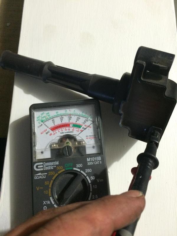

    I drove it to work yesterday because it was running fine. Then on the way home, the CEL came one again. This time I pulled the code, cylinder 1 was misfiring. By the time I got home, it threw two new codes. Cylinder 6, and running lean. So.... two cylinders, not on the same coil misfiring?
    I just replaced all the spark plugs and there was nothing noticeably wrong with the old ones. I checked the coil resistance. They are Toyota 90919-02212 coils. The secondary resistance is about 10 ohms, but on all three coils, the primary is zero. Like I said, I'm new to this world, but I think I'm doing it correctly.
    I don't see how it is possible for all three to be shorted though...
