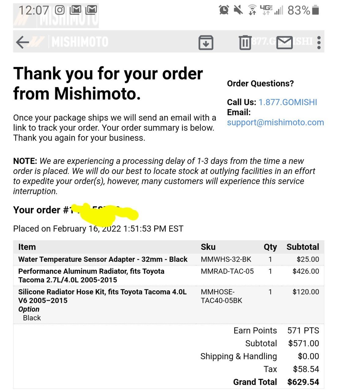

    Ordered one this morning for my 2nd gen.. Can't beat this price, especially with free shipping!!
    WishUcan[OP] likes this.

    Installing a temp probe for a mechanical coolant temperature gauge.
    Skydvrr[QUOTED] likes this.

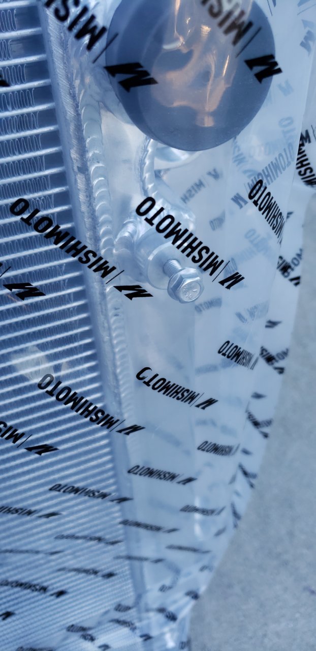

    Included new fasteners is a nice touch..
    Radiator Cap seems ok..
    Drain plug has a nice seal and has a magnetic pickup for catching any metal debris..bitchin!!!
