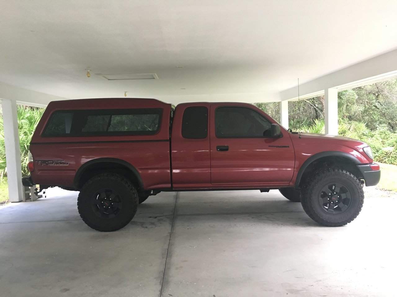

    I can throw in a picture of my 1st gen with a regular cab cap on on an extended cab.
    It is pretty much exactly the same with first gens. The regular cab cap will fit on an extended cab, but not really the other way around.

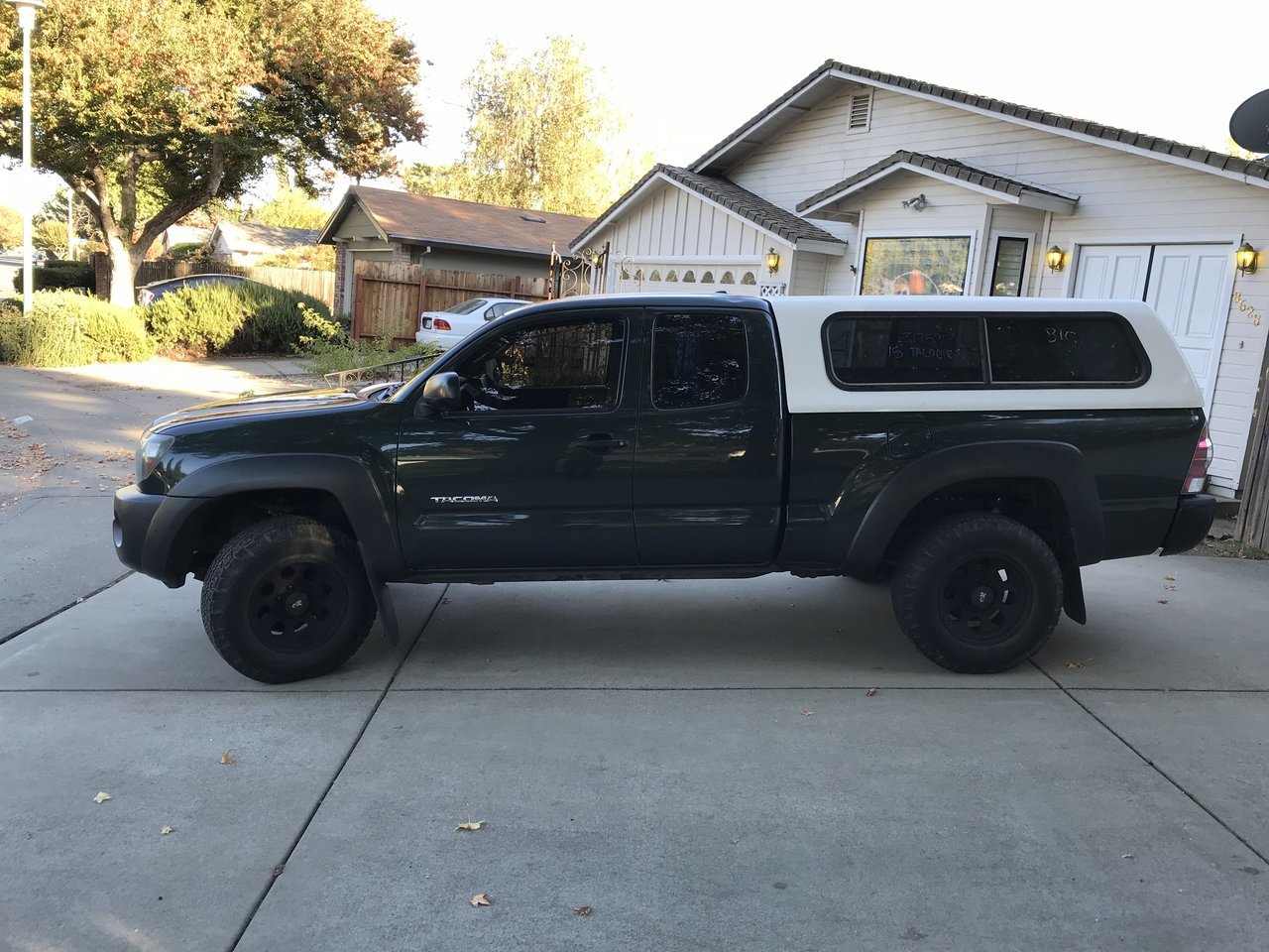

    I may have tweaked a few things...
    Here is a picture of my 2nd gen Access Cab with a Pro Tops cap taken from a 2nd gen DCLB. I know this config is the least questionable but just so there is a clear answer available, access cab and DCLB are exact matches. Pro Tops also confirmed for me that AC and DC fit caps are from the same mold so as long as the DC is long bed they are interchangeable.
